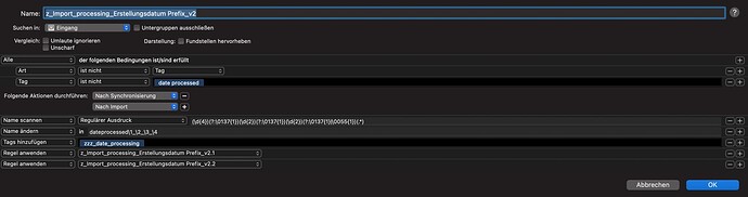

My current Approach looks like this but doesn’t work as intended
I told you already that you have to use regular expressions to achieve what you want. And the rule I posted should only those files matching the pattern, ie not already in the desired format.
There’s, I believe, no point in trying to match the name with something like ![…] but I’m repressing myself.
As soon as you can describe your pattern clearly and unambiguously, let me know. I can then try to figure out an expression to match.

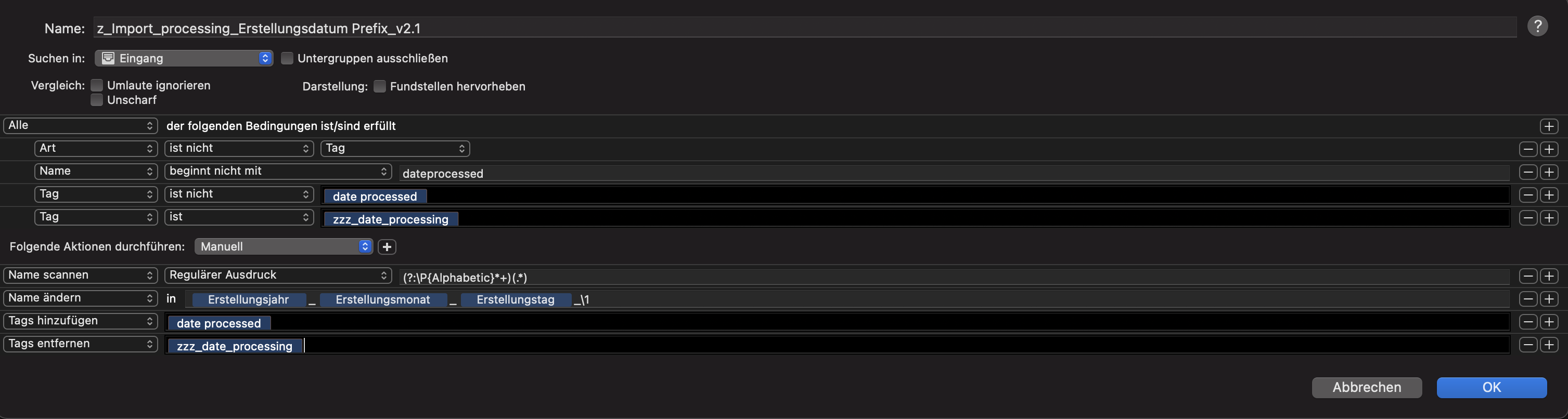

I found this solution which is not perfect, since it cannot differentiate between YYYY_MM_DD_Name and YYYY-MM-DD-Name and since doesn’t touch both files. But the YYYY-MM-DD-Name version should preferably be changed to YYYY_MM_DD_Name
My partial achievement looks like this:
If you have the mood to show me a better solution I would be happy to learn

What I’d do: Remove the second selection criteria. Simply change all file names to the format you want and then move them to a group. As soon as they are out of the inbox, you don’t have to worry about them anymore. Alternatively, set a tag like “processed” or whatever after you change the name and add “tag is not processed” to the conditions.
As an aside: I’d go about this very differently. Instead of looking at the file name as it arrives in the inbox, I look at the content of the document (possibly after OCRing) and determine the file name from there. I wrote about that here recently (look for “Hazel”). And then I move the file were it belongs. This, of course, is only sensible if one receives similar documents regularly – and that’s the whole point of automation. No use if I get an invoice from someone once a year, because scripting or otherwise automating that takes more time than simply changing the data by hand.
Yes that is correct I’ve now modified my rule inspired by your idea of simply processing everything.
I’ve split it now into 3 rules that run after each other. I guess it is not the most sophisticated solution but for now it it does what I want.
