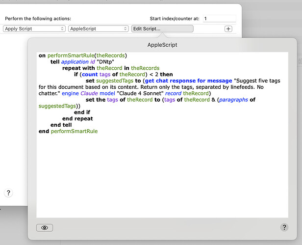

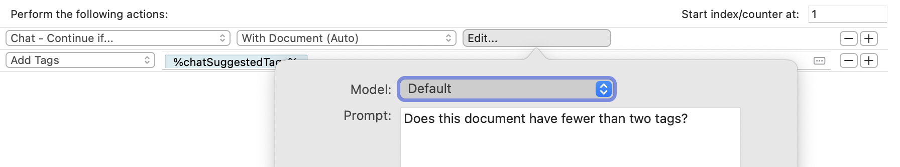

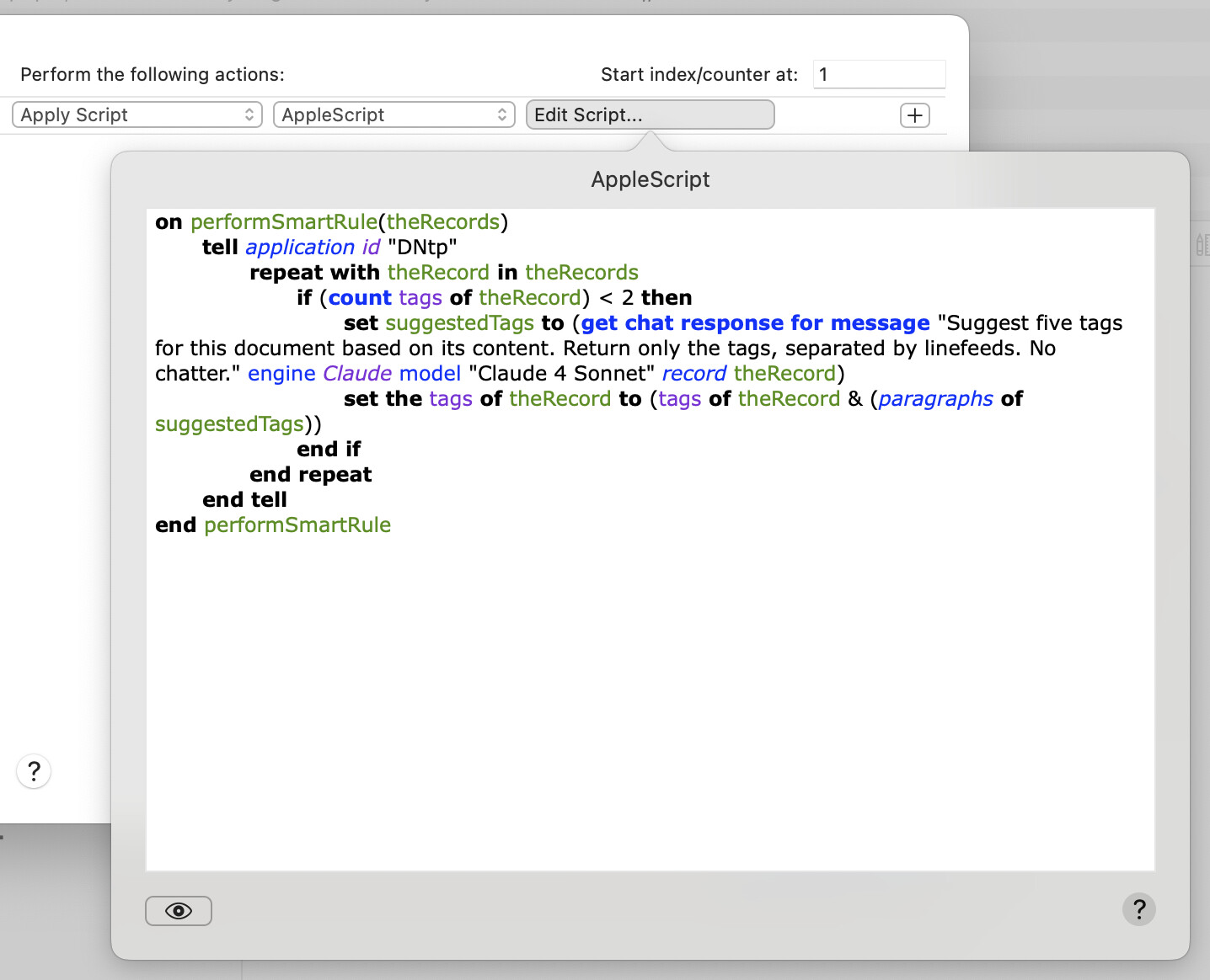

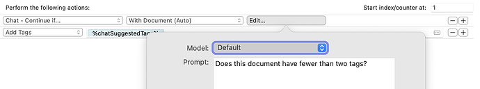

Item has two tags? No. This would require scripting or potentially using a Chat - Continue if smart action.
While I don’t think this is the best use of AI, this is possible though the tags are at the LLM’s discretion…
Here’s an example with an Apply Script action…
Thanks, that will help. Yeah, I agree that this is right now not completely helpful. Since DT also searches in the text, an AI agent generating tags from the text is offering no additional info.
My thinking is I want the AI to only suggest existing tags, and then check those before completing the task (and having the tags added). I will try to set this up today and see how it goes.
