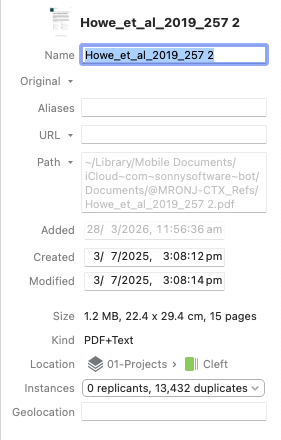

What I thought would be a quick tidy up session on DT4 has expanded ~ with the finding of two files with hundreds/ thousands of duplicates and I’d appreciate the Forums thoughts as to cause.
Using DT4, folder indexed to iCloud - the files are not duplicated on iCloud
Syncing set up some time ago, iCloud + Bonjour - working fine
I’ve been working on a synced MBP and this was a return to base iMac - but the duplicates are also on the MBP

Screenshot 2026-04-04 at 8.22.26 am

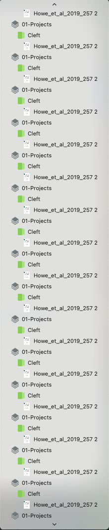

Screenshot 2026-04-04 at 8.23.04 am

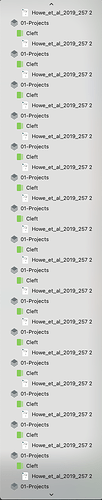

Screenshot 2026-04-04 at 8.25.42 am
Since duplicates in DT must be in different groups, a first step might be to figure out what happened to your group/folder structure.
Your Settings > Sync > Conflicts in DEVONthink is likely set to Duplicate documents.
Sync not set to Duplicate Conflict on any device
Looking through the folder structure now
Bug reported
