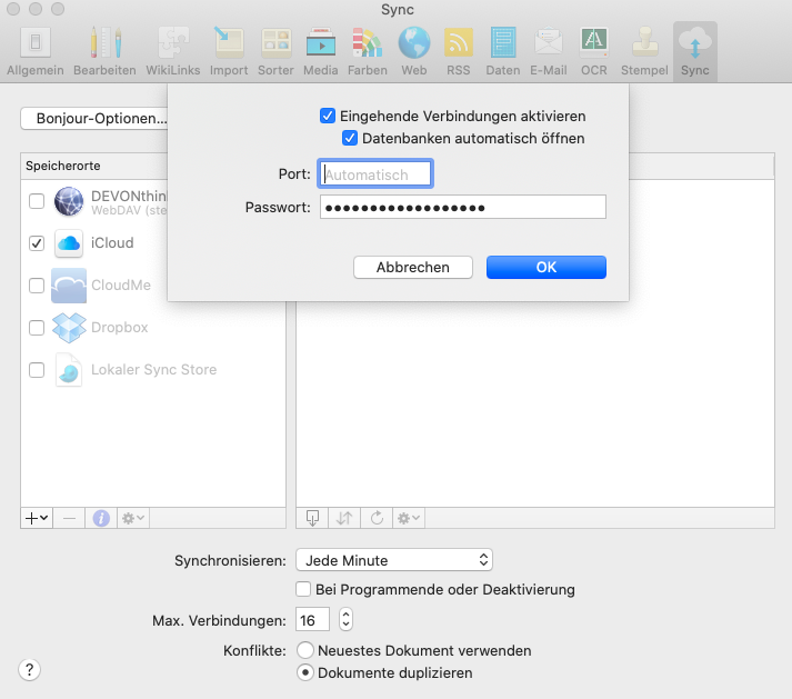

i don’t think im seeing up a local sync store. i have followed (or tried to follow :)) @BLUEFROG 1:1
to make it clear this is what i do:
on the mac i only configured the bonjour settings:
(as you can see no local sync is checked)
on the iPad i do the following:
so when i enable the location i get this same error
did i screw something in the process?

Good to now see the relevant screen shots. Sorry, network stuff above my pay-grade.

to add more details here its the pref section of the firewall, which as far as i can tell is off
