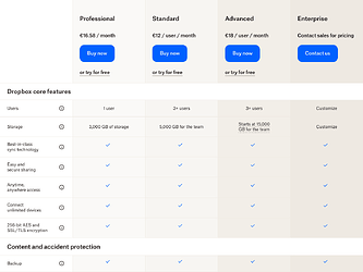

I haven’t really looked into Dropbox Backup, so I thought it was a totally separate service with its own subscription. But you’re right: looks like it’s just included with all their plans. If you have 3TB to blow that seems like a no-brainer.
Of course check out the technical details of how it works, as you say.
(From: Dropbox for business: Compare plans - Dropbox)
