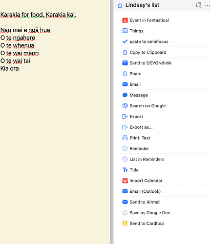

I’m using drafts at present, to grab ideas, as a grab all inbox, then sort. I can tag there for my zettlekazen.
Is there a connection to Devonthink?
I use Devonthink (Mac) and DTTG (IOS) “at present, to grab ideas, as a grab all inbox, then sort. I can tag there for my zettlekazen”
Yes, in drafts you have a side folder that enables you to flick it to DT with unclick.
