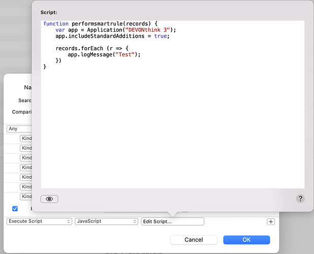

@cgrunenberg I’ve checked this a bit further, but the problem persists with normal triggers (e.g. Before Synchronization) even with this simple example (internal) JXA script:
	var app = Application("DEVONthink 3");
	records.forEach (r => {
		app.logMessage("Test");
I have also checked this on a different machine with 3.8.6 installed and the exact same thing happens with this test script when triggered by any other trigger than On Demand. Also - this does not happen when triggering an (internal) AppleScript, it happens only with JXA. The timeout does not happen when using the script on demand.

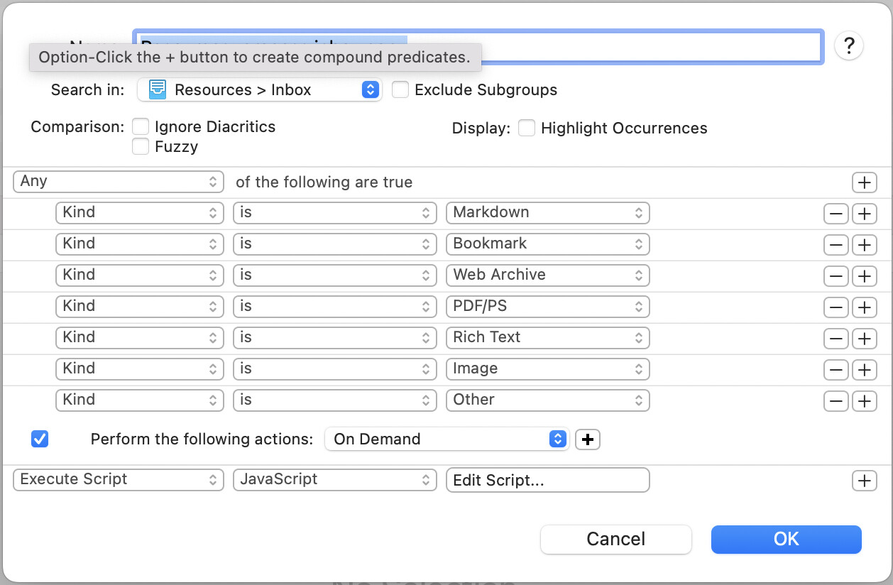

And how many items does the rule process? A screenshot of the conditions would be useful.
Just tried this using a smart rule which is performed every minute, no timeouts after several minutes and the script was executed every minute.

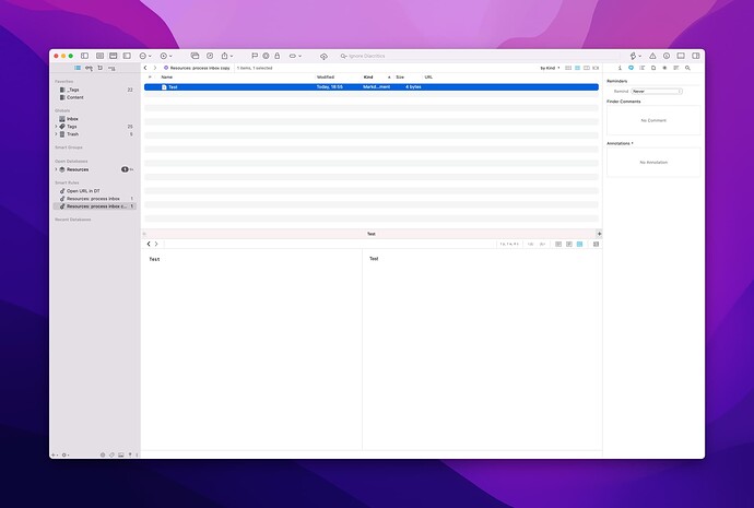

Tested this with one Markdown document with just the contents “Test”
Tried exactly the same and it consistently times out. I’ve removed all other Smart Rules to be sure there’s no interference from other rules…
