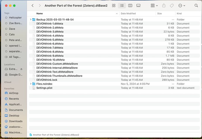

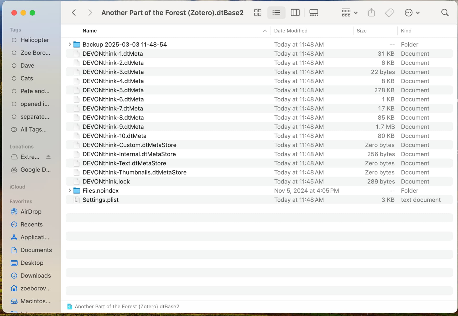

I am having trouble archiving/database files that include the custom metadata. Here are screenshots of an example of exporting a database that has custom metada. When I unzip the archive file (on another drive) the custom metadata file is zero. Am i not archiving/exporting properly? Or is there something else going on?
Source:
![Screenshot 2025-03-03 at 11.53.50 AM|690x424] (upload://dsURARH3133vIsK9BgEgbuTNK5a.jpeg)
Archived version:
Thank you for your help! --zoe

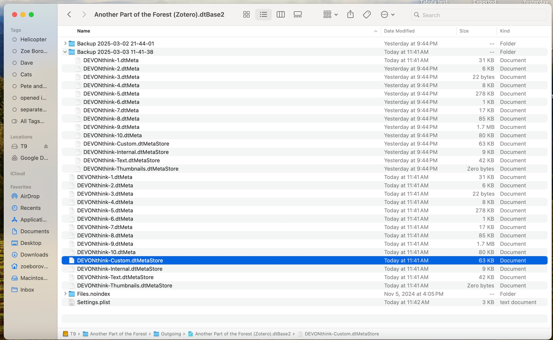

The above message has the image of the archived version with zero custom metadata. Here is the source file.

But now, upon further testing, it looks like dragging and dropping the file from one external drive to the other actually does a better job of including the custom metadata. That surprised me but it does explain some of our previous problems!

This is an issue of File > Export > Database Archive…, the upcoming version 3.9.9 will fix this. In the meantime one workaround is to compress the database on your own while DEVONthink is not running or the database is not opened.
