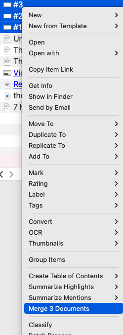

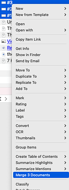

How to stitch notes together? Context: while reading an article I add sentences to dt3, how to make #2 then #3 add to the same note? Notes app does it.
copy/paste
If separate notes are used, they can be merged afterwards
Thanks for pointing this out. Never noticed this option.
Another option is to use the Take Rich Note service first and then the Append Rich Note service to append notes to the last taken note.
I’m not able to find the " Append Rich Note service". Could you share the path or instructions?
Thanks in advance
Is the service enabled in System Preferences > Keyboard > Shortcuts > Services?
Yes it was enabled already. But I don’t see it in the dropdown after selecting 2 Rich Text notes. Merge is offered.
The services are available in the Services menu of other applications and not meant for merging already existing notes but to take new ones & append to them.
Ok. Got it. Thanks again.
