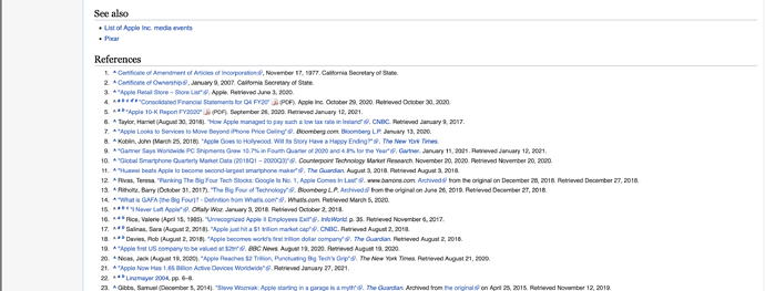

Today I just discovered some wikipedia pages I’ve saved in one-page pdf format are incomplete. So apparently the bug would potentially break PDF (one page) clipper for many sites as far as I’d say it’s unreliable to use in its current state. (Maybe WebKit is to blame, but I don’t know.)
Here’s an example clipping Apple Inc. - Wikipedia.
If you compare the original link opened in DT’s browser (NOT in external safari) and the clipped pdf, you can see they are almost identical except for the “References” section, where the three-column layout was stripped to single-column layout, resulting in page cut at the bottom of the page.
At the start of References section in original page, a 3-column layout:
At the start of the clipped one-page pdf, a single-column layout:

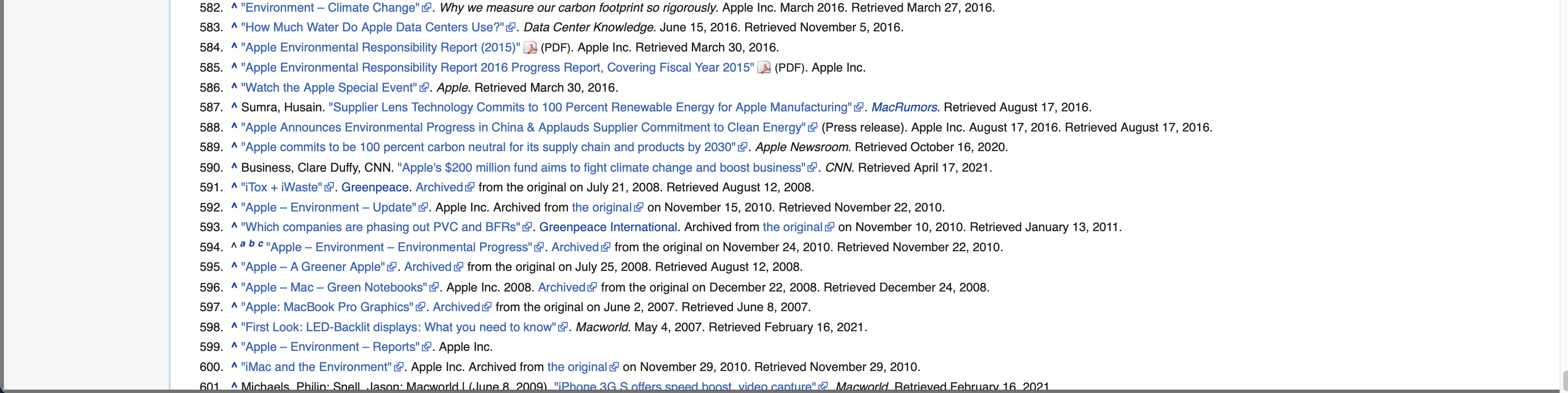

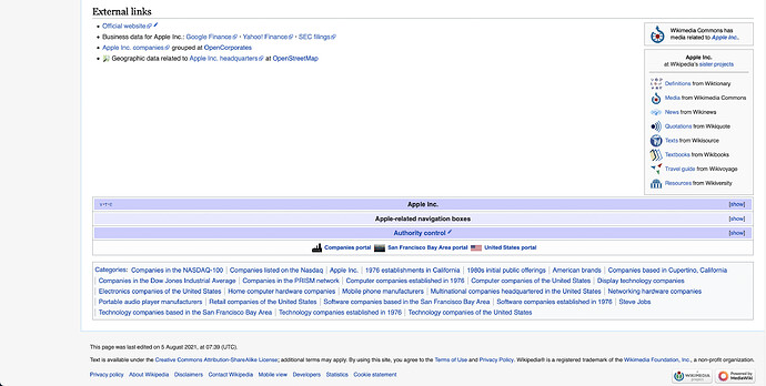

At the bottom of the original complete page:
At the bottom of the clipped incomplete one-page pdf:
Thanks for the feedback but it’s still the same WebKit issue unfortunately.
Just realized a workaround could be to firstly narrow down the DT browser window so that multi-column layout would automatically reduce to single-column layout then clip to pdf. As I tested it, this way the clipped page was complete.
Edit: Sometimes the layout won’t reduce to single-column no matter what. But the WebKit-clipped page always uses single-column layout. Apple must be a master for creating bugs, that’s why it’s called bugOS…
