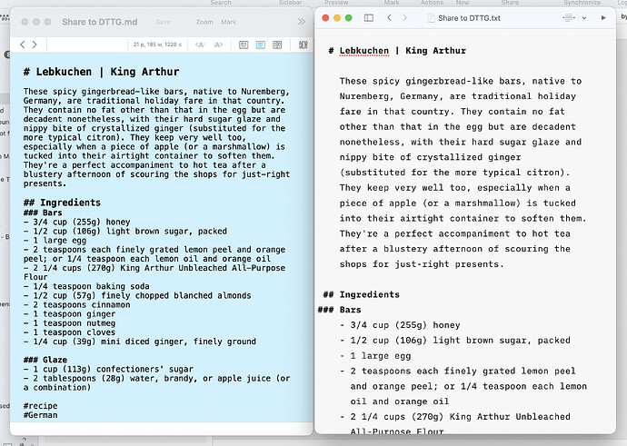

That being said, iaWriter on mobile supports the file provider mechanism so you can open a Markdown document in a DEVONthink To Go database via the Share sheet or within iaWriter’s Library > From Other Apps.
Development would have to assess the feasibility of such changes. However, I do see how a bit of air would be good in dense text passages…
But again, remember iaWriter (like Ulysses, Typora, etc.) is a bespoke Markdown app. That’s its one trick, it’s raison d’être. So obviously it will have functions and features specific to writing. :slight_smile:
Thanks for listening! (Yes, on iPad my routine is to open DTTG, select MD file and open it via share sheet into iA Writer.)

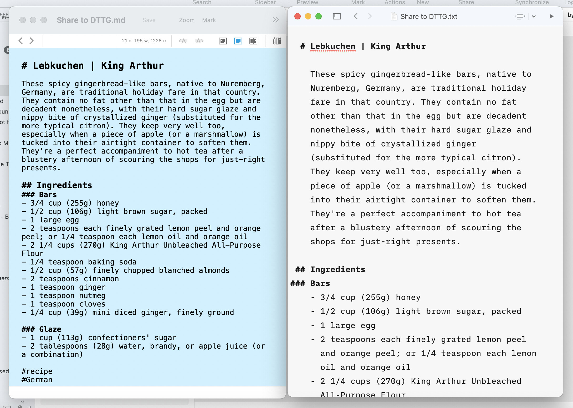

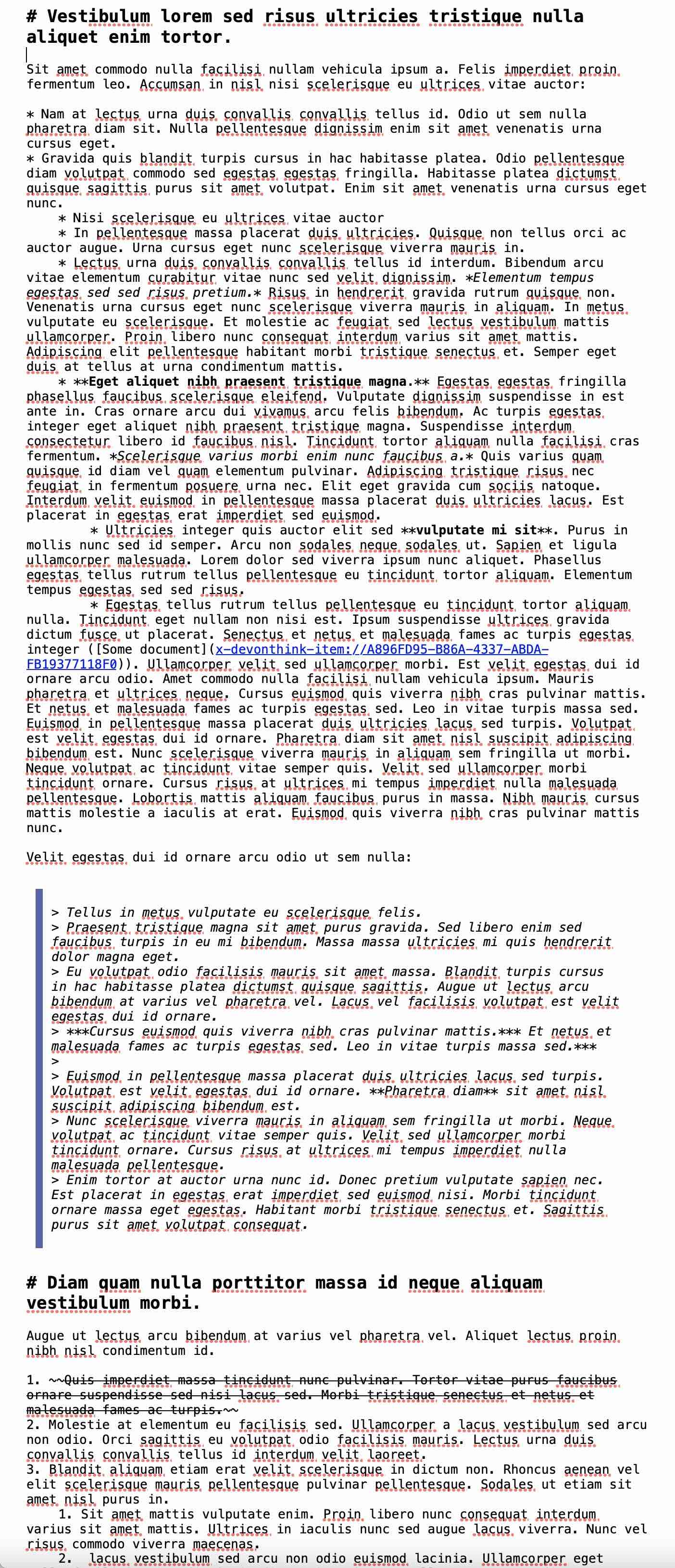

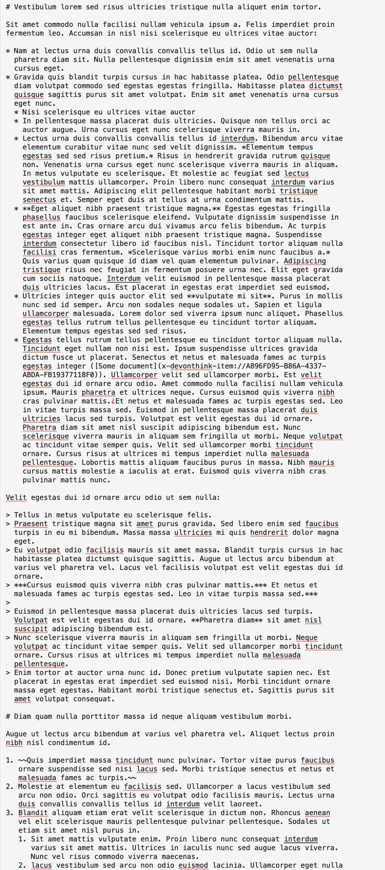

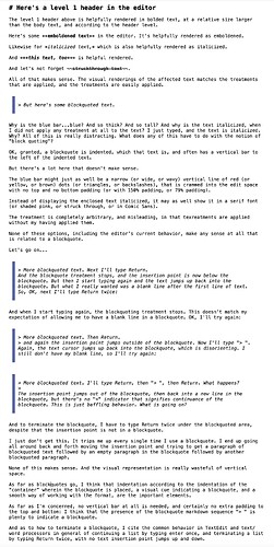

For me, I wish that the cognitive dissonance that I experience in two very common scenarios could be ameliorated:
  1. The current implementation of lists creates a visual mess (a form of “visual effect”) in documents of any complexity, because there’s no hanging indentation of items.
  2. Why is blockquoted text styled with a thick blue left border and in italics? Simple indentation, relying on the "> " markdown as the visual cue of a blockquoted passage, would suffice, but again, with the hanging indentation consistent with the first line; that is to say that hanging indentation to be set at the point after the leading "> " in the first line. And the obtrusive blue border serves no purpose other than to distract, and the italics styling serve the purpose of … what is the purpose of this? Is it supposed to be quasi-WYSISYG? (which would of course depend on the CSS in effect for rendering the text…I am casting about for reasons). Whatever the reason, it makes me ask What the purpose of this? every time I look at it. And the visual editing behavior of typing Return causing the block quote to break and necessitate typing “>” to re-initiate, causing another spasm as the view updates, leaves a lot to be desired. This is especially distracting when editing within a blockquoted passage. (A smoother experience would be, when typing Return, for block quoting to continue, and be canceled upon typing Return twice.)
And, the editor is partially WYSIWYG-enabled in that struck through text is rendered as struck through. And emboldened text as emboldened, italicized…header text…except when included in a blockquote…inconsistencies, which, along with the exceptions noted above, induces more cognitive dissonance.

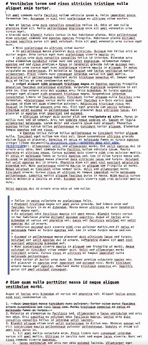

See the images (“as-is” and “suggested”) as illustration. These “visual effects” break flow and induce frustration. Simply because I have trouble reading what I’ve written. Yes, I could purchase some other editor, and go through gyrations to use it in concert with DEVONthink, but I have an editor, and I’d like it to be more accommodating, and for flow to be preserved, aided by not having to switch applications to edit text.
Of course, I could use RTF…except that RTF is not fully supported in DTTG (despite valiant efforts by the DEVON devs; Apple apparently is not cooperative with upkeep.) Or plain text, but there’s no formatting available for plain text (the point of plain text is to be plain, of course). Formatted Notes do not support lists, and the proposal that I write and maintain HTML is to me simply ludicrous.
This leaves…Markdown. Which I use, and wrestle with, every day.
(PS: would the DEVON team please consider my suggestions above as enhancement requests? (Please don’t take my mockup literally, but only as a mockup/illustration of concepts.) Thank you, and thank you for the great product that DEVONthink is.)

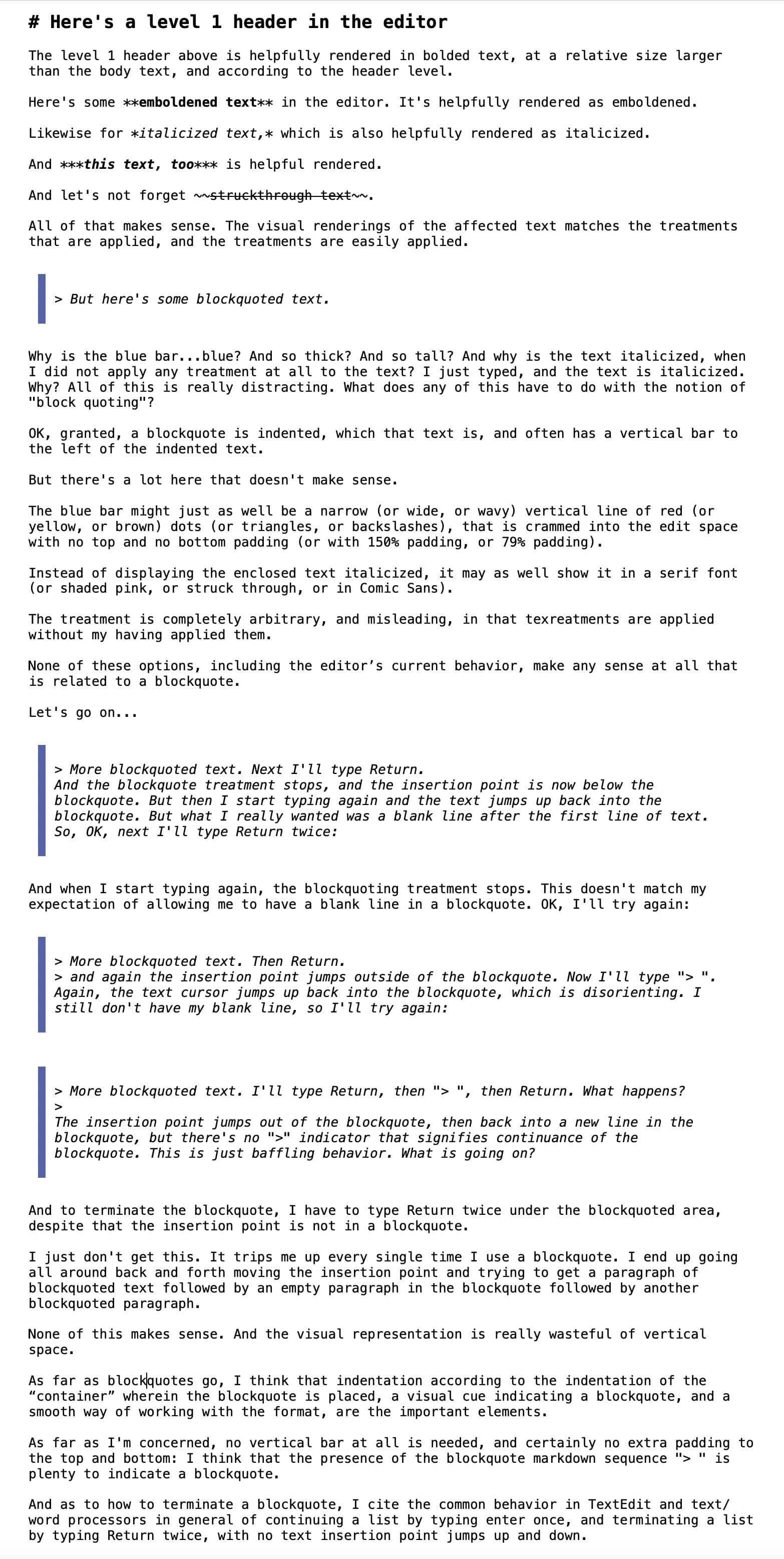

But, the editor displays blockquoted text in a way that makes no sense. Instead of a thick blue border at the left that takes up far more vertical space than the enclosed text, the editor may just as well show a narrow (or wide, or wavy) vertical line of red (or yellow, or brown) dots (or triangles, or backslashes), that is crammed into the edit space with no top and no bottom padding (or with 150% padding, or 79% padding). Instead of displaying the enclosed text italicized, it may as well show it in a serif font (or shaded pink, or struck through, or in Comic Sans). None of these options, including the editor’s current behavior, make any sense at all that is related to a blockquote.
(OK, then what affordances make sense for a blockquote? Indentation according to the indentation of the “container” wherein the blockquote is placed, a visual cue indicating a blockquote, and a smooth way of working with the format. None of which, in my experience, exist today, in adequate forms.)
And the lack of hanging indents in lists just creates a visual mess that has as the only affordance one indented line and an asterisk (or dash, depending on what you like to use; or a number), per list item. This text more resembles mistakes made during editing, than conveying the ordered sense that lists implicitly lend. A hanging indent is an affordance that brings legibility, order, and context to these lists in the editor.

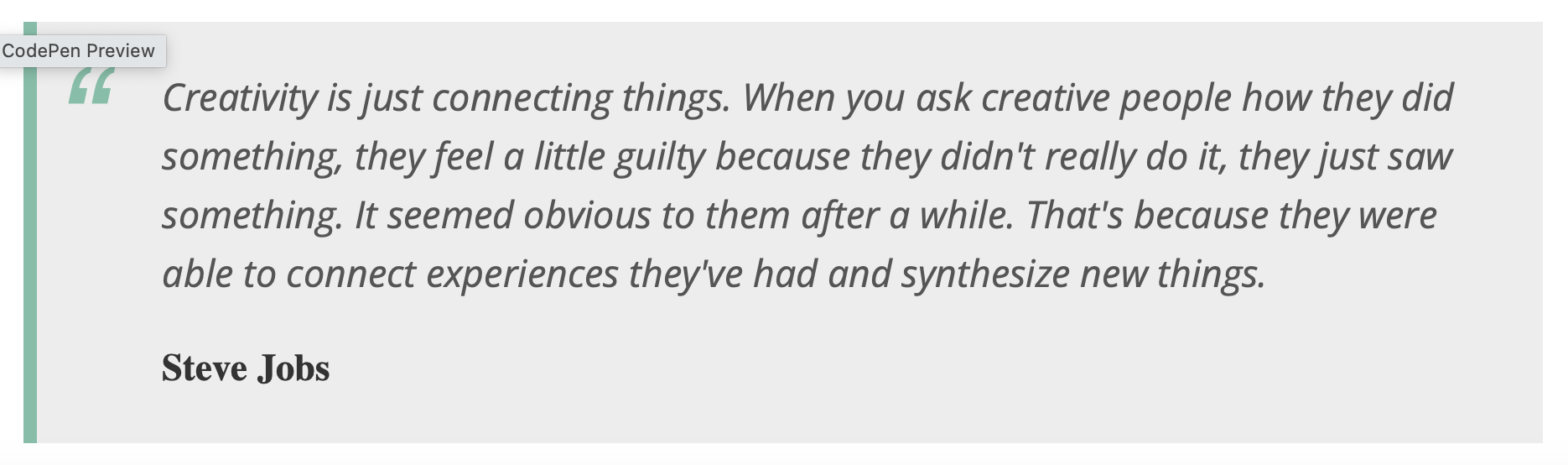

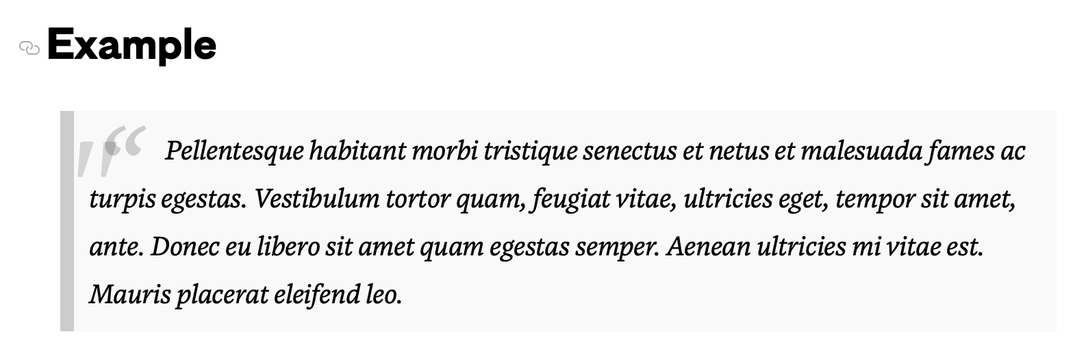

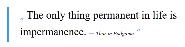

I’m not sure where you’re getting this idea. Blockquote something in this thread and what do you see rendered?…
Also, search for blockquote css and you see a ton of examples showing this specific styling.
…etc. So it seems pretty logical to have it applied in WYSIWYG styling as its supposed to mimic the rendered view to some degree.

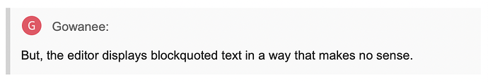

I don’t understand your reply. You seem to be referring to the rendered view of markdown? I’m referring to the behavior of the editor. Maybe the attached screenshot / narrative will help illustrate the difficulties I’m having. You refer to CSS: is there some CSS that I’m not aware of that controls how things appear in the editor? Thanks.
No. I am referring to the WYSIWYG view of the source. You said it didn’t make sense why it appears the way it does. I showed the reasons why it appears that way.
