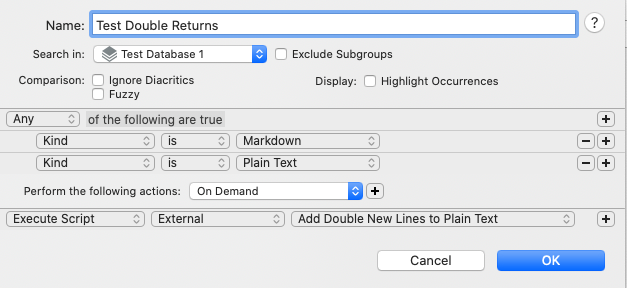

Regarding the Smart Rule method,
this is the warning I get:
with best regards, Omar KN, Stockholm, Sweden
Your script doesn’t do anything, it just cancels. The Smart Rule must execute my first script. The script must be saved in the Smart Rules script folder under a name of your choice.
The conditions would be if kind is either Markdown or Plain Text.
Double Returns
If the script is saved and a Smart Rule set up that executes it apply it by right-click on a file you want to add the extra returns to and chose “Apply Smart Rules” and the script.
And please be careful and only test with test data or duplicates. You seem not to be very familiar with Smart Rules either, that might cause damage to your data.
