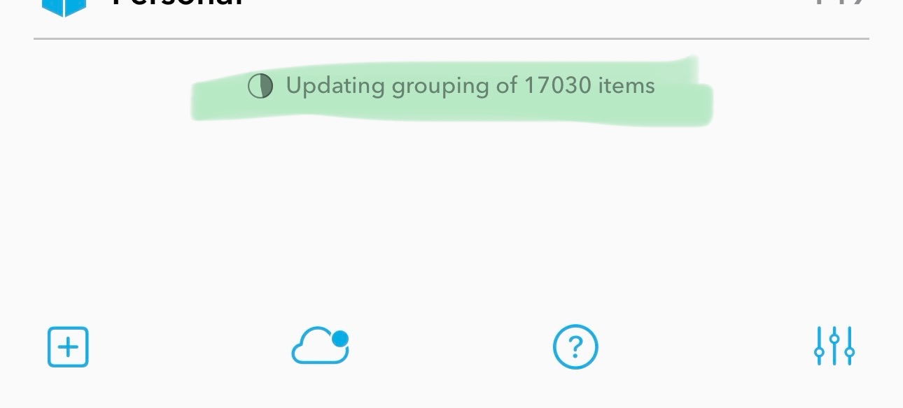

3384 items left to be uploaded notification
Every time I open DTTG on my phone, I see a little triangle on the cloud icon at the bottom with the message, “3384 items left to be uploaded”.
I’ve tried using smart groups to look for ghosts or other empty files on my phone, but I can’t seem to find anything. I haven’t noticed that I’m missing any files or anything either, so I’m not sure what is still needing to be uploaded.
I have left my phone on with the DTTG app open for long stretches of time as well, but don’t seem to see any upload process begin or anything similar to that. Is this a message I should just ignore for the time being until it goes away, or is this something I need to troubleshoot further?

Darn, I hate to say it but I’m seeing the notification again:
Any other ideas? Do I need to somehow manually download all those pending files locally to my iOS device then let them resync somehow?
