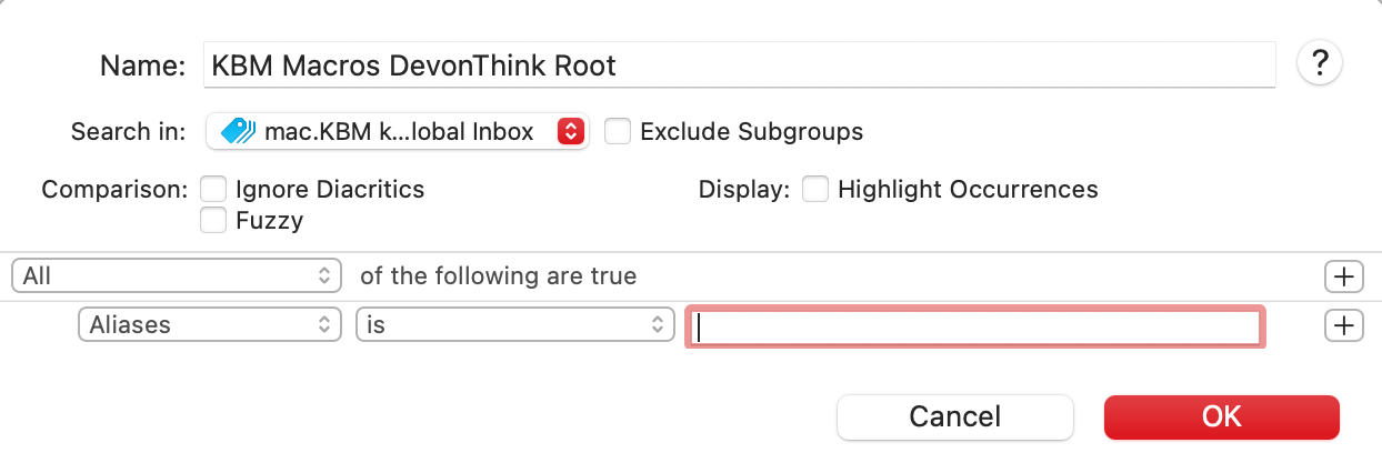

Ability to choose alias from a group specific drop down list
I am collecting my Keyboard Maestro macros in a DevonThink group with multiple subgroups.
I would like to be able to search
  • for an alias specific to that group
  • be able to choose the alias from a drop down list. I have trouble remembering them enough to type them in
I tried * but it did not work.
thanks in advance for your time and help
You can’t provide drop down lists for text fields in a smart group.
