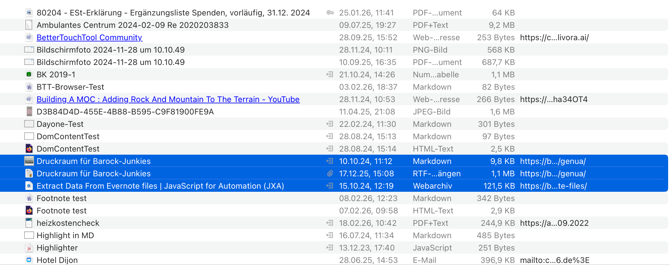

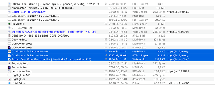

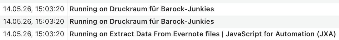

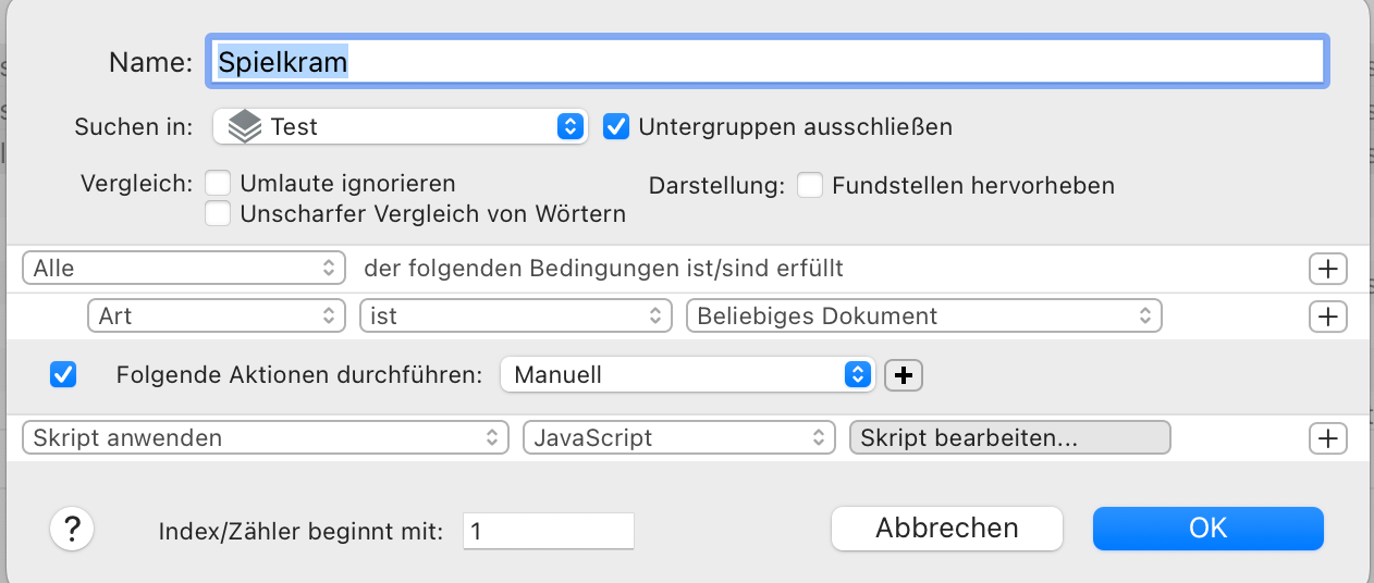

It works ok here (DT 4.2 on macOS 15.7.3). I select a bunch of records in the main window (“item list”) and then right click, “Execute smart rule” – the script in the rule handles the selected records. Then I right click on a non selected record, execute smart rule, and the script in the rule handles only the record under the mouse for which I opened the context menu.
Here’s the trivial script:

and the equally trivial rule
Output for the first case:
Output for the second case:
