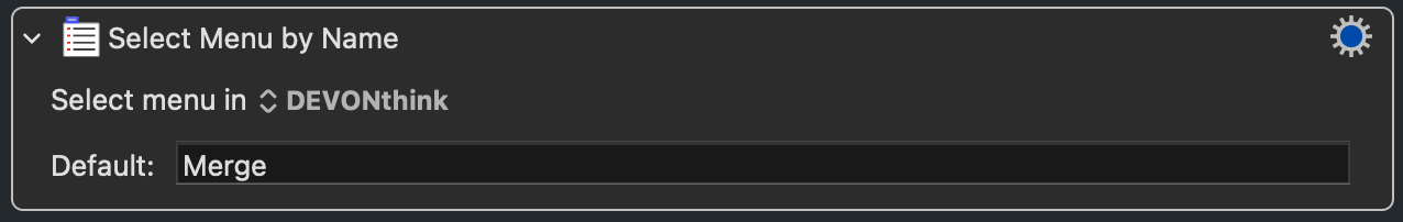

If you had either Better Touch Tool or Keyboard Maestro you would be able to select menu items using regular expressions. ??
Using Keyboard Maestro there is an option that gets you close.

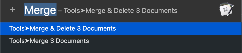

If you trigger this using a keyboard shortcut, I get the following prompt when I have 3 documents selected in DEVONthink.
You then have the option to select either the top or bottom entry.
