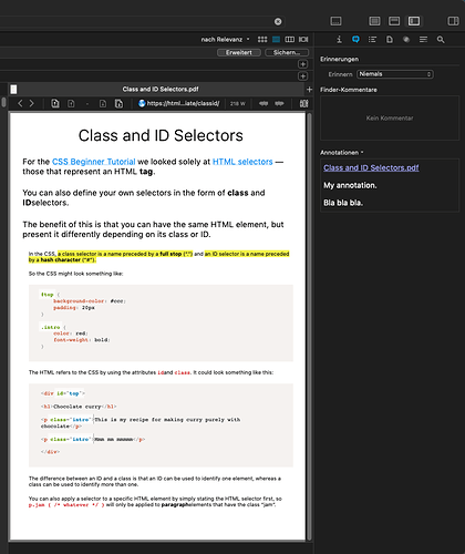

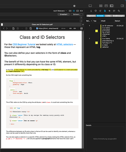

There are two kinds of “annotations” in DEVONthink:
  • PDF Annotations
    The ones that are written into the PDF document.
  • Annotation files
    Either Markdown or RTF.
    By default these are blank (but you can set up annotation templates).
    This type of annotation is linked to the annotated record.
If you open the Annotation via the Inspector you get a standalone document window

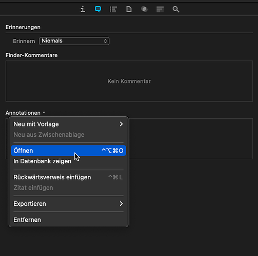

Open the annotation via the Inspector’s contextual menu:

In your screen shot example, you appear to be choosing “Open” from the contextual menu…this menu choice is dimmed for me; I suppose because I’m trying to create a new annotation rather than edit an existing one.

You can’t open a non-existent annotation file.
The default template is just that, the default built into DEVONthink. If you want to add your own template, choose Open Annotations Folder and add it there.
