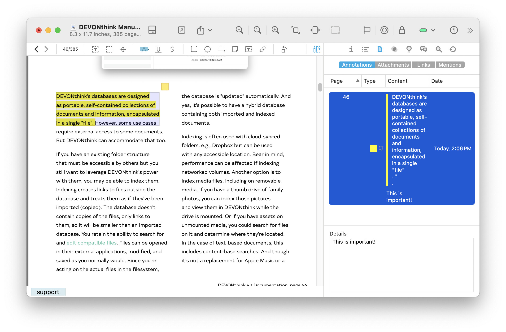

If you add a note to a Highlight annotation, the text appears under the highlighted text in the Document > Annotations inspector. It also appears in the Details section at the bottom of the inspector.

Starting the note isn’t the issue. I’m able to highlight and add a note. What wasn’t clear was how to complete and submit the note. Clicking outside the note while still using highlight button worked.

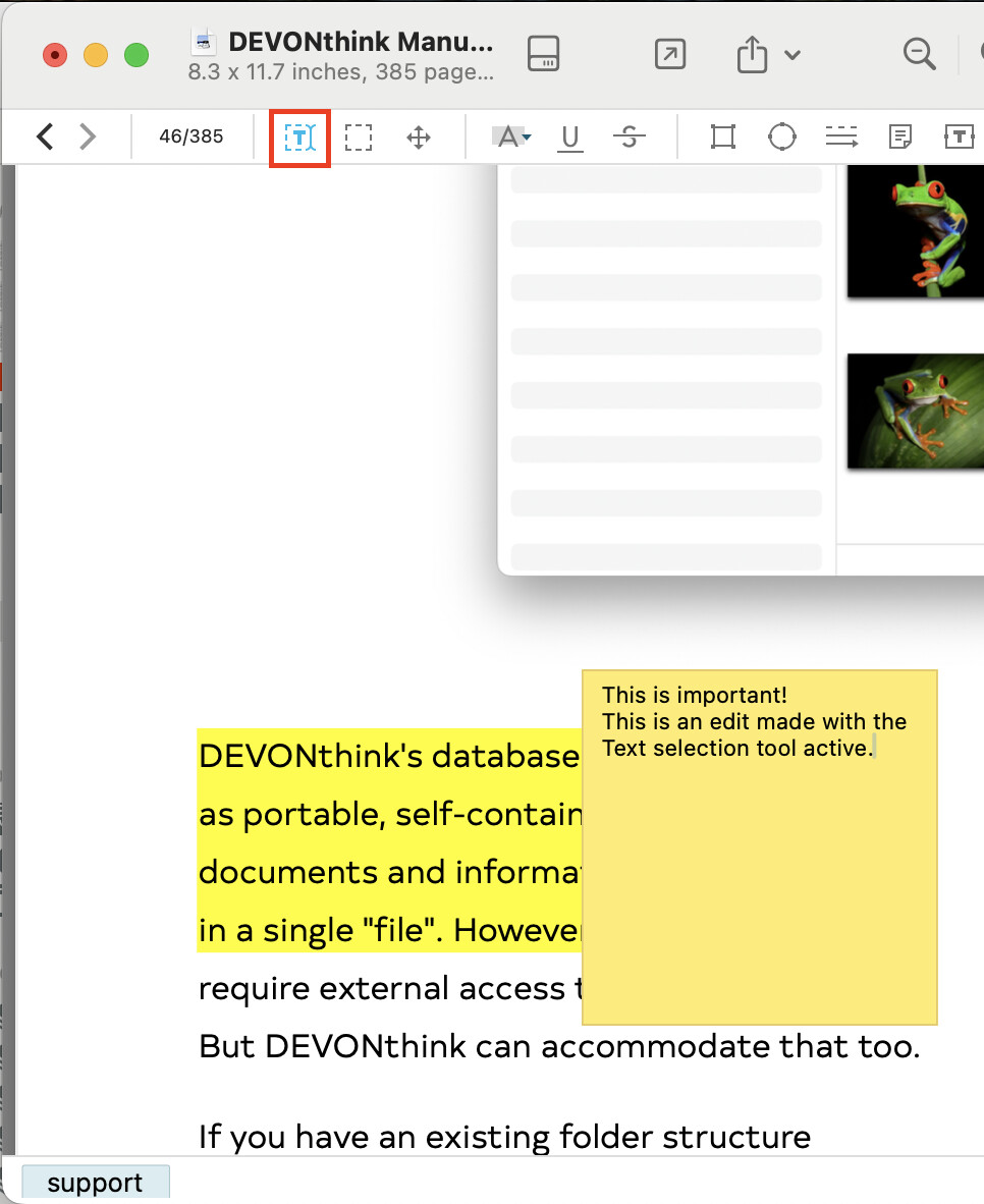

With Tools > Mode > Text Selection active…
With Tools > Mode > Annotation Selection active…
Double-click an annotation to open the Annotations panel.
There is no submission. The note is saved when you deselect the annotation.
