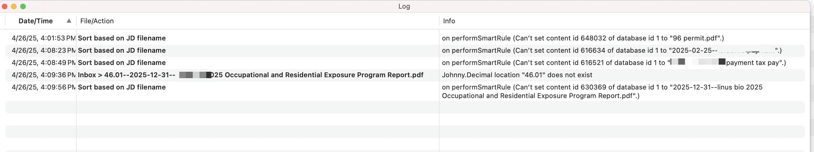

this seems to work well apart from 2 issues:
  1. i keept getting an error each time the script launches, though the file is indeed filed correctly. here is the error
  2. it seems that if launched manually, it only processes 1 file at a time? is that by design?

Hmm. I get no errors and can’t reproduce what you’re seeing. Looks like it’s the renaming that produces an error.
  • Just to be sure, did you change the JD_dir item link to the relevant location on your system?
  • Does DEVONthink have Full Disk Access?
  • Is the setting General > Appearance > Show filename extensions on or off? I had it on. Changing it doesn’t alter my result, but either way, the script should probably use name without extension instead of name. Does that make a difference?
  • What version of DEVONthink are you running this in? (I’m still using DT3, so I haven’t really looked at changes in the scripting dictionary of DT4.)
