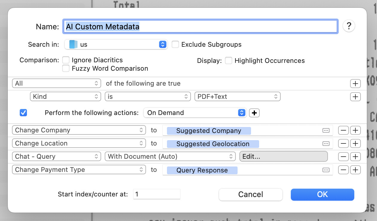

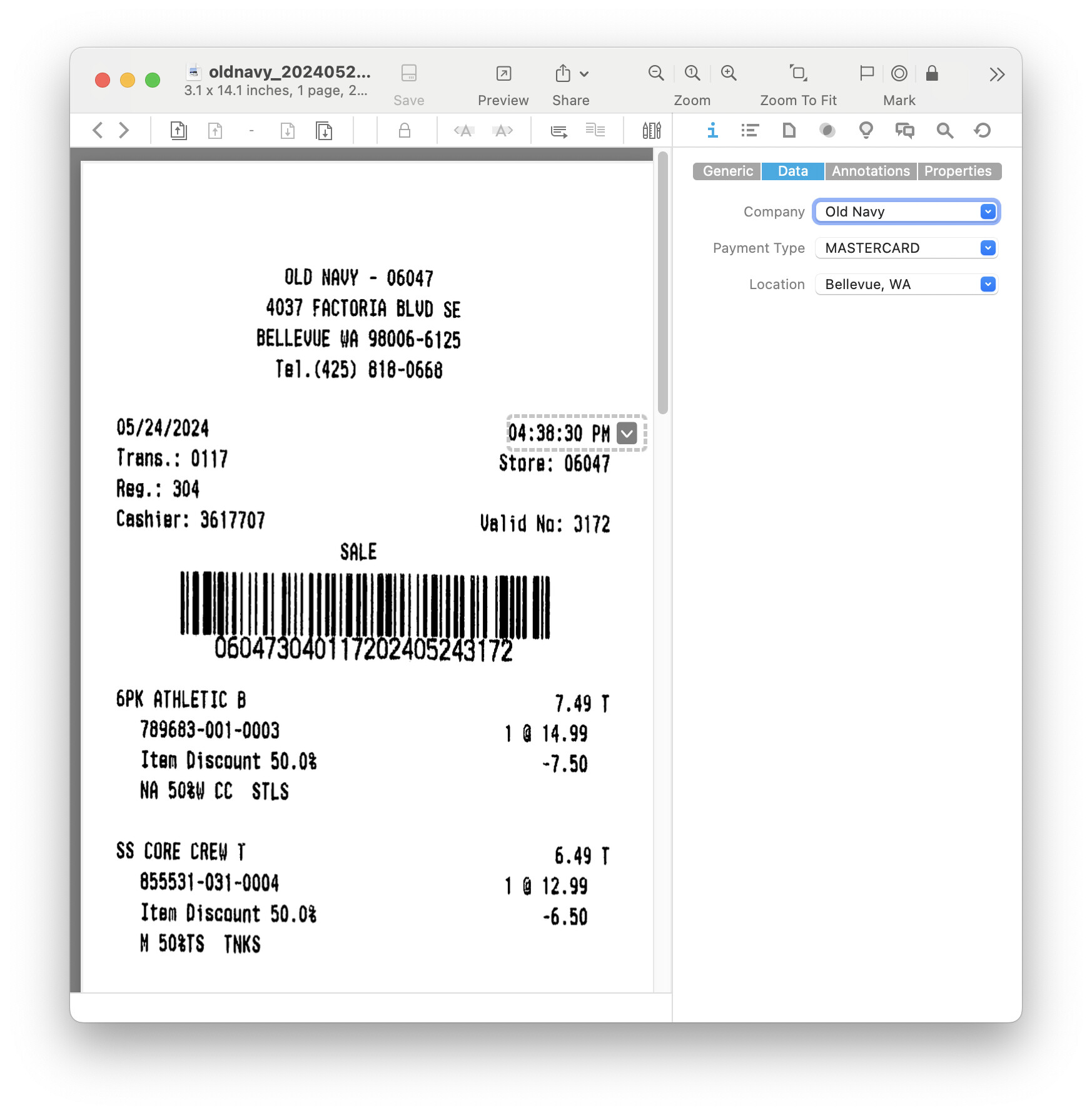

Here is an example…
… via…
Note the Suggested placeholders are from Chat Suggestions. These use the default Chat model you have chosen. They do their best to parse things but the results depend on the AI model’s capabilities. This was done with Claude 4.5 Sonnet. Haiku struggled to determine the location.
And the prompt to get the payment method since there isn’t a built-in Chat suggestion…
Examine the receipt or invoice and only return the simple method of payment, e.g., MasterCard, VISA, cash, etc. Return N/A if one is not found. No chatter.

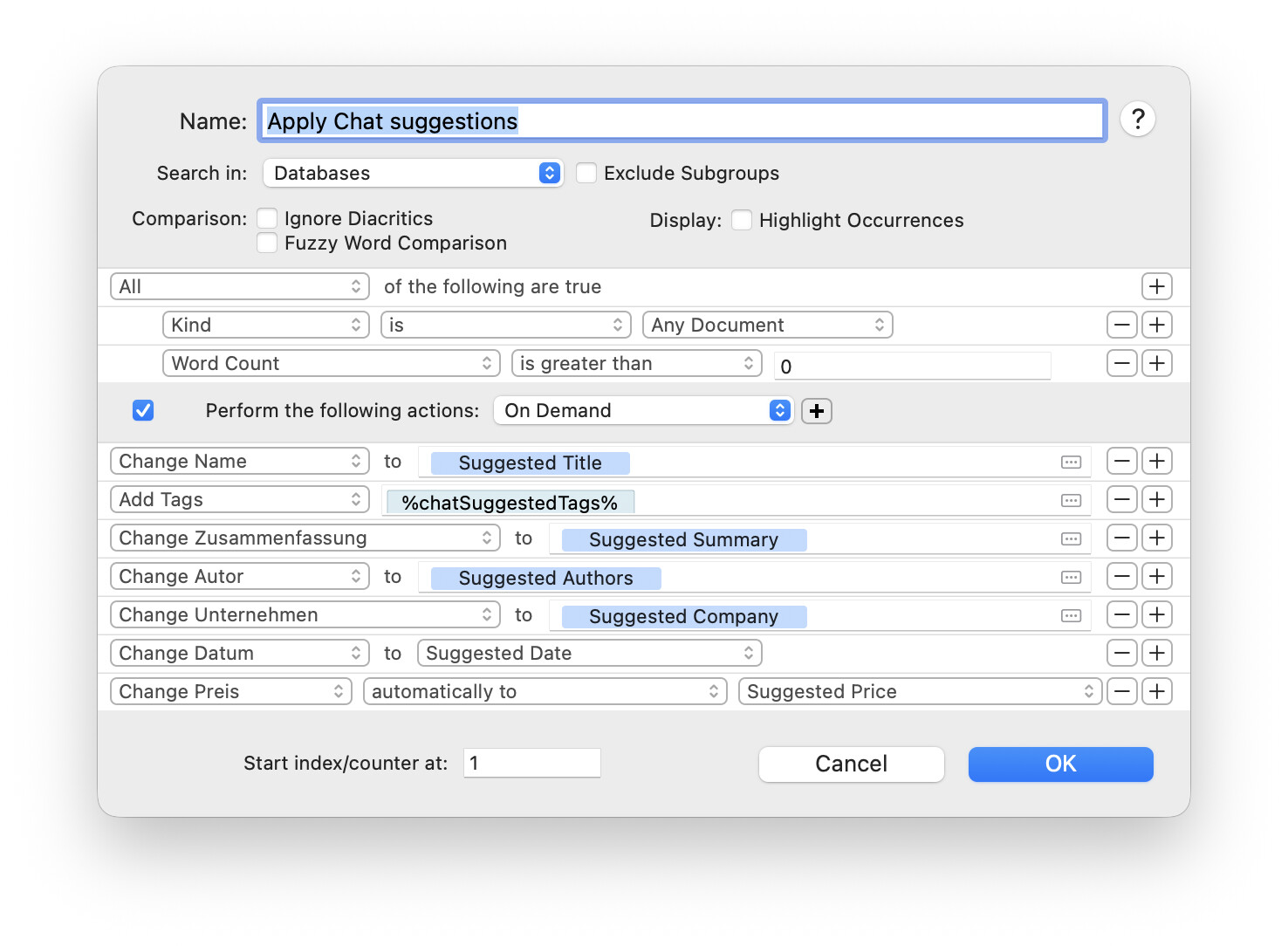

See also this default smart rule:
