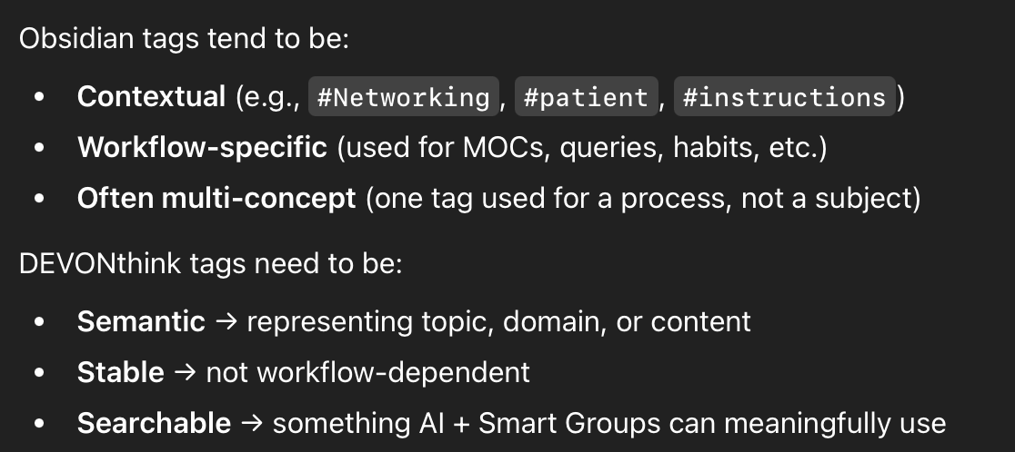

AI (Chatgtp) tells me that my Obsidian tags transferred to DT are often not informatiive.
My Obsidian tags were nested. The nest is broken into pieces. Many of the pieces are extraneous. Now I have too many tags. But, I cannot do anything about it because tags in DT are virtual. Anyway, most of my DT vault lacks good tags.

Sorry. Virtual is the word that AI used. It means that the tag file is not a normal file. You cannot make a folder to sequester excess tags. Ai says that too many tags is not helpful. So I wish I could make my tags fewer and more useful to AI.
The tags were nested and very functional in Obsidian. Now I transferred the notes to DT, and they look very lame to me. I do not see my nested tags. Only fragments.

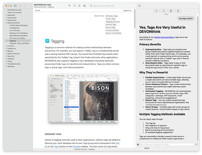

I tried out the DT icons on the left column. I see that they are very informative. There is an AI button. I seem to have signed up for Open AI. I would prefer to use Claude because I am rarely asking questions about the digital jungle. I wonder if I could use the Claude Sonnet 4.5 that I paid to understand my large project?

That is one of the reasons why development built the Help Assistant into DEVONthink’s help. It draws on DEVONthink focused information, curated for it, to increase the chances of returning more accurate replies.
For example…

Maybe they are still nested. I see a list of categories above a tag.

I see. My nested tags should be intact. I should be going to this obvious source of information first. Thank you. I seem to quickly get tired of reading digital information, like eating too much. So, I should take small portions in one meal.

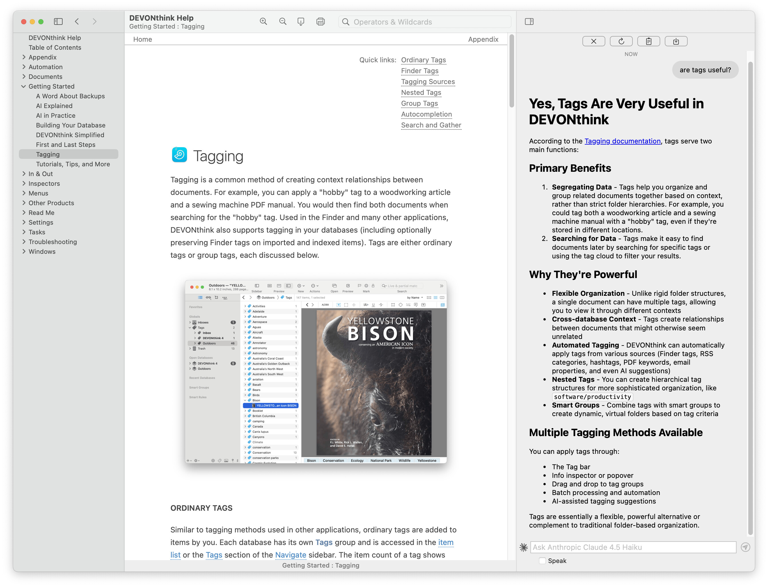

Tags have always fascinated me, particularly since when I first started using Devonthink I didn’t see the point.
Tags in Obsidian are keywords added to documents. Obsidian can search for tags as text. They are things that physically exist in the files, either in YAML or as text like #tagme.
Tags in Devonthink are groups. The difference between a group we call a group and a group we call a tag is in the meaning, and there are certain rules DT applies to the groups used for tagging.
A Devonthink tag isn’t something added to a file, a tag is a bucket where replicants or subtags can go. The act of tagging a document creates a replicant in the group we think of as a tag.
We now refer to them as “a reference” as people continued to be confused by our use of “replicant” re: tagging.
