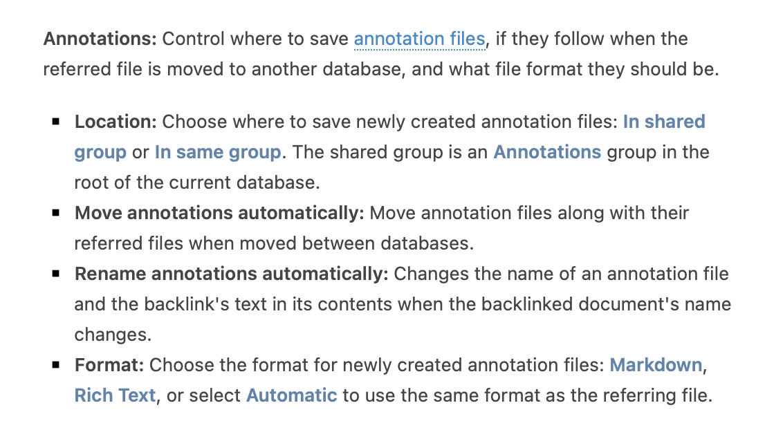

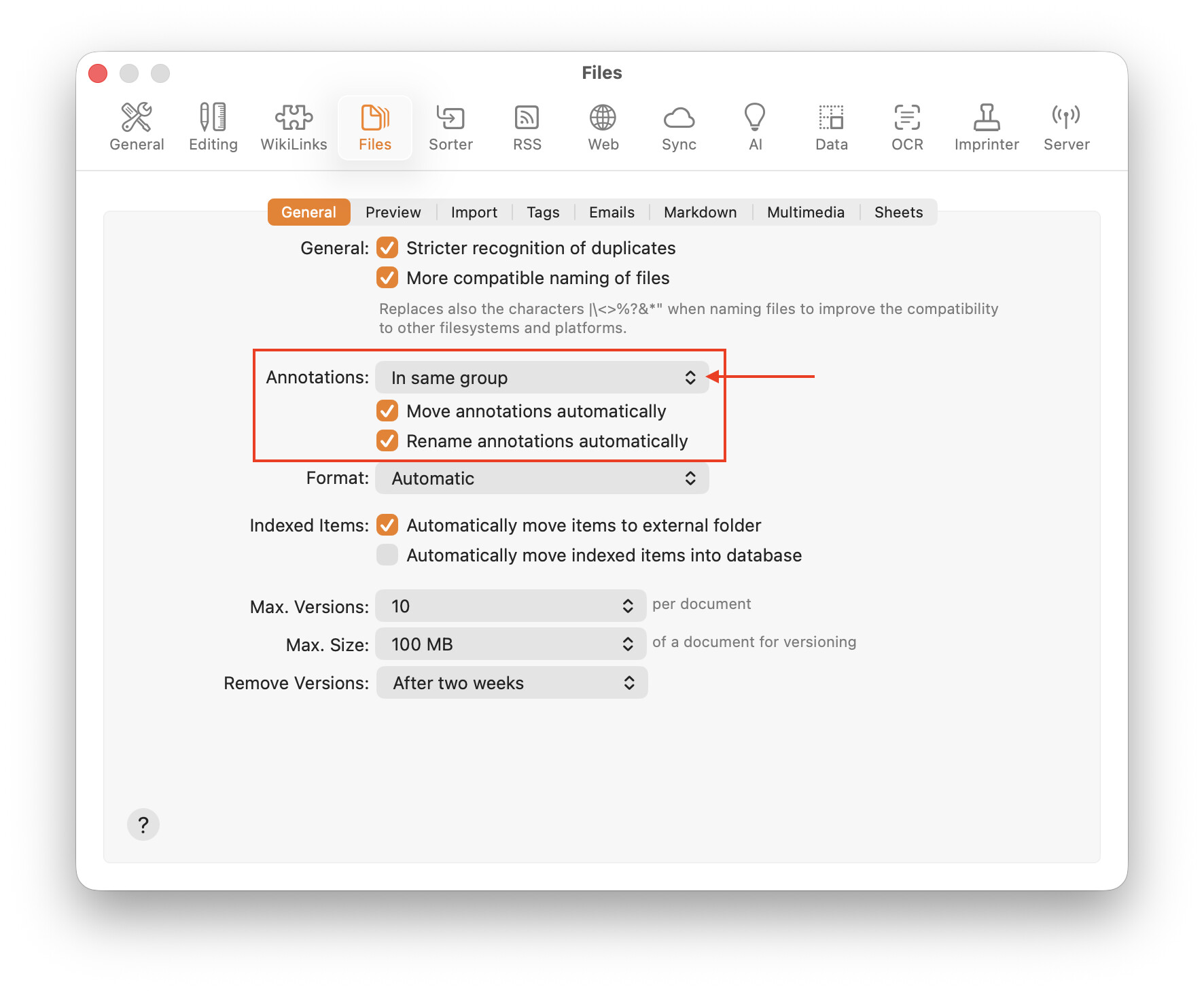

Also, see the Files > General settings regarding Annotation file behavior…
… and the documentation…
Bluefrog,
Thank you, as always, for your helpful response. In general settings, I had selected “Annotations: in same group” so I don’t need to change that. But I did not know the ramifications of selecting “Move annotations automatically” because I am still learning (and will probably always be on a learning curve!) DT. I’m going to experiment with the “Rename annotations automatically.” That seems to be a no-brainer but I want to see what happens after I check that box and change the name of the backlinked file to burn this feature into my poor tired brain.
