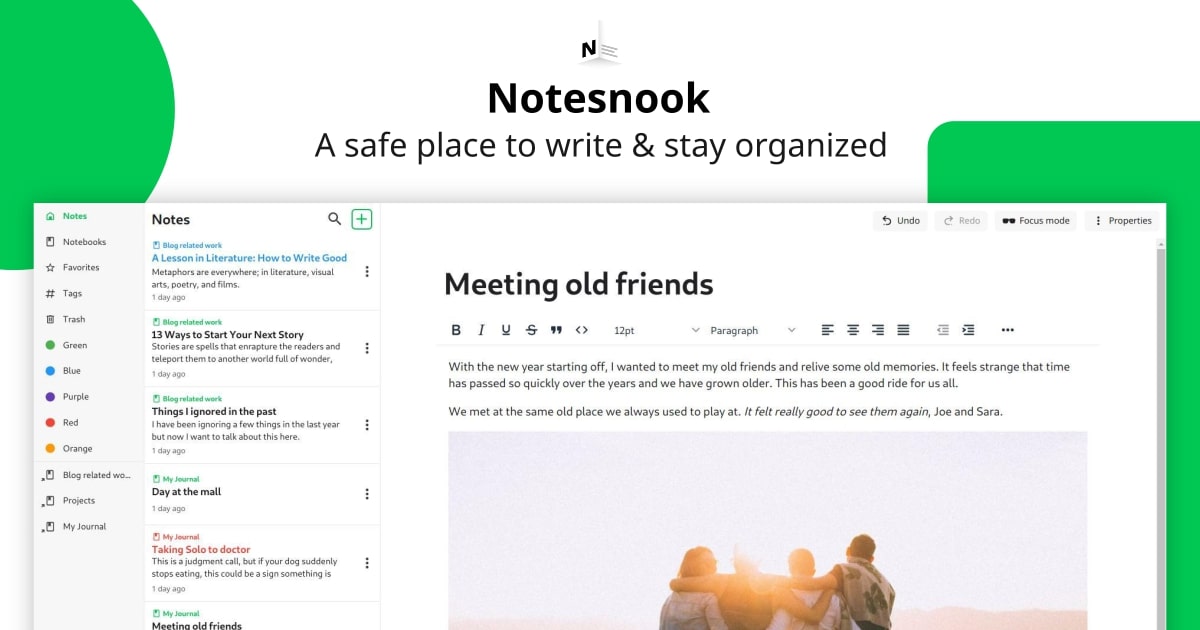

Wondering if there might be any way to implement a similar system to what these guys are doing with their encryption services?
They explain better than I can here: How is my data encrypted? | Notesnook Docs
Idea would be that DT would offer a native encryption and provide a paid sync to cloud service that offers versioning. I would really prefer to have a paid and managed backup with versioning than to rely on my own scripting. Not sure if thatâs the reason everybody else is looking for a solution in the past, but it seems like a nice way to ensure that a userâs data is always protected and also ensure that there are versions of backups available if anything is corrupted or accidentally changed.
