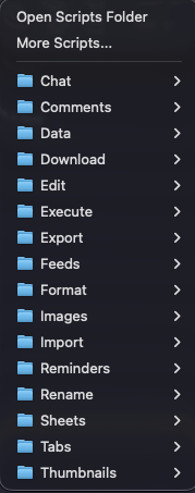

That makes me think of another thing - if someone in the community can answer whether there’s any shortcut to more quickly paste the current URL inside DEVONthink? In other words, to avoid x number of clicks.
Thanks in advance!
Paste where exactly and to achieve what?
Let’s say I have a URL on my clipboard. Instead of going through the menu in the attached screenshot → tabs → open location with the mouse pointer, is there any way to reach the field where you subsequently paste the URL without these clicks? It would also be nice if you could reach that menu with just a key press even outside of DEVONthink (for someone who works with multiple spaces). Or do I miss something and doing things more complicated than I have too?
