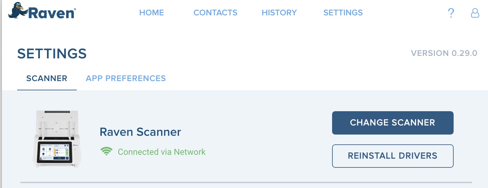

I have just received a Raven Original Scanner and connected it via Wi-Fi and it works with DEVONthink without any issue. In the Raven Desktop app settings does it show the connection via the network as below?
