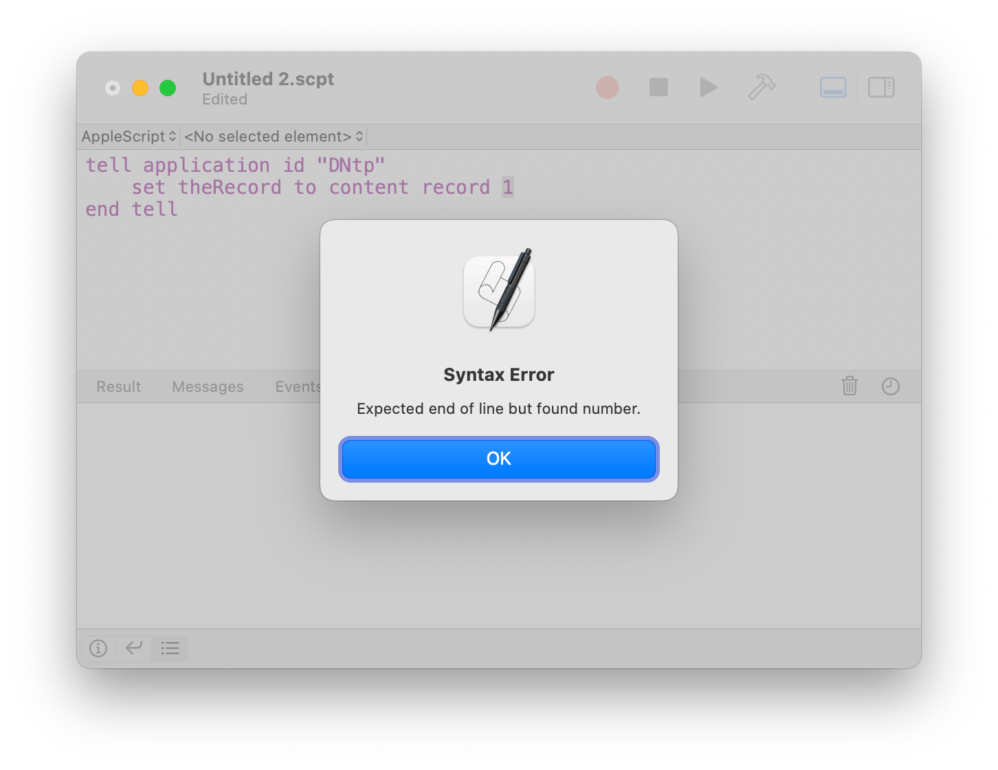

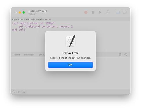

In this case, there is already a problem in the first statement – which doesn’t compile because of a syntax error:
Note that the problematic part (“1”) is highlighted. (It might be a bit hard to see behind the alert)

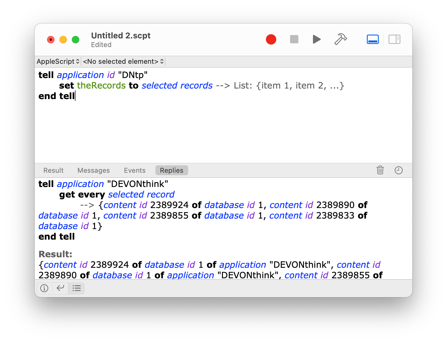

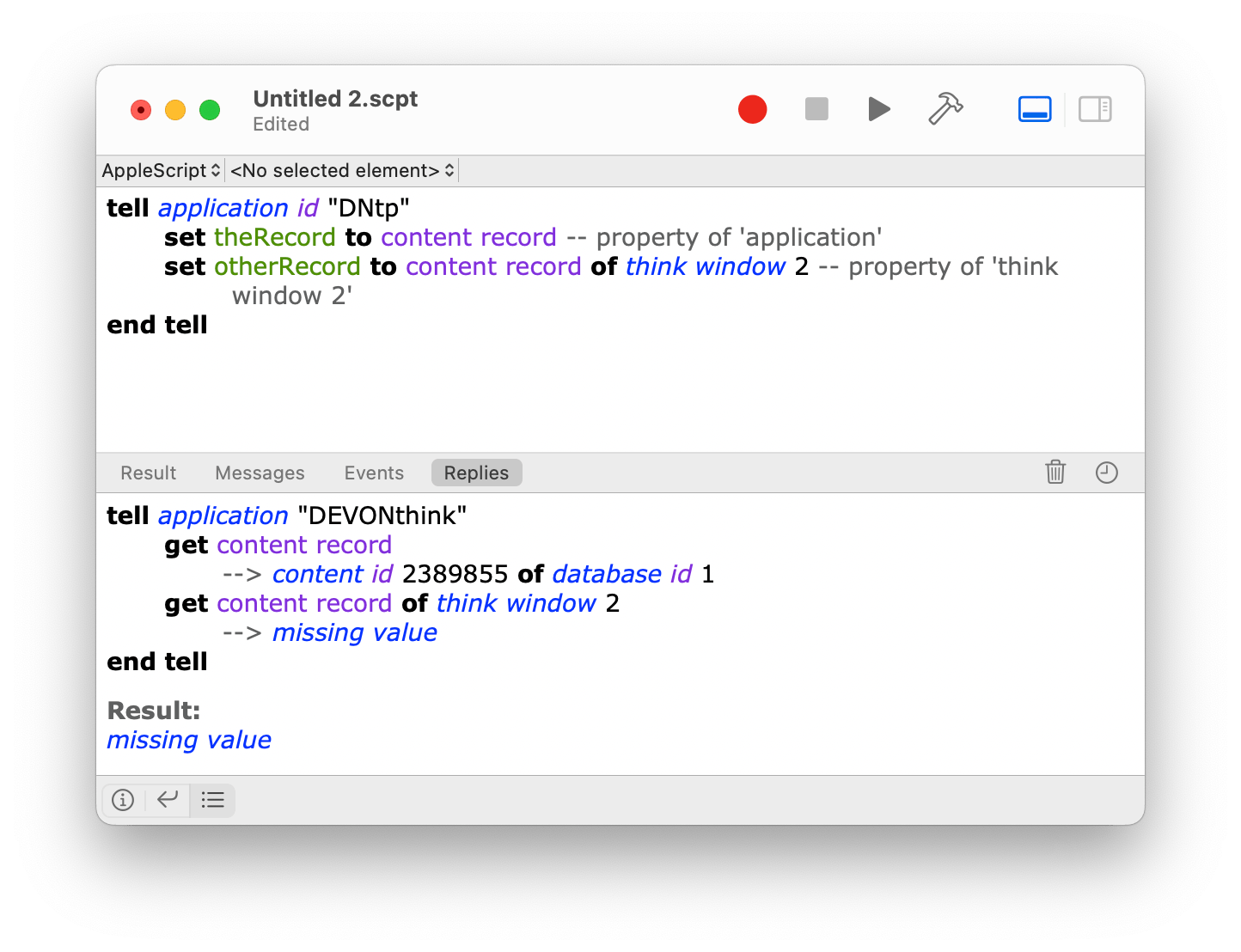

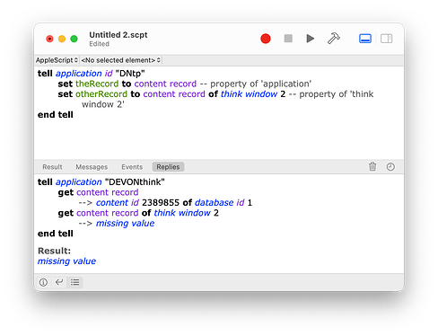

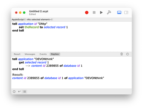

content record is a property (of either the application, window or tab). The “1” is a short form of specifying the first object/element of a certain class, for example selected record(s):
I guess AI doesn’t know the difference.

	if (selected records) is {} then return -- No selection, stop.
	repeat with theRecord in (selected records) -- Loop through selected records

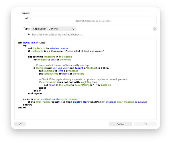

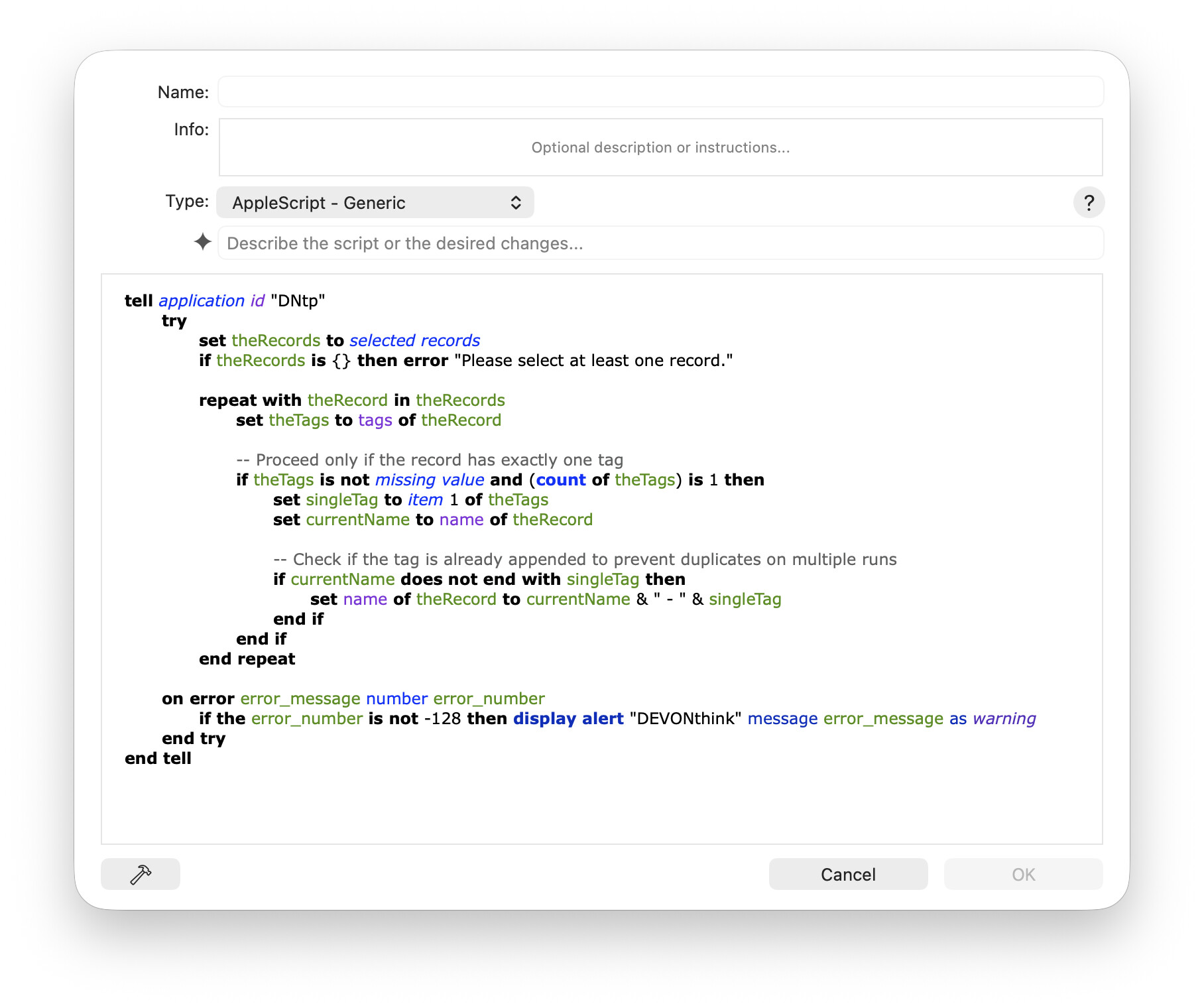

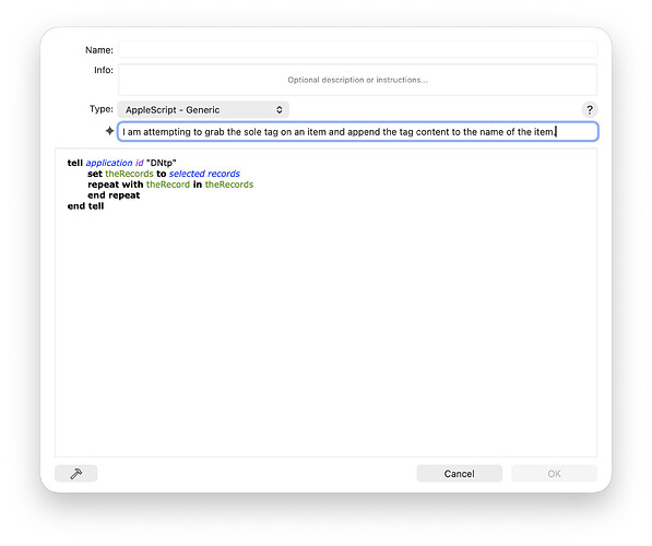

It’s definitely not that bad when using DEVONthink’s script assistant, see e.g. via Data > New > Script…. The assistant provides the complete, current script suite to the AI, checks that the script can be compiled at least (and performs automatic retries otherwise) and fixes the most common issues. The prompt is of course crucial too.
But unfortunately most users seem to ask the preferred chat app or DEVONthink’s generic chat assistant and the training data of (almost) all large language models contains little to nothing related to DEVONthink 4 scripting.
E.g. here I just used the the original request for the prompt and Gemini 3.1 Pro:
A little bit more verbose than necessary but fully functional.

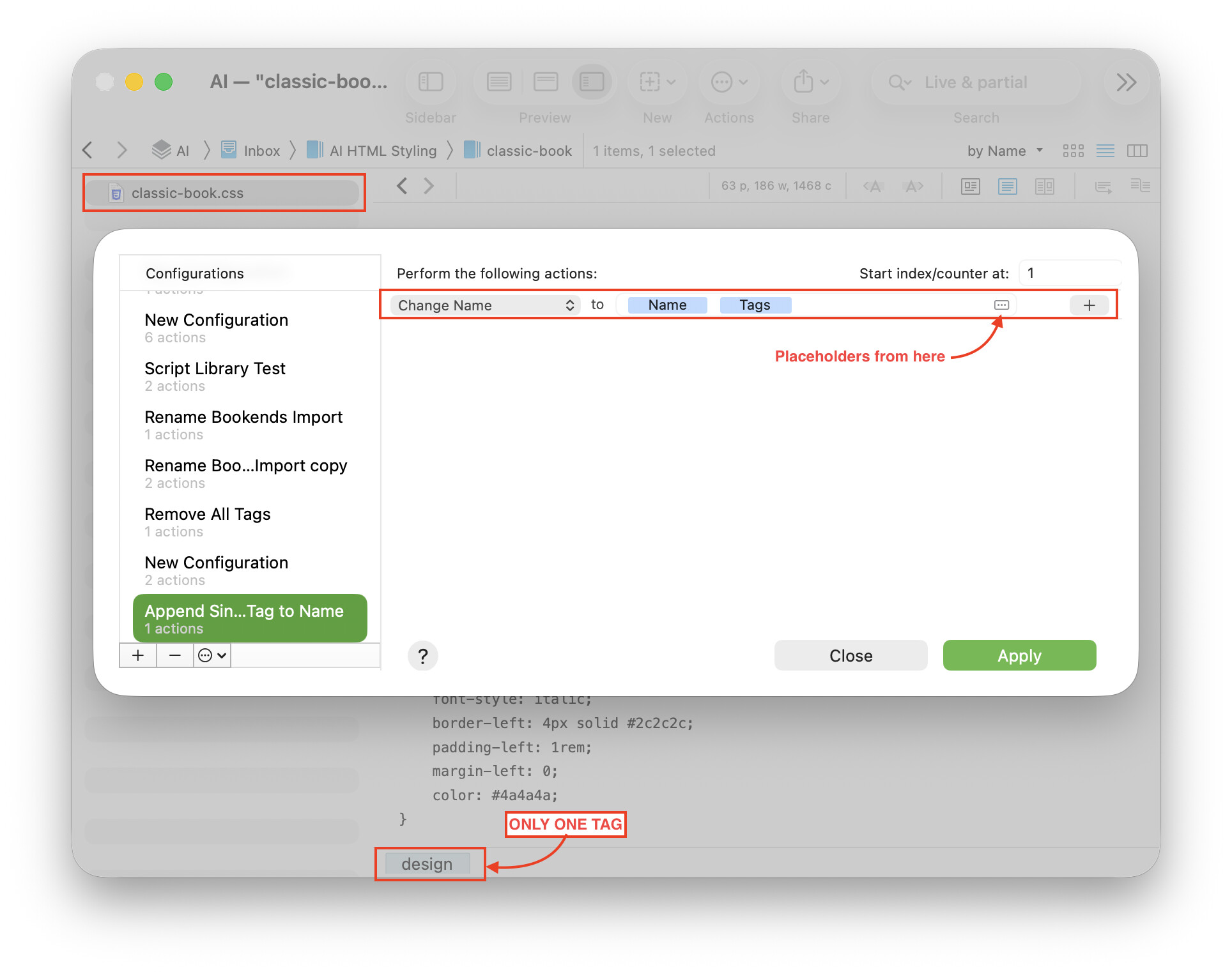

  1. Doesn’t have to be a script. I subsequently tried a smart rule to append tags to name, and that worked.

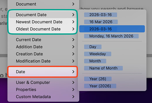

I would like to be able to use a smart rule to add a sortable document date (without needing to add it manually or use an external service to extract it and add it to the filename), but as far as I can tell I cannot add the document date with a smart rule; only dates relative to the current time, such as current date, and some system generated dates (created date, etc). No doubt there is a way to extract the document date using AI, but none I can see using DT’s current implementation of AI. I would love to be steered in the right direction if this is doable.

Here’s what I see in my version of DT4:
The third variant of the date format is a sortable (ISO) one.
Check out the section on “placeholders” in the online documentation.

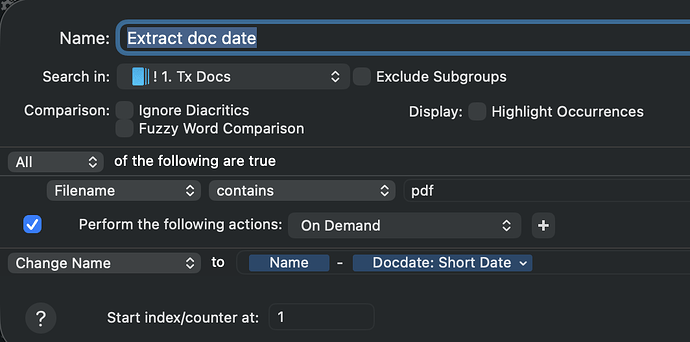

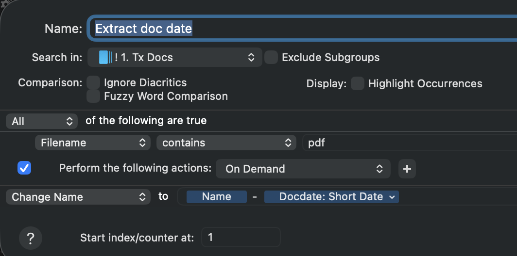

I’ve tried using the following:
Using the above smart rule applied to many PDF+Text docs with dates in different formats, often with only one date on the page, and always within the first four pages; always return a revised name like this:
Name -
The date does not seem to be detected.
Will DT only accept certain date formats for detection?
I tried similar with Document Amount. This is successful in some cases, picking up currency identifier where it is ‘$’ and amount, but in other cases just the amount. Have not tested other currencies (not using ‘$’) I commonly use as yet.
It looks like you’re using a date placeholder for a custom metadata field named “Docdate”. That has nothing to do with dates detected in the file by DEVONthink. I marked them with a green box here:
The red box is a custom metadata field, simply called “Date”. (I think it’s one of the defaults you can enable).
