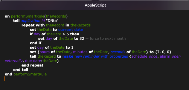

The script suite was completely rewritten with lots of additions and changes. But not every script is still compatible and therefore might need some minor changes.
Alternatively you could use this:
set {hours of theDate, minutes of theDate, seconds of theDate} to {7, 0, 0}

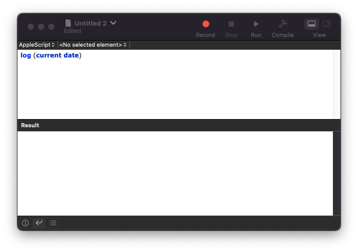

If you run
log current date
in Script Editor, what output do you get? I can’t try that here, because my locale is set to German.

@chrillek Interestingly, I get nothing at all:
…which is bizarre, to say the least!
Thanks — your solution definitely leaves me with a clearer idea of what the script’s trying to do the next time I look at it :+1:

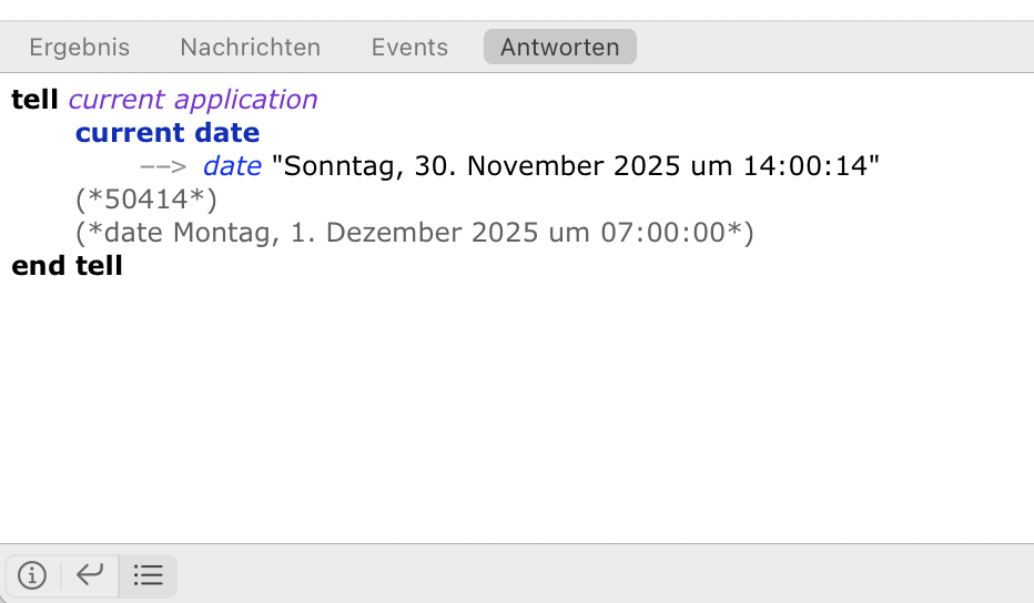

Turn on the protocol with Cmd-3:

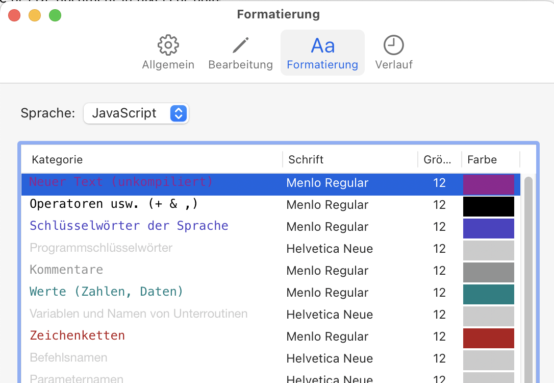

Even in Script Editor, font size and color can be modified:
But I wouldn’t hold my breath waiting for Apple to fix dark mode for Script Editor.
Thanks — I get this:
Result:
date “Monday, December 01, 2025 at 08:51:39”
I wonder if it’s the “at” that it’s wanting now?

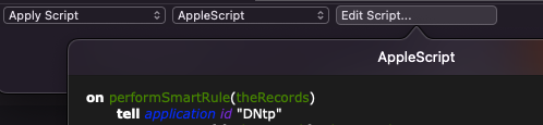

As for the colours, I wasn’t talking about the colours in Apple’s Script Editor — I guess that would apply if you only used external scripts with DT4, but that’s a faff for inline scripts. If you edit a smart rule in DT4 that has an inline script, and click the “Edit Script…” button, DT4’s own script editor is what’s showing up with unhelpful colours. (At least Script Editor does let you configure them!)
I was hoping to avoid having to copy a script from DT4 and paste it into Script Editor just to be able to read it :grin:
There’s always light mode :wink: Perhaps DT’s script editor uses the same colors as Script Editor so that changing them in one modifies them in the other?

AH. That’s the solution — that window is just Script Editor in a DT4-shaped trenchcoat. Thanks :+1:
Changing the Script Editor settings gets me something usable in DT4. Of course, Script Editor’s background can’t be changed from white, but I tend to use Script Debugger for editing anyway.

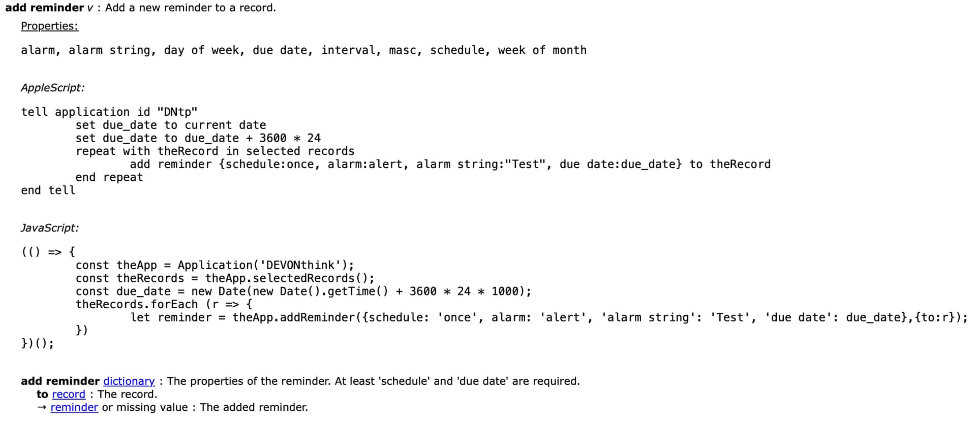

The due date expects (and always did) a date but the rewritten AppleScript support of DEVONthink 4 uses a modern .sdef-based script suite contrary to older versions, this might trigger subtle differences like this one. But overall the new format offers more options and improves the compatibility to JXA a lot. And version 4 includes also a new command plus examples how to add reminders:
And this command accepts a string:
set theDateString to (date string of theDate) & " 07:00:00"
add reminder {schedule:once, alarm:open externally, due date:theDateString} to theRecord
