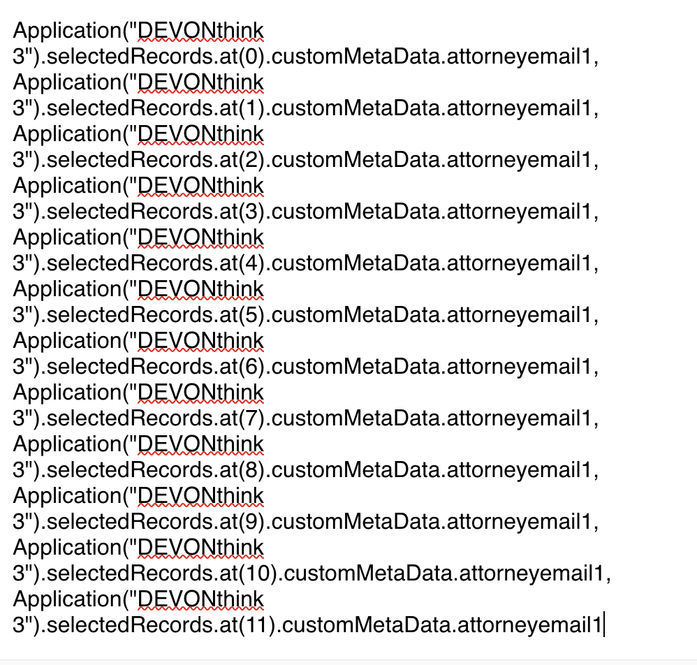

Here it is in Script Editor in the original form I posted:

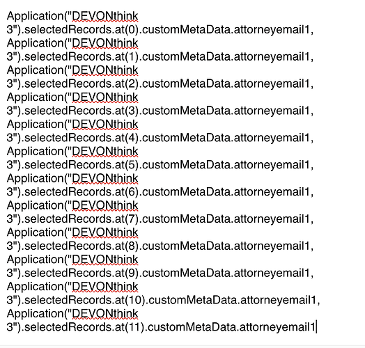

And here it is if I replace return with console.log:
When I see that error, I try if it goes away when I append parentheses somewhere, thus taking the value of a object specifier. Since I’m not at my desktop today, I can’t give better advice.
Alternatively, you could use the method to get a specific metadata value (getCustomMetadata or so)
