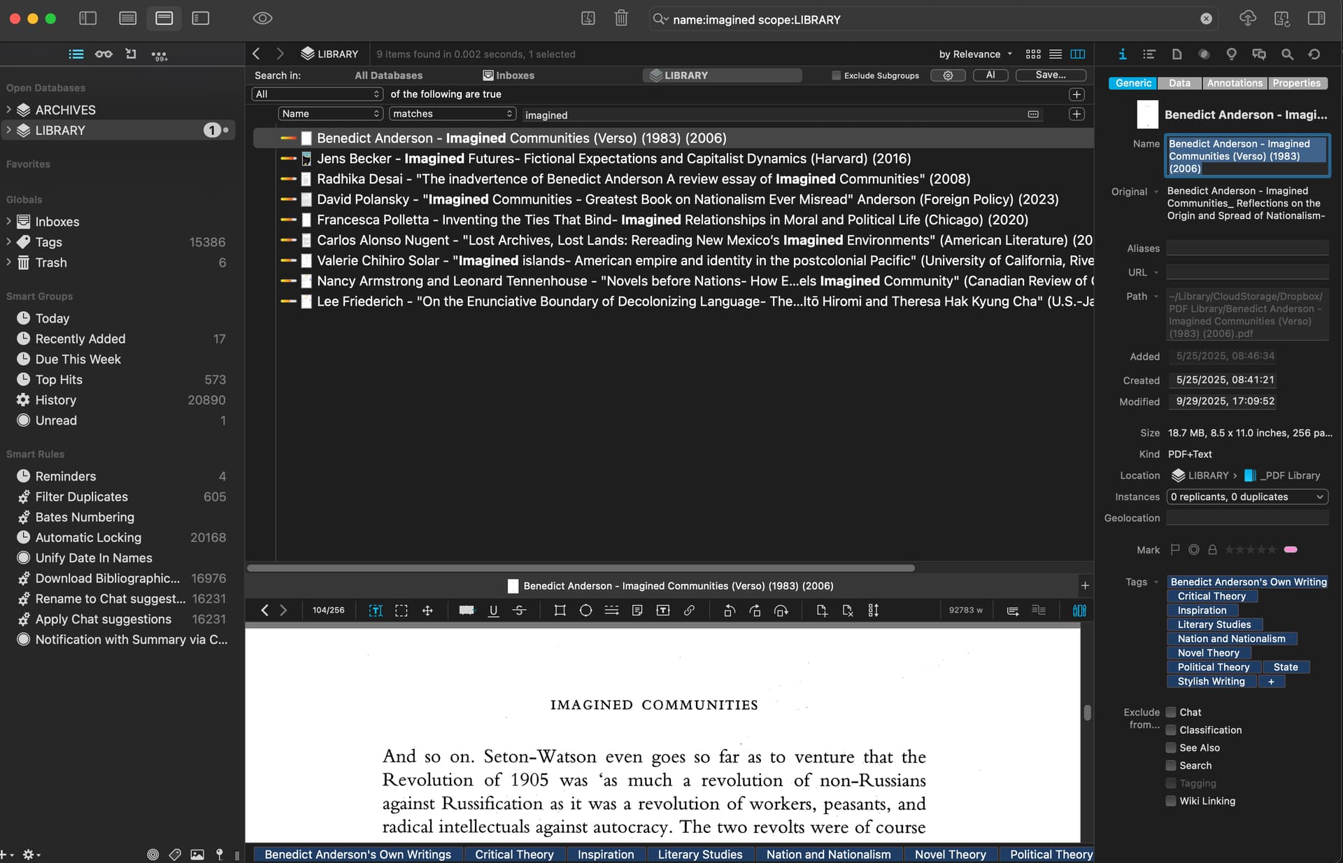

I am using Devonthink 4.1.1, which I use primarily to organize and search through my PDF library.

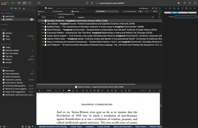

I created a Custom Metadata, entitled “PubYear” (Integer Number). Which appears on the right navigation side bar under “Data.”
Question: Is there a way to auto-populate PubYear by prompting Devonthink to extract the years between parentheses?
