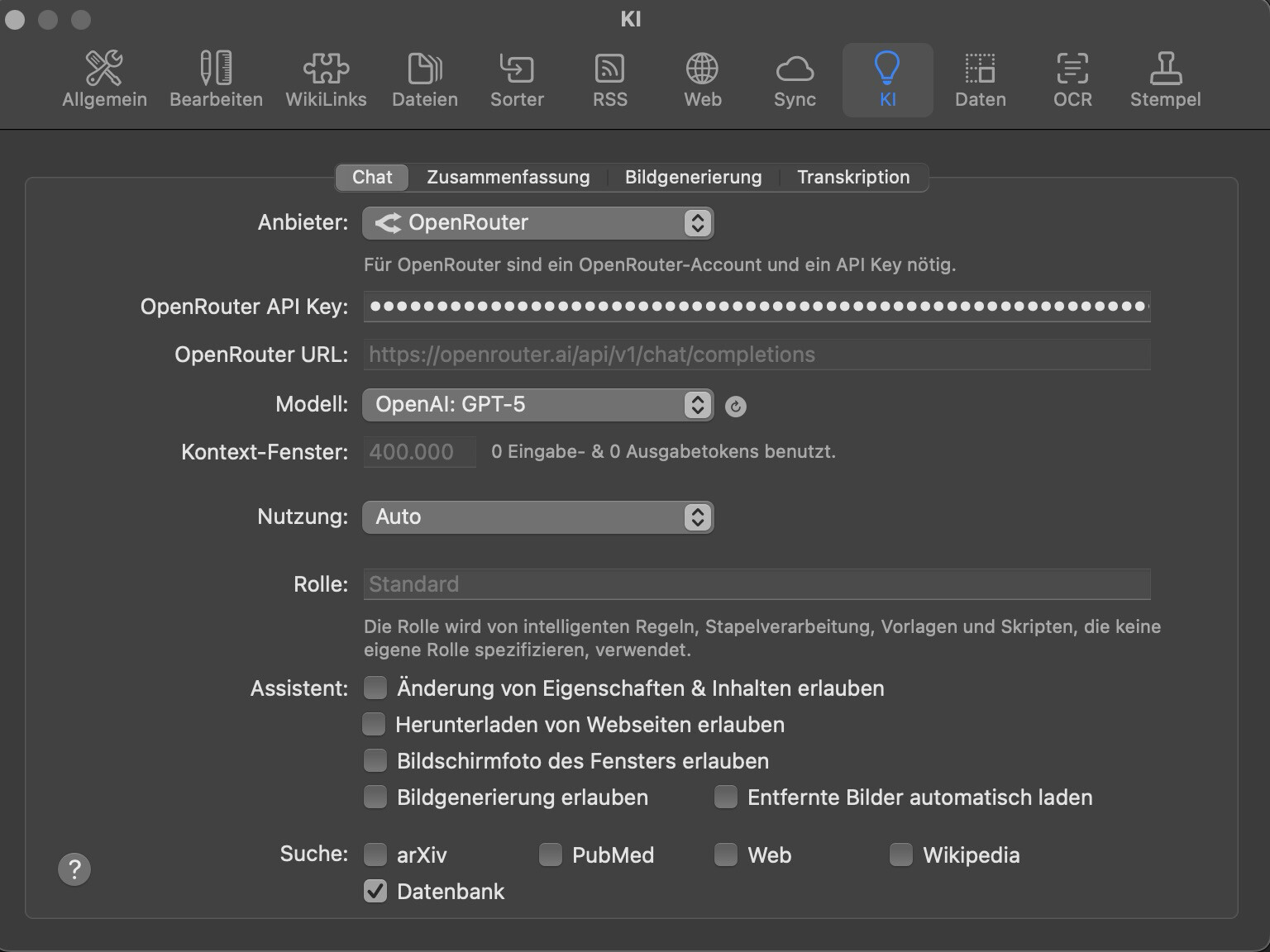

I wonder, is there anything in the settings I have misunderstood that opens up this process (see screenshot for settings?

In that case, it is better to use the bespoke provider and model instead of using OpenRouter. The same is true if you have an Anthropic, Gemini, etc. API key.

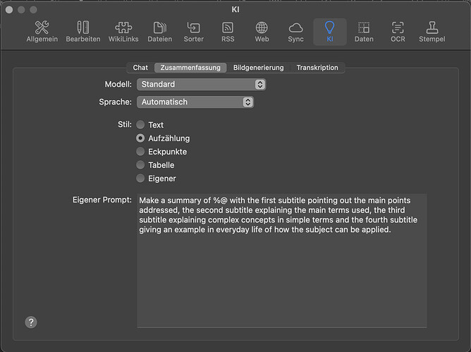

DEVONthink doesn’t use or prefer Nova Lite internally in any way. Which AI features do you use regularly? E.g. the chat inspector/popover, scripts, templates, smart rule and batch processing actions/placeholders? Is the model selected in Settings > AI > Summarization or Settings > AI > Transcription?

No, that’s not what I said at all. I commented on you accessing ChatGPT 5 via OpenRouter and said you should use ChatGPT in the AI > Chat > Provider popup instead.

And, no, neither is it selected in DT settings (where “standard” is checked; … but then I didn´t use any summarization the last day… but still see 50+ activations of Nova over 3-4 timespans… :thinking:

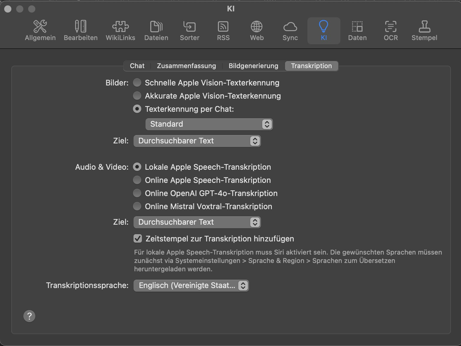

And definitely no smart rules or batch processing that use the actions Chat - Query or Chat - Continue if…? These actions also support choosing a different model, just like Settings > AI > Summarization and Settings > AI > Transcription > Text recognition via Chat or scripting.

… there is a backstory, though, that I might put somewhere else: the funds-limit was hit, as suddenly in the last month my DT-AI-usage was going beyond 50$, without me being aware of really extensive active usage… This is when I changed some of the settings to see what influences this and leads to such unintended amounts within DT (so, I disabled “allow modification of content” as well as “Online OpenAl GPT-4o-Transcription” for audio/video and OCR via Chat (which I didn´t intentionally use anyways))…
