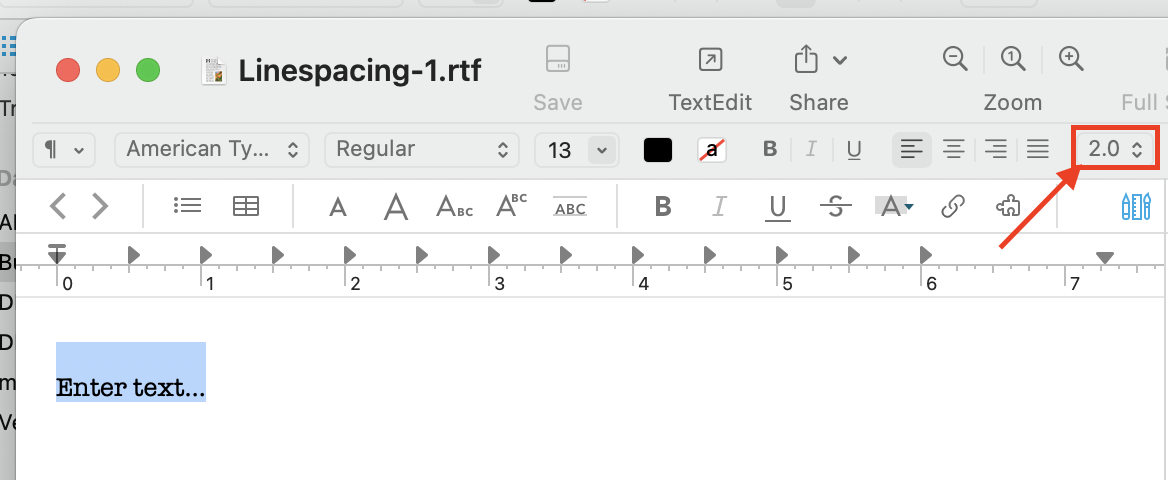

RTF templates already preserve the linespacing. This is a document I just created, with a line of text to establish the linespacing of 2.0, then exported as a simple template. Upon using the template…
In settings the line spacing is set to 1.3 so any new file defaults to that.
It is unclear what you’re saying here, but if you mean “using Data > New > Rich Text”, then logically it will honor the Editing settings. You have to use your template in order to have your own custom settings.

Think I see where I’m going wrong. When doing the spacing I need to leave some text at the top of the template in order to retain the line spacing. I have been creating a couple of lines of text to set the spacing but then deleted it as superfluous so I would be working from a blank page. However, it’s the saved text that ‘fixes’ the line spacing; with no text it defaults to the global setting, even though it’s exported as a template rather than a plain RTF file.
Think that’s correct :grinning_face:
Yes, that’s correct. Linespacing, fonts, etc. are tied to text so you should have some dummy/boilerplate text in the document. That’s also helpful for actually seeing what the formatting in the document will be.
