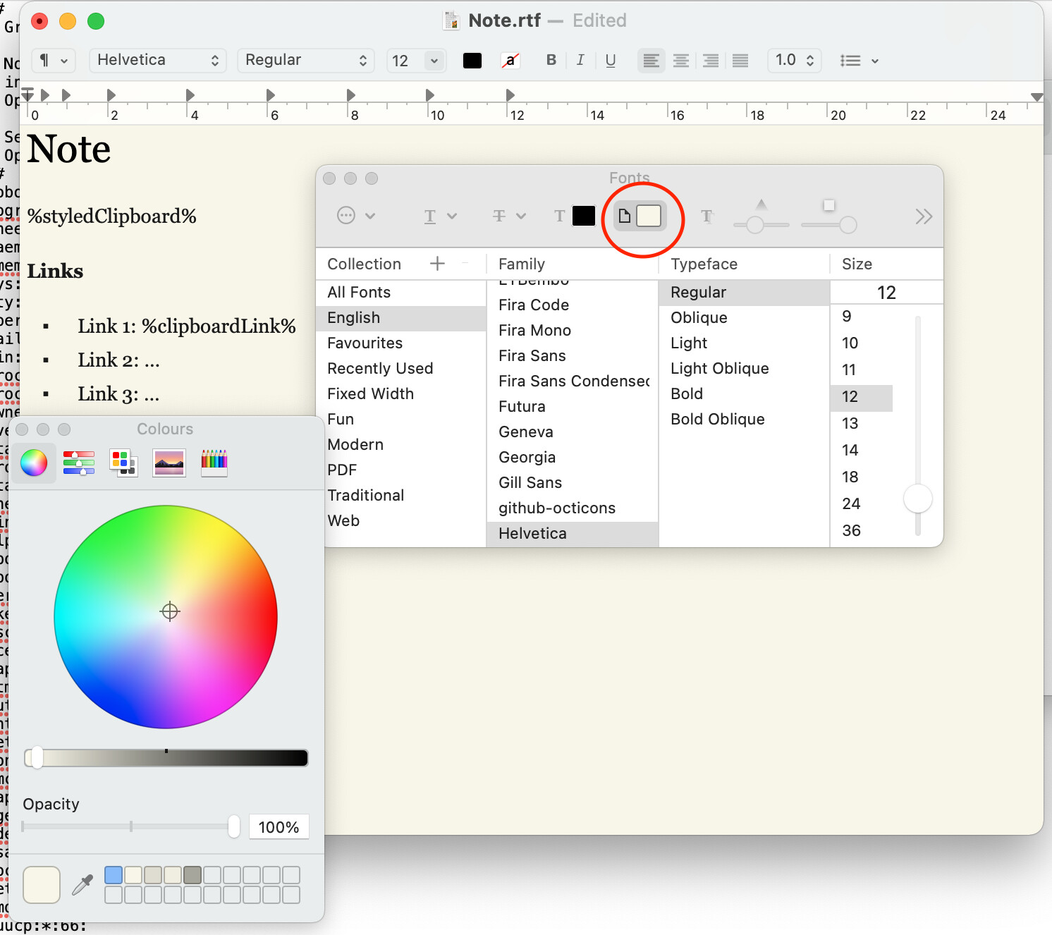

Go the Templates folder in Finder (you can click on Data > New from Template > Open Templates Folder) and navigate to Productivity > Note.dtTemplate. Right click on this file and choose Show Package Contents.
In the new Finder window, navigate to English.lproj (the principle is the same for other languages, of course) and double click to open Notes.rtf in TextEdit.
In TextEdit, press cmd-t (or Format > Font > Show Fonts) to get the Font dialogue up.
Click on the colour patch next to the little icon which looks like a document and the colour swatch will appear. Choose you new colour — the text background should change with it.
Save the document, go back to DT3 and invoke the Note template: you should find the background of the new document will reflect your changes. Obviously, this will only work for new notes — existing ones will show the old background.

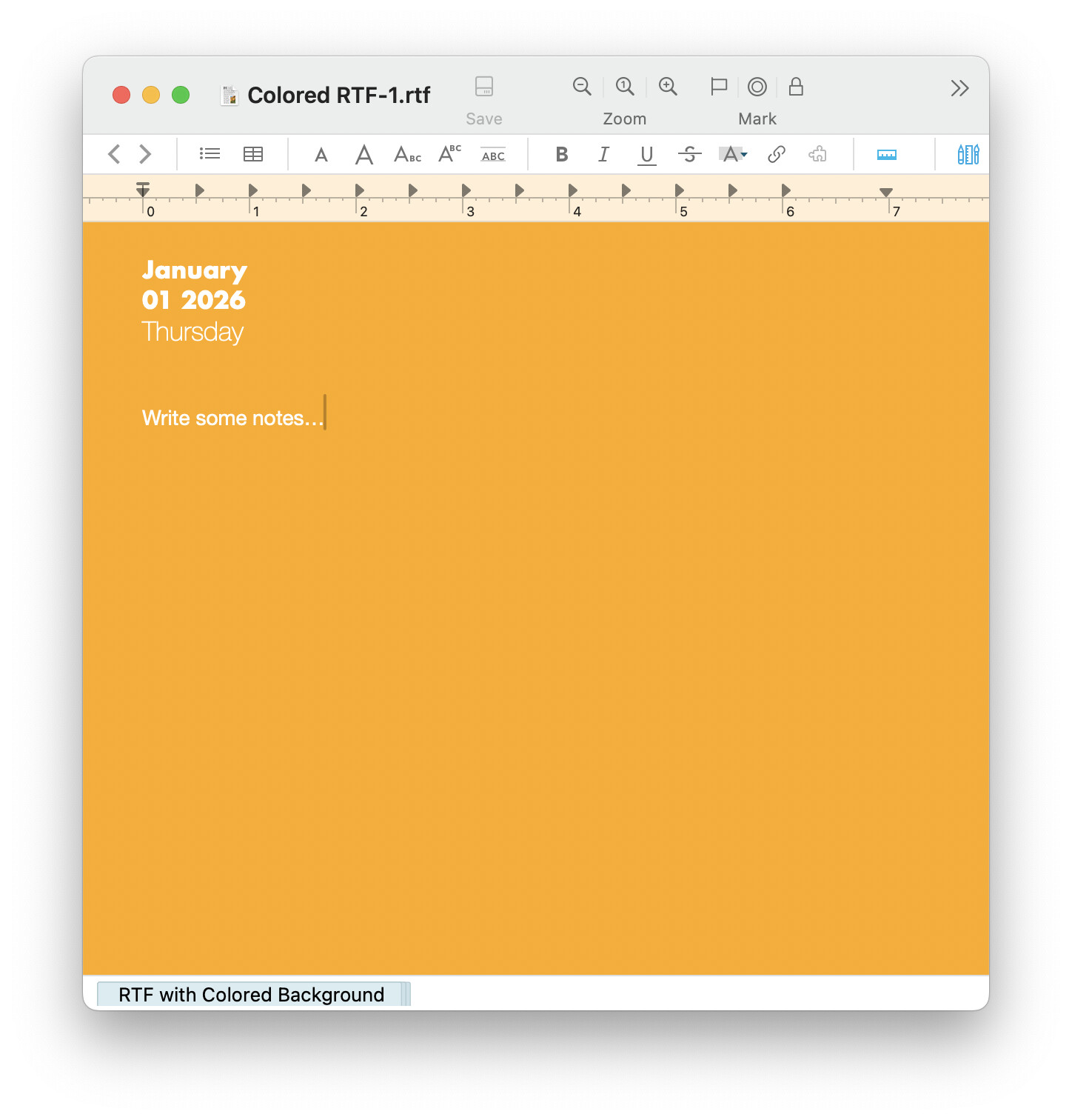

And yes, DEVONthink supports having a colored background on RTF. DEVONthink To Go does not. And whether third-party applications support this as well, we have no control over.

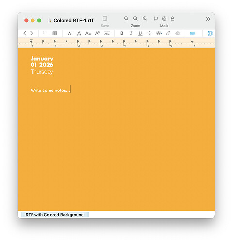

  1. Create a new RTF file.
  2. Click in the contents and press Command-A to select all.
  3. Choose Format > Font > Show Fonts or press Command-T.
  4. Set the foreground and background color wells.
  5. Type into the body to confirm the styling and save the document.
  6. With the document selected, choose File > Export > as Template.
It is now ready to use.

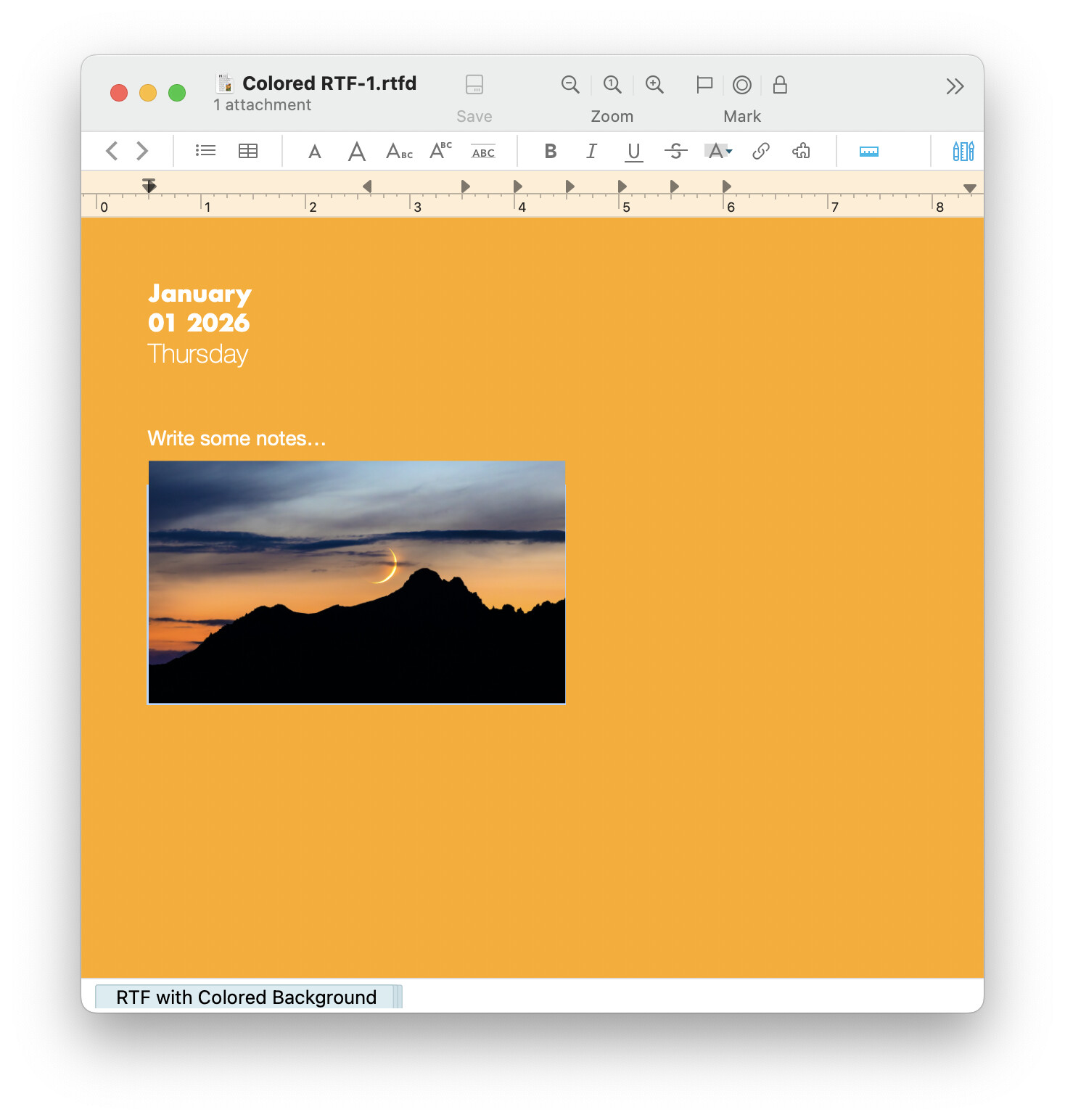

Just one point. I’m probably wrong on this but, is the RTF file in fact RTFD which should work better with images, jpg, png, etc?
You’re welcome.
This is not necessary and is not included in the instructions I provided. Follow them as written.
No. An RTF is an RTF. An RTFD is an RTFD. However, adding an attachment to an RTF converts it into an RTFD document, maintaining the background color… simple.
