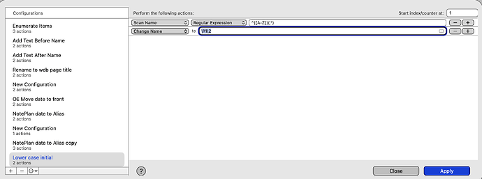

I’d like to rename all my tags to purely lowercase, and I’ve been trying to use Batch Renaming to do it.
The following regex works in BBEdit:
Input: Translate
Search: ^([A-Z])(.*)
Replace: \l\1\2
Output: translate

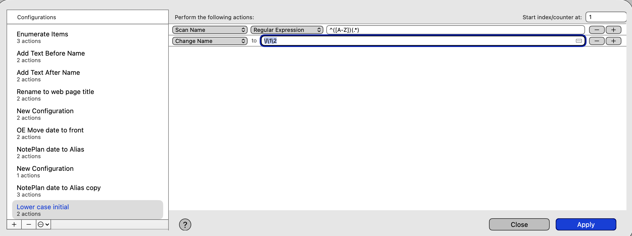

But it doesn’t work in DT4, where:
results in \1Translate.
Is this just one of those features of regex that hasn’t been implemented, or am I doing something wrong.
Is there another way of doing this without using AppleScript?
Thanks!

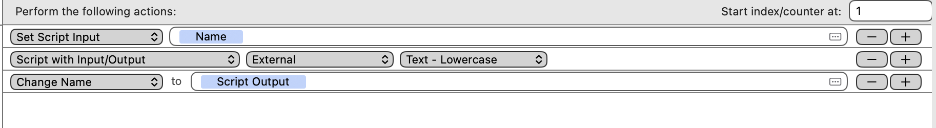

Regular expressions are only used by the Scan Name/Text actions, all other actions like Change Name are only able to use the numbered results.
The Script with Input/Output action might be a good alternative, there are already scripts for lower and upper case (see ~/Library/Application Scripts/com.devon-technologies.think/Script Output/)

I’ll have a look at that action – thanks, Cris!
Works as intended – I was basically after the principle of what the rename action can do.

I’ve never used the script actions before, so it took a bit of trial and error, but now it works, thank you very much!
