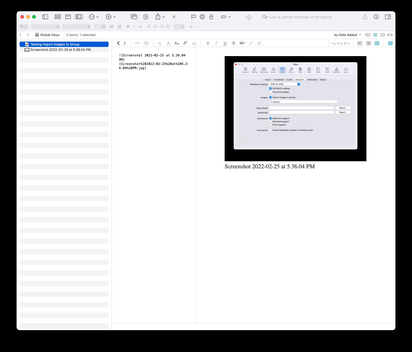

I have set the Preferences accordingly, even using the defaults Assets. When I try to create a Markdown note in Global Inbox and drag an image in Global Inbox into the note. There is no Group created.
Anything else that I need to do?
But an image link is created in the Markdown document when you drop the image into the file, correct?
Yes, the image link is created.
After doing the necessary editing, I want to move the note and the images (or Group of images) to another database. But I cannot find the Group.
Exactly where are you looking?
The group name will be “Assets” and a subgroup to the group where the MD file is kept. For example, I have a group in a database called “Energy” and for when I save images, they go into Energy/Assets.
Not there for you? Check again that’s what you set in preferences, I guess.
As you can see from the screenshots, I simply checked the Import Images to group, and use the default Assets.
I drag & drop this image in a MarkDown note “Testing Import Images to Group”. Both the image and MD note are in Global Inbox. I expect after drag & drop the image in the MD note, a Group Assets will be created with the image move under the Group Assets.
But you can see from the screenshots, it is not.
I don’t have time now to test this for you. But try putting your MD in a database other than the Global Inbox.

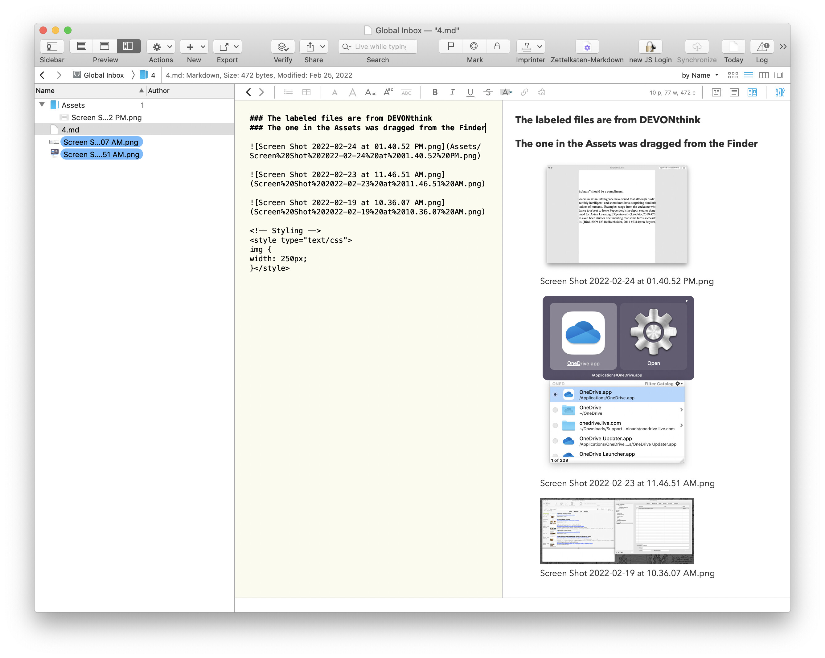

@cgrunenberg, et al:
This behavior occurs if your add an image in DEVONthink via drag and drop or copy and paste.
The Assets group is not created unless the file comes from outside DEVONthink.
The image is already in the database and therefore just linked.
Okay. That’s what I expected but wanted to make sure.
There you go, @TonyLim :slight_smile:
OK. Thanks for reply.
