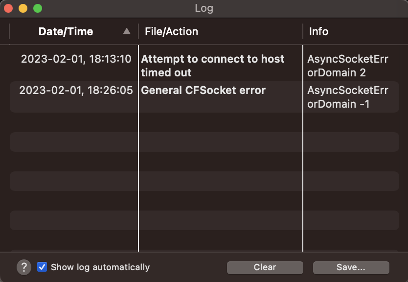

Thx…attached is the screen shot of the log from the Client Mac (the dark one). The server Mac does not show anything in the log.
