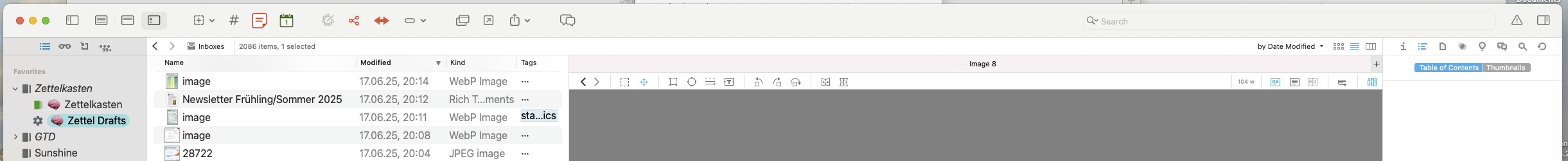

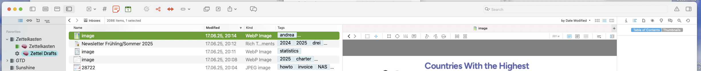

unfortunately I have not yet found a pattern / a trigger for the change. not sure if the pictures help much, but here is a before and after:
what happens is that the relative window size gets changed and requires manual re-adjustment…
Ah, now I understand. Yes, I noticed that too. It also happens in DT 3. Suddenly the width of the document view changes. Although not as much as in this screenshot.
I think it happens when you switch from DT 3 to another app and then back and probably when you wake up the mac.
