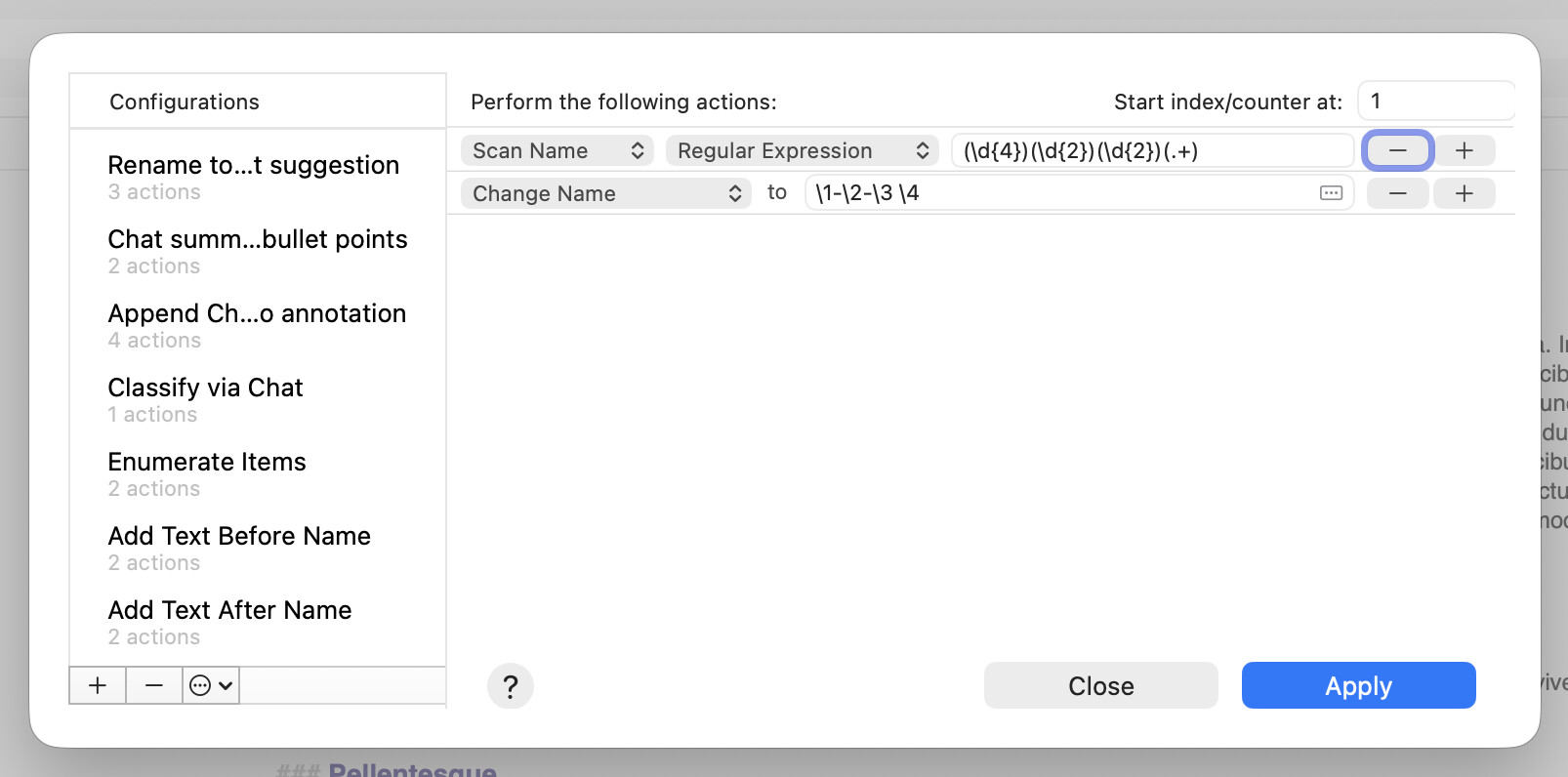

Hey I have just upgraded to DT 4 and the “Rename using RegEx” has disappeared.
I have tried Scripts > More Scripts but that just opens a blank dialog box. Under the DEVONthink > Install Addons menu Additional Scripsts and Script Libraries are showing as installed.
How can I get the rename using RegEx back please?

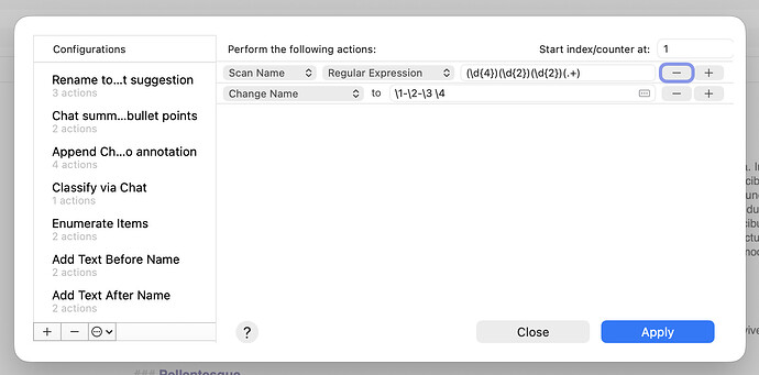

It was deprecated by smart rules and batch processing, e.g., using the Scan Name + Change Name actions.
How were you using it for renaming?
Based on the previous conversation from 6 years ago, it was YYYYMMDD to YYYY-MM-DD. If that’s still the case…
Thanks for such a speedy reply!
So, I was selecting one or more files with the old yyymmdd file name, then using the rename with RegEx script to rename them. With the old way I had to copy and paste the source and destination separately each time.
The new method I have saved a Batch process task which I can now just click - much quicker!
Thanks again!
You’re very welcome!
