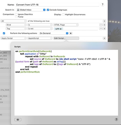

I’m trying to sort this issue with a smart rule, but I cannot make it work. My idea is convert the received file to utf-8 from utf-16. From terminal the conversion works and I get a new utf-8 file that works inside DT. However, when I try to do it via one Smart Rule, the resulting file ends orphaned.
I think I need to “get” the resulting file and add to the same folder as the original, and delete the original, but I don’t know how to do it. Any help is appreciated.
The smart rule just generates a new file but does neither replace the original file nor set the source of the record.
Tried this in the script, but now apart of the orphaned files, it logs “skipped” on each file.
I’m an absolute negate to this kind of things. What I want to accomplish, is convert the same file from UTF-16 to UTF-8, and then continue with the DT part of DEVONsave script.

At the end, @BLUEFROG did it. As easy as it was, and I weren’t able to do it.
			set source of theRecord to (do shell script "iconv -f UTF-16LE -t UTF-8 " & (quoted form of (path of theRecord as string)))
			set tags of theRecord to ((tags of theRecord) & "UTF-8")
end performSmartRule
This will be useful until next update should solve the issue.
