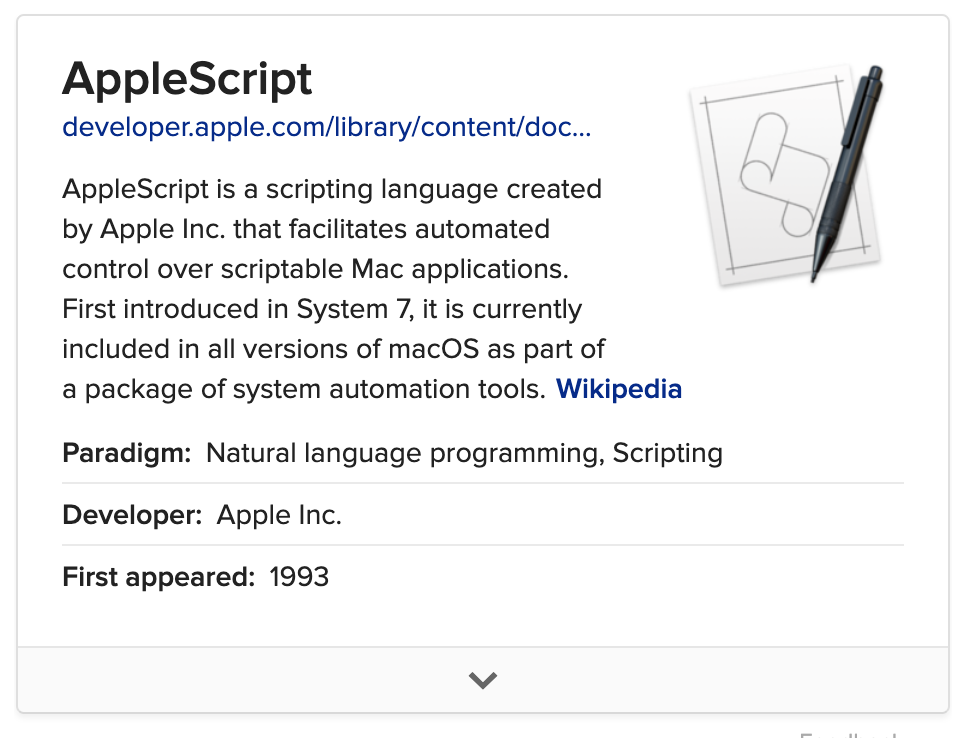

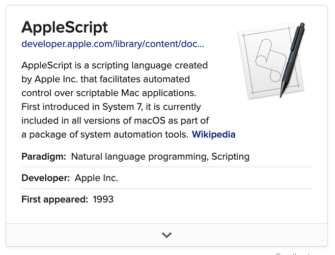

On the other hand don’t think that there’s a relationship between high-level and strongly typed one way or another. To wit: Pascal/Python/Java/C/C++/ObjC are strongly typed, Perl/JavaScript/PHP are not. Fortran is (or was) something in between.
What nags me is that they haven’t used the last 27 years to add more features to the language. Reg Ex, date/time, HTML, XML, JSON… Yes, that’s all in ASObjC, but that forces me to jump through a lot of loops for a little effect.
