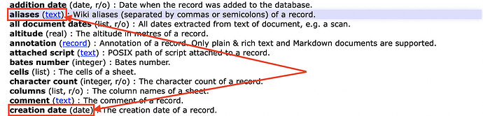

You have to convert the date to a string before setting the aliases.
Thanks!
In the dictionary…
These data types do not match - text and date - so you know some coercion is required.
