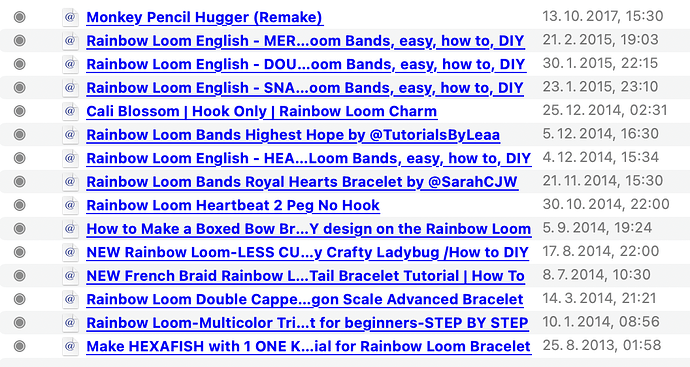

I figured out how to get an XML feed from a YouTube playlist, but when I add it as a feed in DT, it doesn’t bring in any items. I am not sure why. Is it because it’s XML and not RSS? Or because the XML structure is not something DT recognizes? I’ve tried to search the forums, but I am not finding anything that seems similar. There is definitely data in the feed.

The items in the feed are probably too old (see Preferences > RSS), try locking the feed and then refreshing it.
Ah ha! You’re right, that did the trick.

Items of locked feeds aren’t automatically removed (or skipped due to their date).
DEVONthink just uses the dates of the feed, it doesn’t support Youtube in any way. And the dates are probably the publication dates.
I get that. It’s not necessarily YouTube specific, I just wondered if the new appearance of any item in a feed would show up, even if the item date was older.
Only if the feed is locked or removing of articles (see Preferences > RSS) is set to manual, otherwise too old items are never added.
