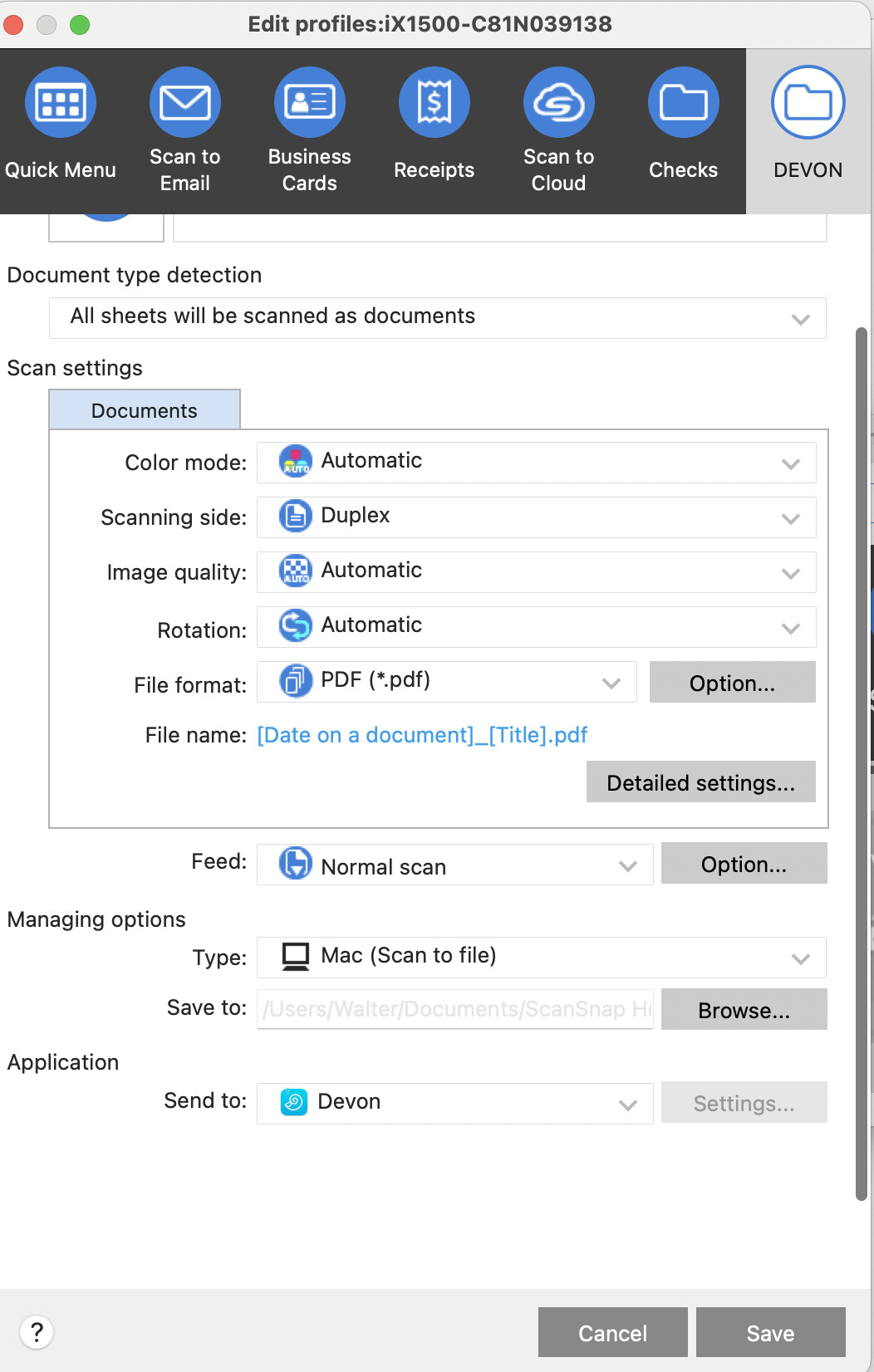

What is the path you’re saving to in the scanning profile?
Thank you for your response. Like your product, this is not a complaint but an observation. To the best of my understanding, profiles are stored on a mac for ix1500 on Macintosh HD/users/[user]/preferences. With ScanSnap Home, there is no option as to where to store a profile, you create a new profile within the manager and it is stored in the default location. The key options are to select a location to send the scan to (DEVONthink in this case) and the management type (send to file in this case which should stop the prompt). I have attached a screenshot of the profile.
As I noted works now, don’t know how the problem happened.

No worries. At a glance, the path looks correct, which is what i was wondering about.
