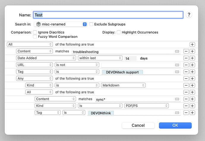

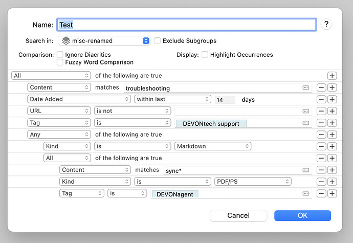

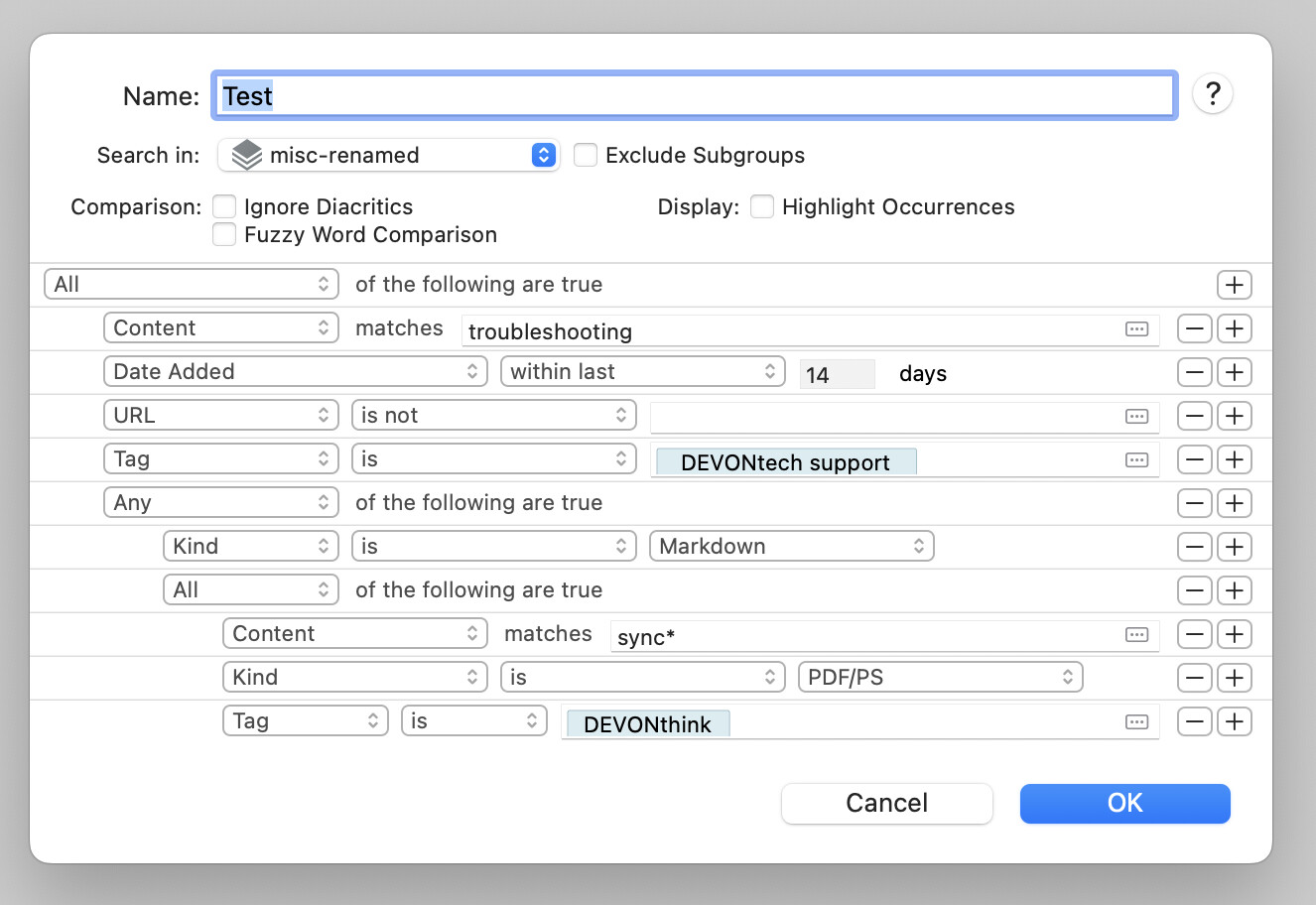

That being said, it is possible to change a local smart group’s predicates though it requires scripting and filtering the criteria to accomplish.
Before
After
