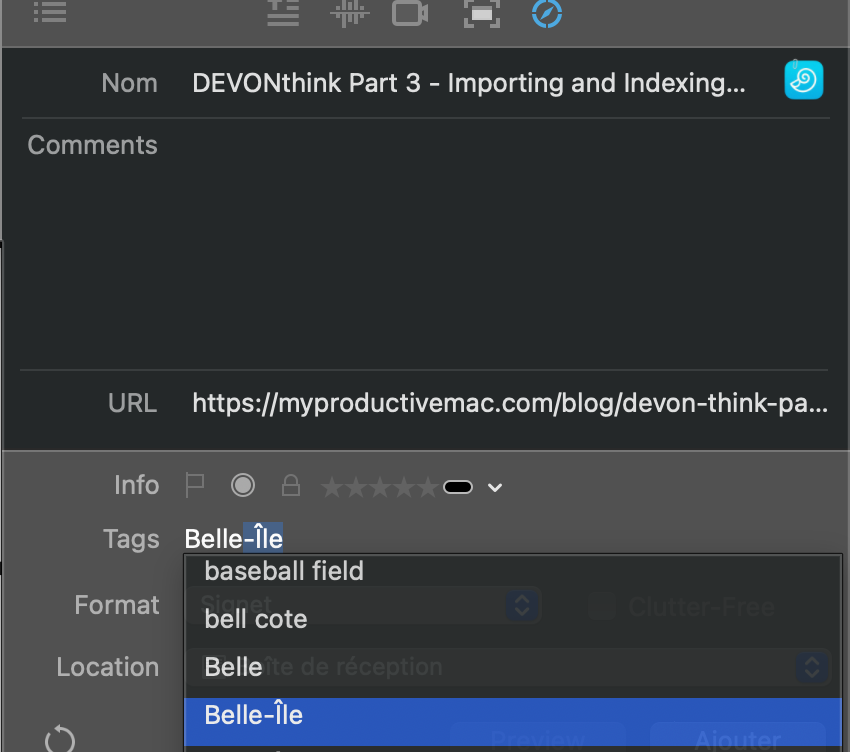

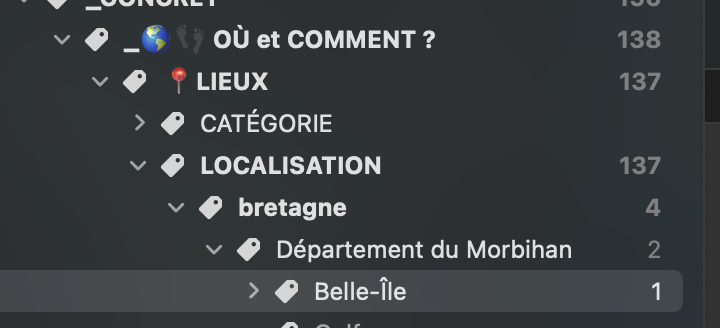

Have you actually verified the tags on the clipped document? I see no issue here other than the parent tags aren’t displayed in the Sorter.

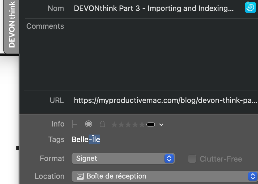

Yes I did. Links only to the least chidren tag (‘Belle-île’ in that case). None of the parent tags are displayed nor written to the file.
See the attached screen captures of the 4 steps of a random import.
The other tags are geolocation tags corresponding to the Mac’s location, added by default , (I would like to desactivate that BTW).
It could be because each database has its unique set of tags. Inbox also has its own separate set of tags.
If you are scanning to the inbox, the tags will be different from other databases.
Not sure on your setup, but this is worth checking.
You can deactivate tag conversions in the Files > Tags: Import settings.

Belle-île
Do you have this tag in more than one database?
Metadata are defined across databases. Tags aren’t. So either user metadata or define the same tags for all databases where you want to use them.
Possible, yes, I’ve re-arranged a lot of things since, not sure though..

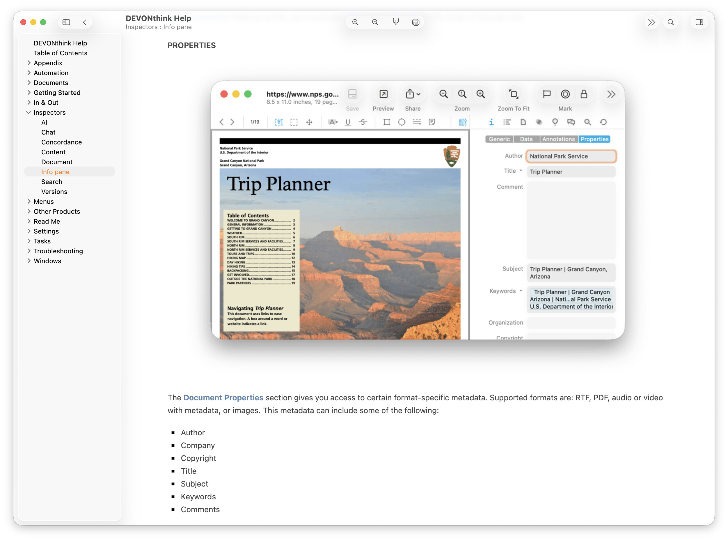

  • Will they work with all types of documents (pdf, web links..) ? Because I see that I’m not always allowed to write in some fields of the info panel, I don’t understand the cause, still a mystery for me.

Because eg PDF metadata like publisher etc. exist only for PDFs.

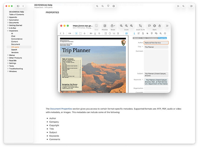

Apart from that: I suggest that you dive into the manual an perhaps experiment. It’s easy to create a test database, where you can put copies of some documents and then play around with them. That way, you see what happens when which in my experience is more helpful than theoreticizing about possible use cases etc.
Inspectors > Info Pane > Properties

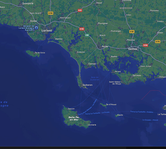

  • For Instance, I tried to enter the name of an island (Belle-île en Mer). it’s the largest island in Britanny. DT converted the name of the island to the name of the nearest big town on the continent (Lorient). A different area than the one I entered.

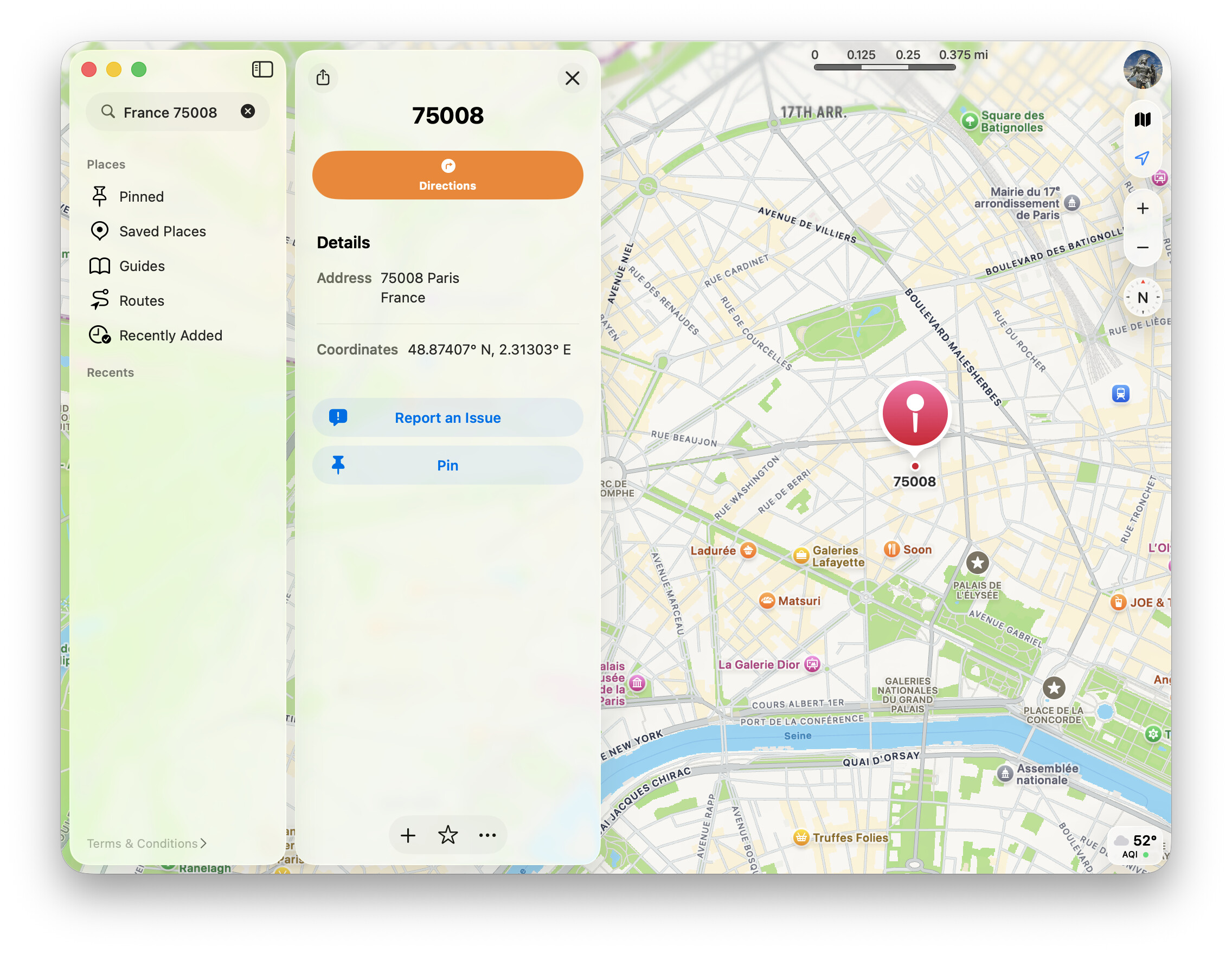

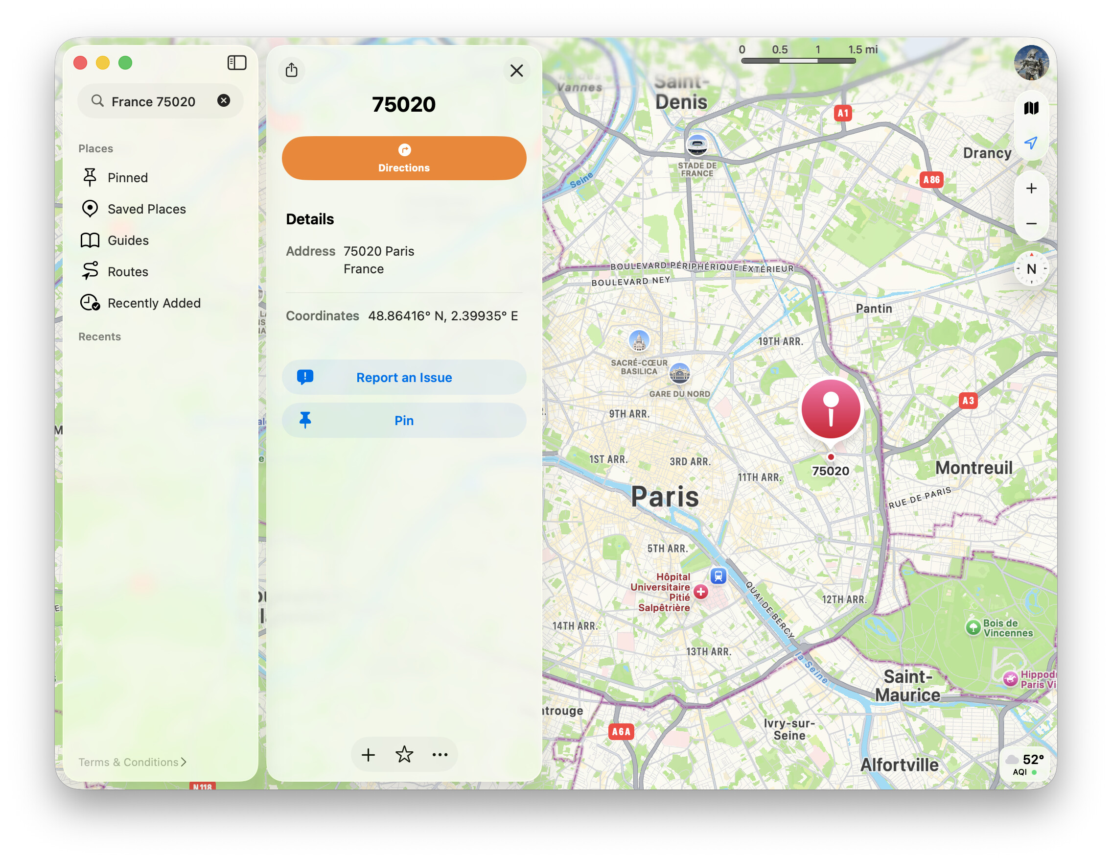

    • Take Paris now : more than 2 million people, 105 square kilometres, divided in 20 administrative ‘arrondissements’ (don’t know how it translates in English), each with its zip code (and a Mayor), from 75001 to 75020. Typing 75008 will return “Paris, Île-de-France, France” instead of the initial ‘arrondissement’. These Zip codes are the official Post Office ones, needed for any letter. A circa twenty times larger area than the precise and correct one I entered.

Thanks, I understand now why some of these properties fields did not seem to accept input for some types of records, like clipped URLs..

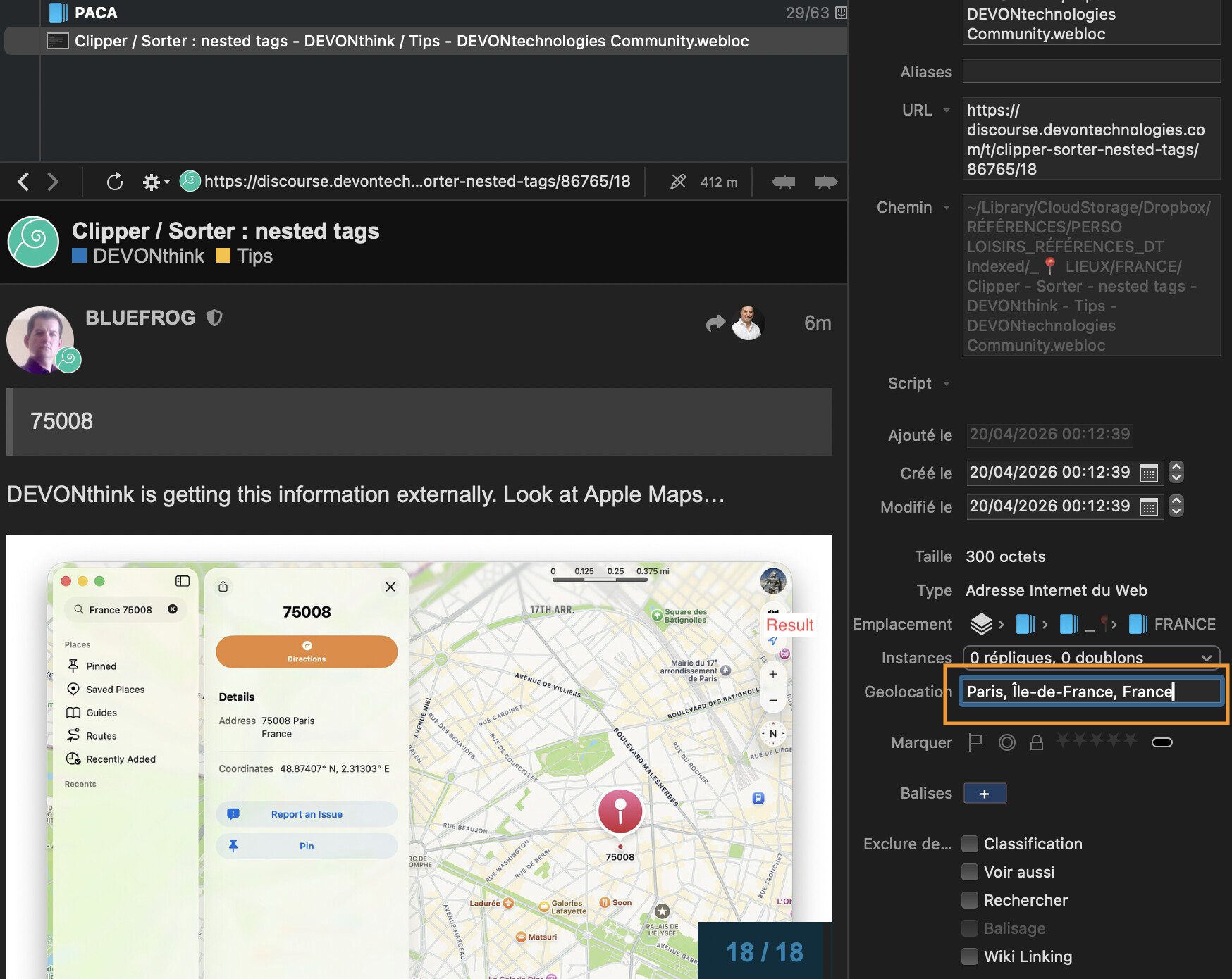

75008
DEVONthink is getting this information externally. Look at Apple Maps…

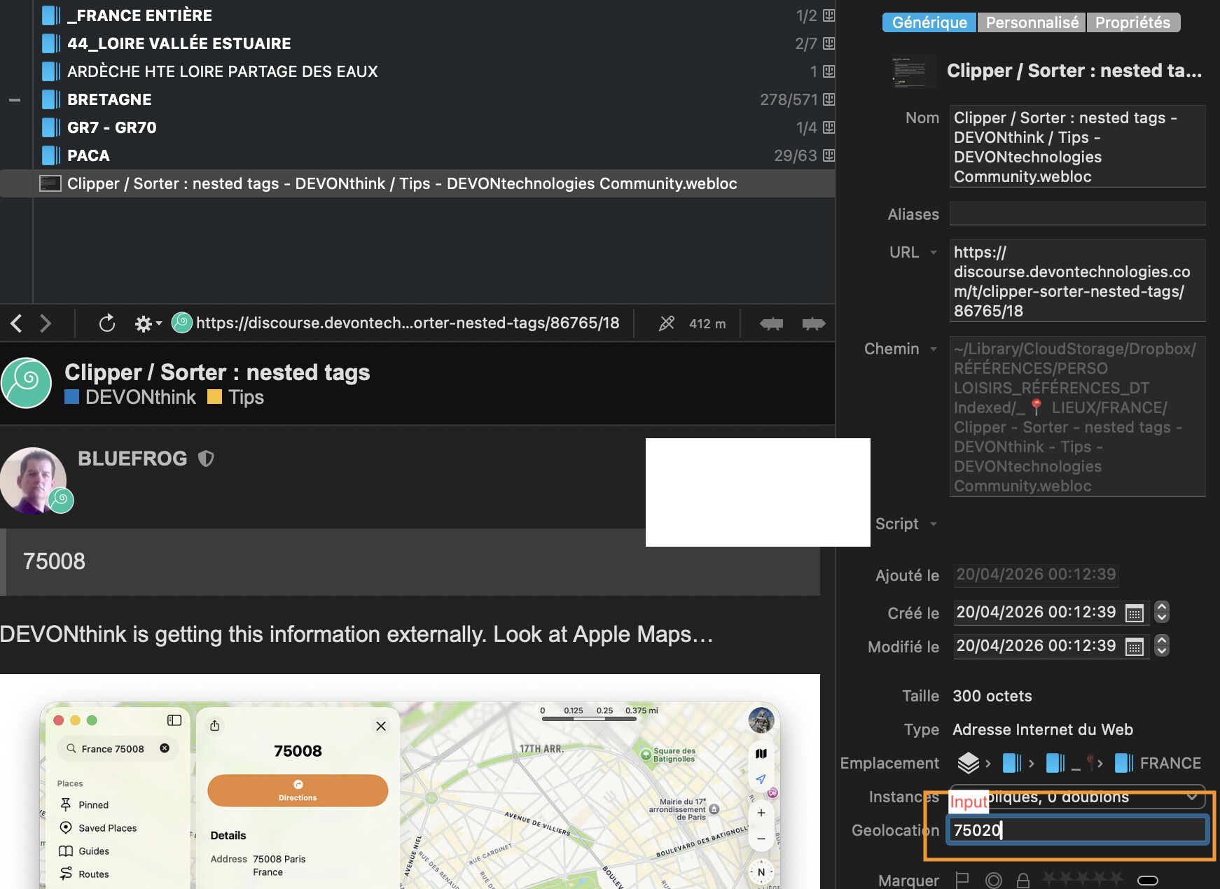

75020

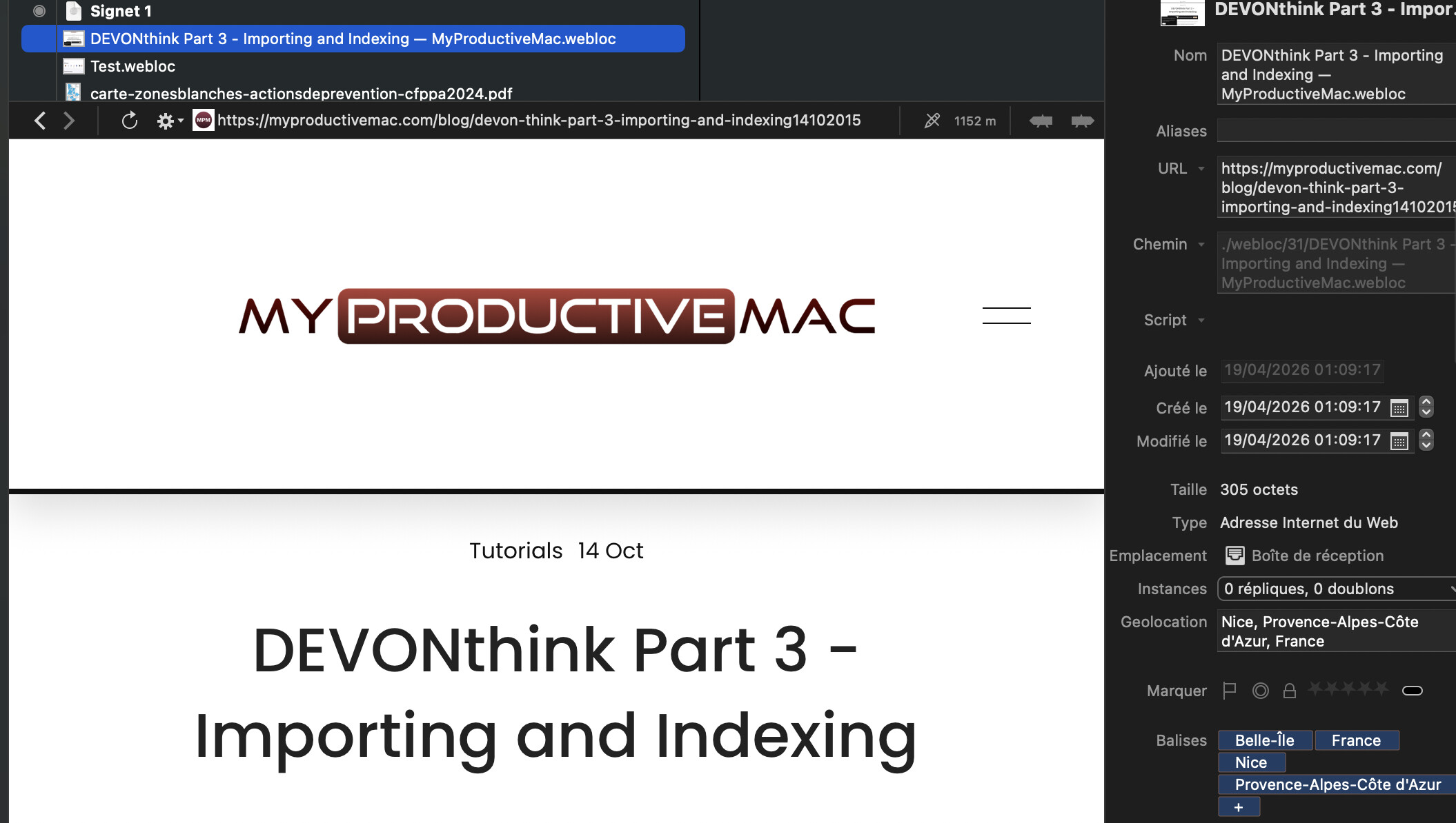

Well, it may work in Apple Maps, but in DT it doesn’t work on my side (see the attached screen capture, I clipped the URL of the discussion).
Like, on the reverse, you may remember the import in Notes of the drag’n drop of a YouTube URL, which has been working perfectly for years on all my Macs, and doesn’t on yours ?
Strange

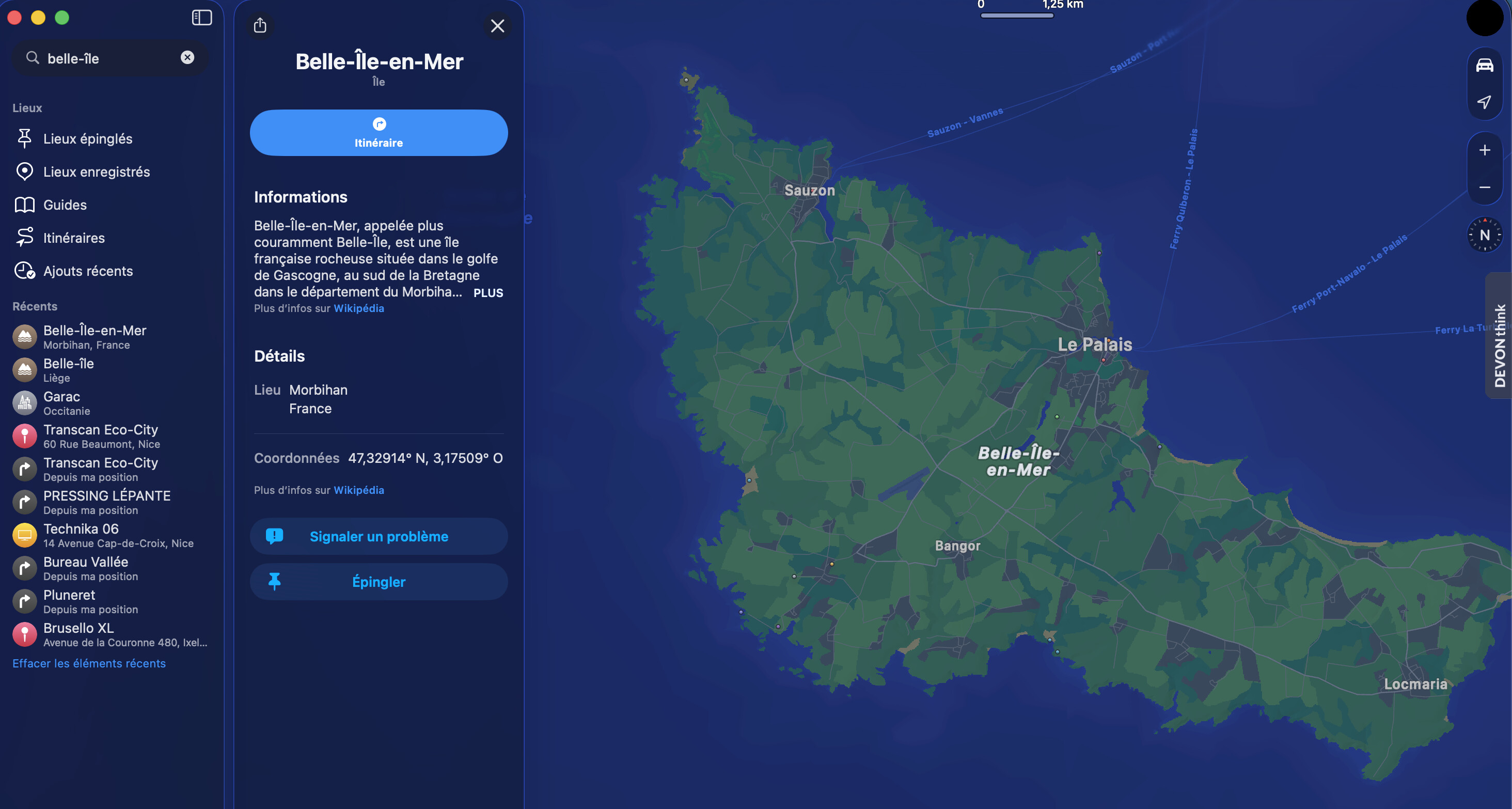

I confirm, Apple Plans also return the correct information when typing “Belle-île” : the island itself,
not ‘Lorient‘, far away on the continent, like DT does in my case. See how far is Lorient :
So do we agree that, in this regard, Apple Plans works as expected , but DEVONthink doesn’t ? Unless I missed a properties setting ?
