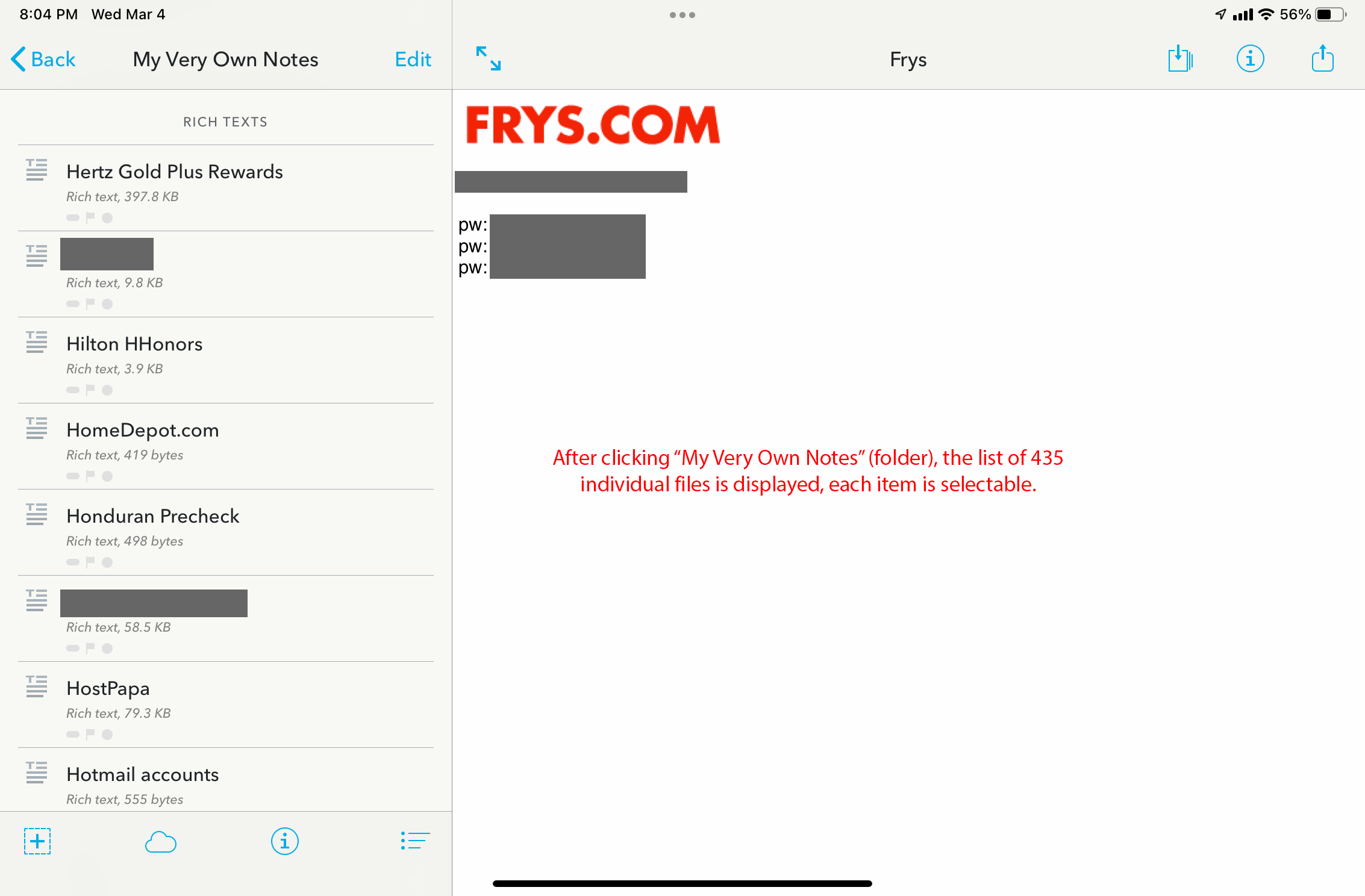

iPad Mini v6, running iOS 15.6.1 and DEVONthink To Go 2.7.1 (16337). I was able to sync this one (from the iPad) recently (a few weeks ago) by simply tapping the little “cloud” icon, but that’s no longer working. We can get to this later.

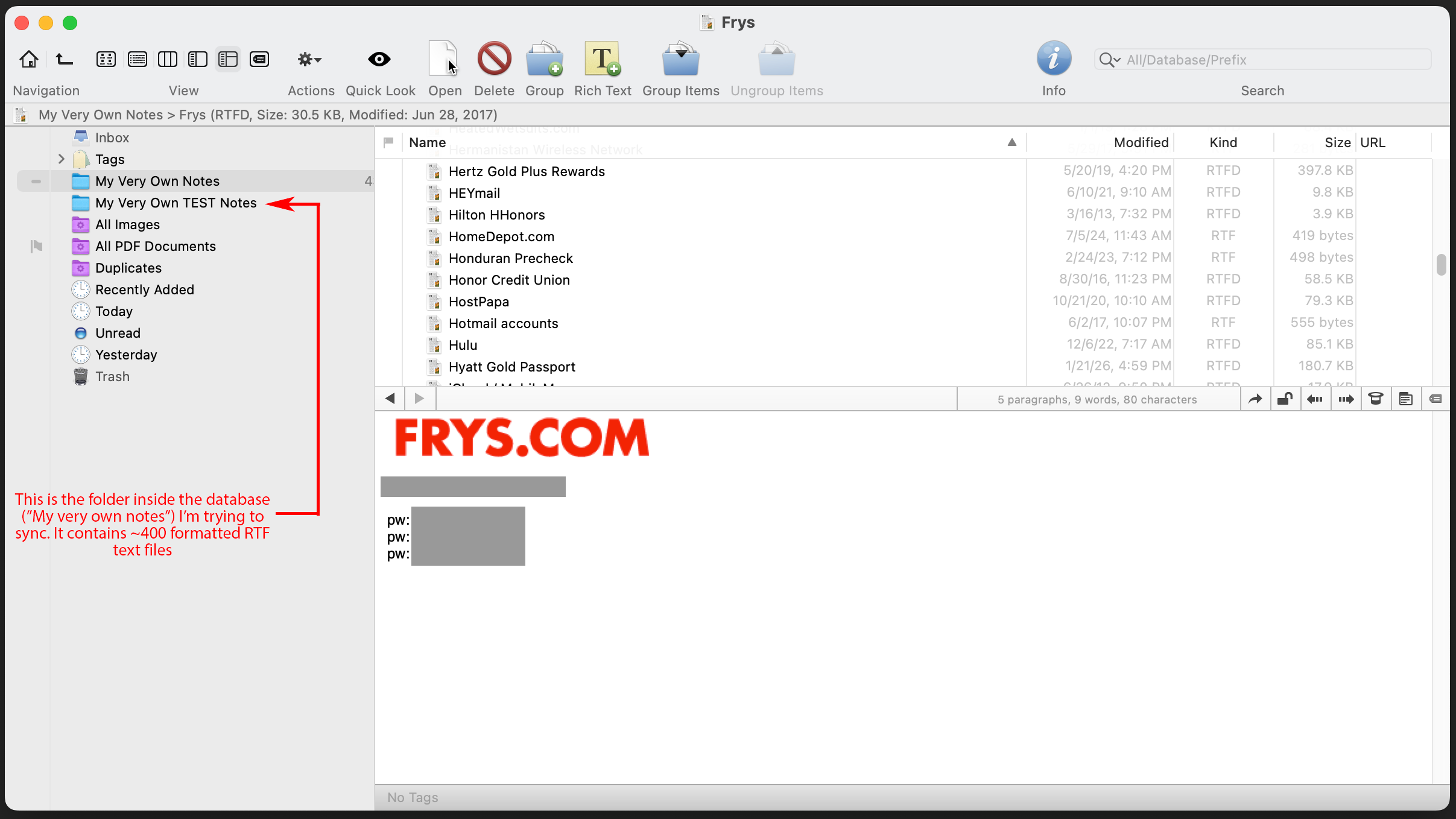

All I want to do is simply sync one database from my old desktop Mac to my new iPhone.

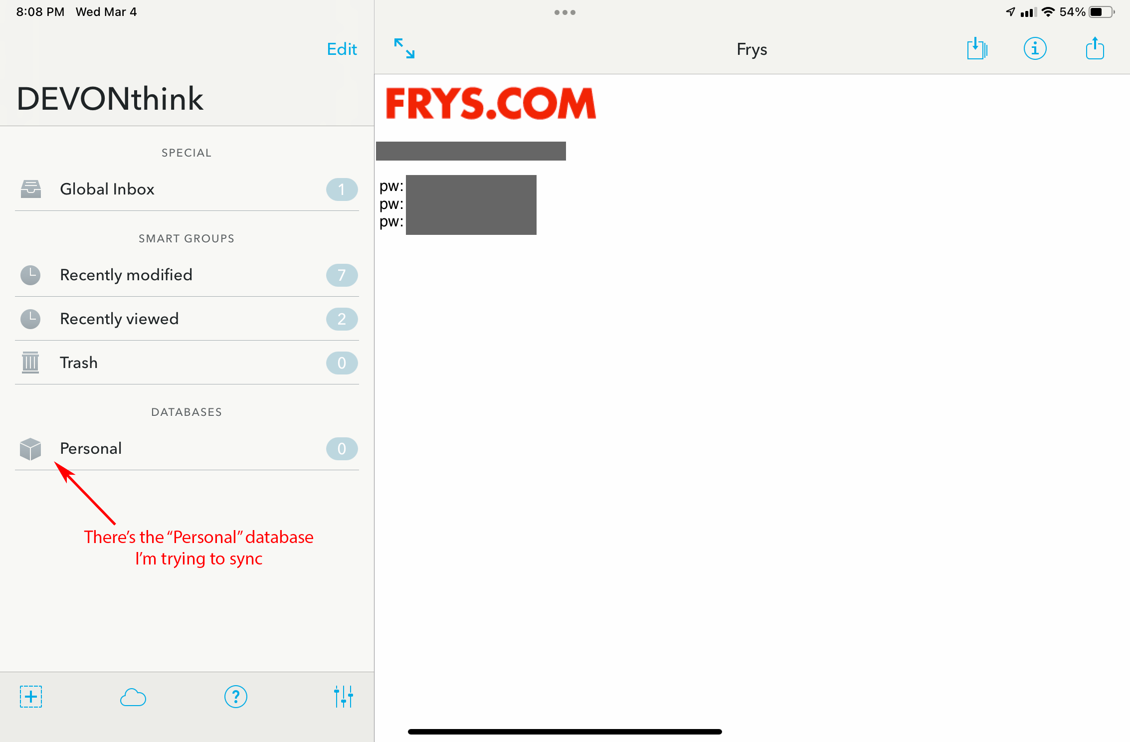

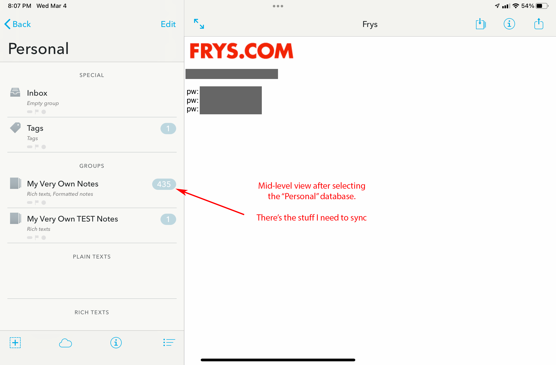

iPad Mini v6 Running iOS 15.6.1 and DEVONthink To Go 2.7.1 (16337). I am able to sync the database from the iMac now, by simply tapping the little “cloud” icon. This should also work on the phone but does not.

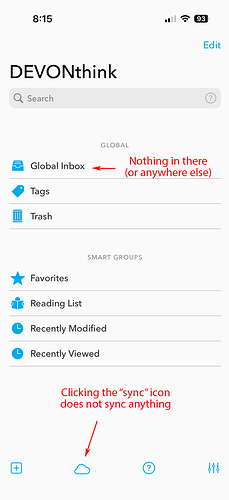

And now (sigh…) the new phone. An iPhone 17 Pro, running iOS 26.3.
I have installed DEVONthink 3.8.16 (and paid Apple for it, twice…).

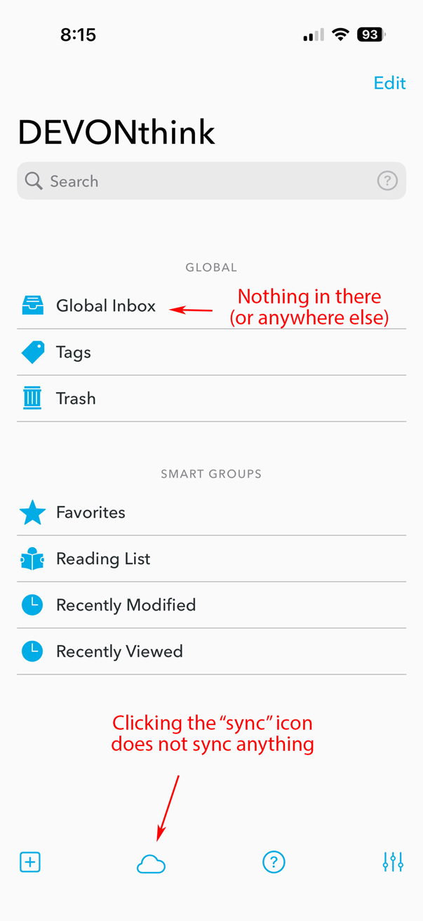

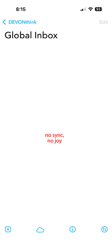

Here’s the problem (as I see it): I am unable to sync the database from the iMac to the iPhone. (I had been able to sync from the same iMac to my ancient iPhone but that finally died end of last year).
What’s happening (and what’s not):

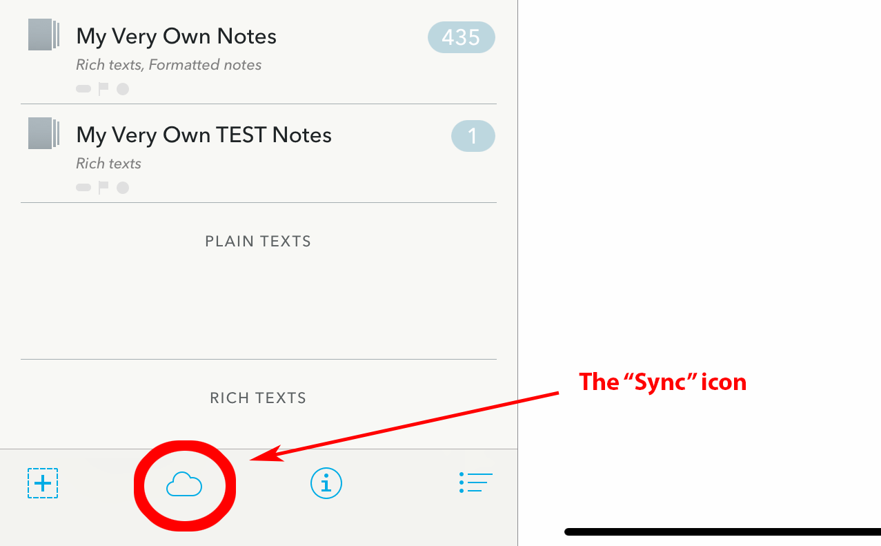

I am unable to sync my database to the phone. I sync easily from the iMac to the iPad (click the little “cloud” icon). When I try doing the same thing to the iPhone, nothing happens.
Please forgive me, I’m probably going to munge up some of the terminology here, I’ll try to be as clear as I can. It’s obvious that there’s a hierarchy of “containers” (or virtual containers)…in the app on both the iMac and the iPad, the left panel contains various types of containers: Special, Smart Groups, databases. For me, there’s a “container” (database) called “Personal” that I’m trying to sync. That database is visible on the iMac and on the iPad. It’s not there on the iPhone. There’s nothing in the app on the phone - it’s empty, and apparently disconnected from the database on the iMac.

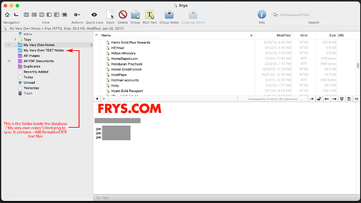

So I’m trying to figure out how to get that database from the iMac to the phone with no success (syncing fails, nothing happens).

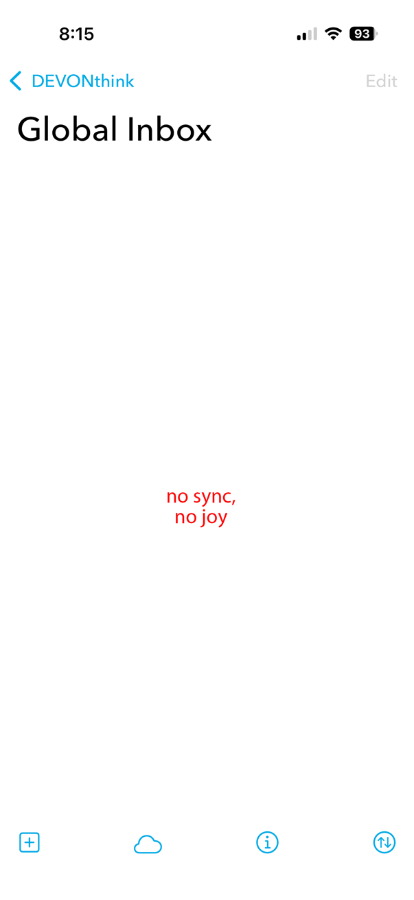

Here’s what I see:
So, my problem is: I have been unable to “get” the database to sync to the phone, and my first question:
Is this because of an incompatibility between the versions of DT I’m running?
Or have I just completely forgotten how to “connect” DT on the iPhone to DT on the iMac (it has been years since I first set this up…).

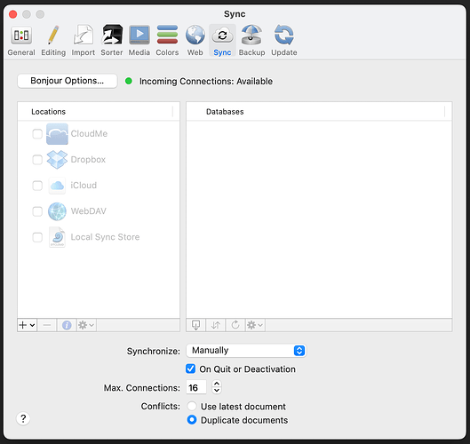

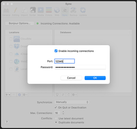

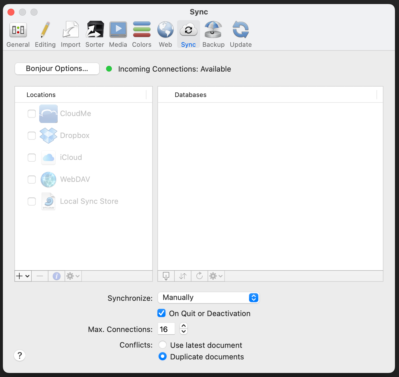

When the app is running on the desktop iMac and I click the Sync icon, I see a very brief animation of the icon, and a status message flashes saying “syncing from [account name] on [desktop computer name]” for an instant (that status message is from memory, and may not be exact, but is close). The status line is only displayed for a second or two, and is not always shown - which makes it hard to get the exact string.
In the iMac app, if I pull up “Preferences” the panel opens up, and on the Sync tab, it looks like this:
None of the “Locations” are checked (selected), but I note the “Bonjour Options…” button is enabled. When I click on it, I get the following “Enable incoming connections” dialog:
Note: that Port number that seems random to me (I don’t know if this is a number I entered manually or if it was chosen randomly/programmatically). The Port number in this dialog is not 12345, I just changed it to that before taking the screenshot, in case posting the port number in a public forum was a security risk; I’ve just changed it back to the seemingly random 5-digit number).
I note there’s also a 12-digit (obfuscated) password. In my notes (I typically record initial settings, though for this they are very short on details), I do have a recorded password that is 12 digits, so likely the one I entered. The port number looks random to me (probably is, I would ordinarily choose a number that I’d recognize…probably).
The other choices (besides Bonjour) are:

The sync method is defined in the preferences. At least for DT(TG) 3 and 4. I don’t know about DT2.
Why? Sync should be automatic, unless you turned that off (again, in the preferences). Which you shouldn’t do, imo.
Obviously, you’re syncing with Bonjour. And there’s a whole chapter on syncing with Bonjour in the manual. Did you read that? Probably not, because a lot of your questions/ramblings are answered there. I suggest that you do read it. There’s little point in repeating all that here again.
As to your password: That must be identical on all devices you want to sync. But if I understand the manual correctly, you can change it will anytime, as long as it’s identical everywhere.
No need to guess here: Bonjour is active, and it is the only sync method that is. So, if your sync works (at least partially), it must be via Bonjour.
All that’s explained in the manual – in DT as well as in DTTG, which also comes with an extensive help. Also, there are numerous posts here in the forum explaining Bonjour sync, and I seem to remember blog posting(s) about the same issue.
Briefly: On your mobile device, you must set the sync method to Bonjour, you must not enable incoming connections, you should leave the port empty (on all devices), and set the same password (on all devices).

Yes. Bonjour is a direct device-to-device connection requiring both applications to be on and running DEVONthink or DEVONthink To Go.
This is actually covered in the Help for DEVONthink 4, but here is my previous discussion on the topic: Bonjour Simplified

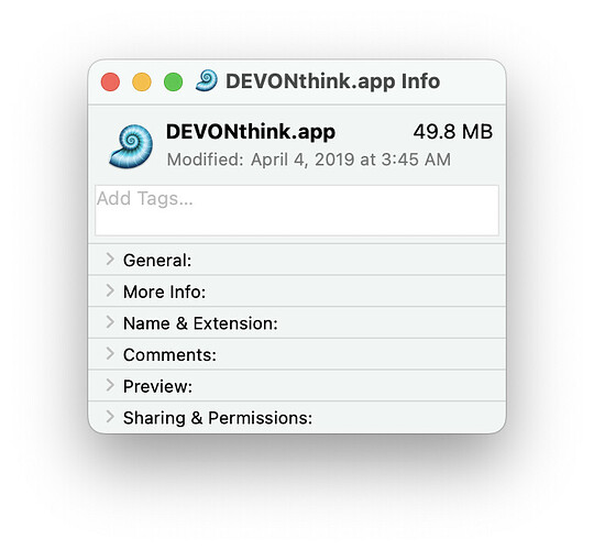

Not surprisingly, it launches, seems to run OK, but of course it’s “empty” - it doesn’t recognize any existing database, which I guess is expected, but not a very useful condition when trying to troubleshoot syncing.
DEVONthink 2 and 3 are separate applications with separate preferences so no, version 3 isn’t going to open the same databases on launch. However, it does automatically migrate the Global Inbox and some other resources, provided you didn’t run an uninstaller application.

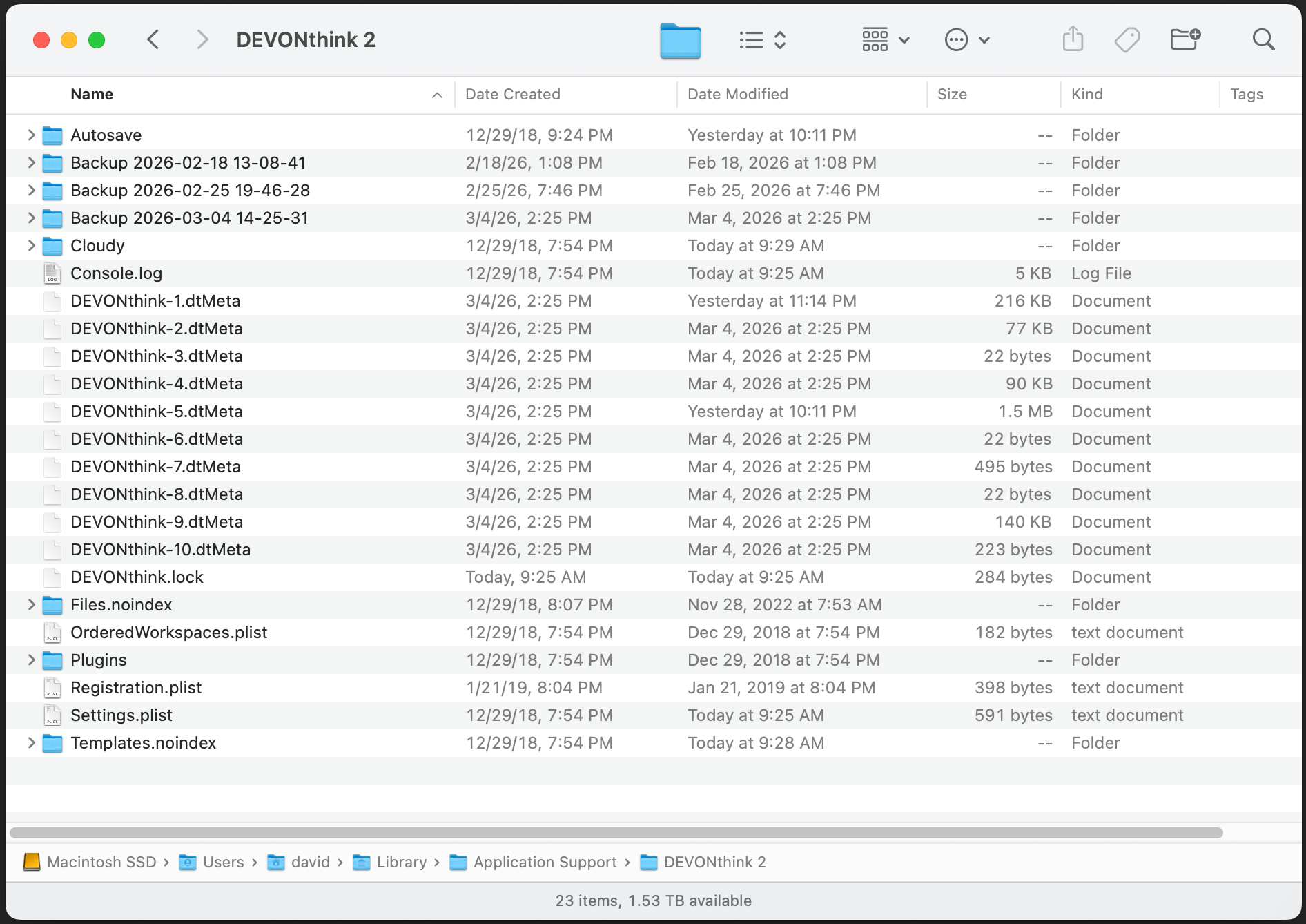

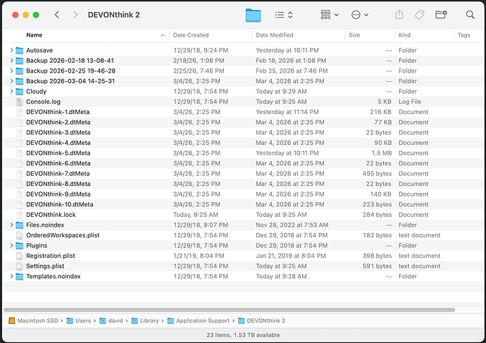

With the exception of the Global Inbox, your databases are located where you created them.
I have no recollection of that location (long ago), and in my “notes” for DT I see no mention of that. Hmm. Searching for “dtbase2” I find no files containing that string (only five instances of the text string “dtBase2” in the downloaded DEVONthink 3 Manual.pdf). I assume the file name is not case-sensitive, and is not “hidden” or otherwise obfuscated (correct?).

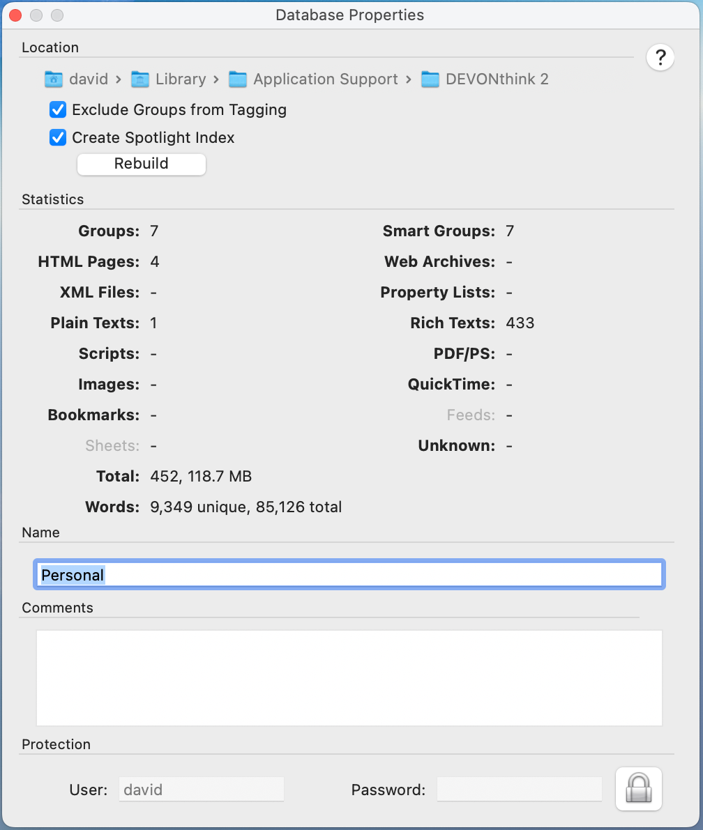

So, where has my database gone? It’s still functioning (readable, editable) in DT2.
Is the name of the database user-editable? When it’s first created, is the user prompted to name the file and choose a location - or is it hard-coded to be named “dtBase2” and written to a default location? If so, what’s the default path? It’s possible I gave it a unique name, but typically would save it to the default location (assuming I had those options).
I assume it is a single, discreet, visible/non-hidden/discoverable and user-selectable file? In any case, I’m not seeing it (at least not via a Finder search).
Let me ask this: I am assuming that as I migrate from DT 2 to DT 3, I want to simply “point” DT 3 at my existing DT 2 database, and that would migrate all the database’s content (items) to DT 3. Once opened/migrated in DT 3, the database would effectively be copied (or pointers to the actual content would be copied)…I’m assuming the database is effectively a “container” of sorts (and it’s contents are discreet and perhaps elsewhere), so that (the database) is what I’m aiming for. Is that a valid assumption?
There is no migration or conversion or anything different regarding how to open and access a database.

When running DEVONthink Version 2 and that database “readable and editable”, use Menu: File → Database Properties and look at the location (top of screen, probably–I don’t have DEVONthink Version 2 to confirm).
As far as i know, there is no default location. I personally recommend ~/Documents/DEVONthink/ for all your databases. The name you decide. The file extension is defined by DEVONthink. It’s a macOS “package” not a folder or file. Read about “packages” on Apple macOS documentation if interested.
I recommend that once you find all your databases scattered around, apparently, move them all into one folder.

No. It’s a macOS “package”.

So, looking for my database: in DT2, under Database Properties, I see the apparent path (Library > Application Support > DEVONthink 2) and the “Name” field. It seems I named it “Personal”. That should make the task simple…
That’s definitely the item I’m seeking, the statistics confirm it contains 433 Rich Texts (and a few other things). That’s the one. So far, so good. But…
So in the Finder I drill down through Library > Application Support > DEVONthink 2, but I do not see anything named “Personal” in that folder:
Doing a search, it turns up a handful of items whose name containing the string “Personal”, including something that for me is a blast from the past (which will prompt a perhaps odd question).
I see a file named “Personal.sohodb
Its name suggests it’s a database file, and “soho” brings back dim memories of an app I once used before migrating to DEVONthink. Creation and modification dates are from 2010. It’s location is in a folder unironically named “Sure wish I had saved that stuff”.
Now the odd question: In the early history of the DEVONthink products, did the app/company ever use a different name? Or did the app come to life from Day One as “DEVON-something”? I ask because before landing on this as a solution, I tried out a handful of “note management” apps including SOHO Notes, Chronos Notes, Yojimbo, and probably a few others. If I started using the app and created its database and then the app itself was subsequently re-named, the file “Personal.sohodb” could have been how it began (though I note with disappointment that the “modification date” timestamp is also 2010, and I know some items in the database were modified as recently as yesterday…but maybe changes to the items within the database don’t change the database’s modification date? Hmmm).
In any case, I’ve run searches for objects whose filename contains “Personal” and do not find any likely hits (plenty of documents containing the text string “personal” but just a few with that in the name, and none of them are it).
So, I’m still looking for my wayward database (but at least know I’m pretty sure I know it’s “name”).

That is the Application Support directory for the Personal edition of DEVONthink 2 (not something you named “Personal”).
  1. Quit DEVONthink 2 (which you also need to remove from the machine).
  2. Drag that DEVONthink 2 folder to the Databases folder in your home directory.
  3. Add .dtBase2 to the end of the folder’s name, okaying the addition.
  4. Launch DEVONthink 4 and open the database via File > Open Database.
  5. Go into the /Applications folder and move the DEVONthink 3 and the old DEVONthink application to the system Trash and reboot the machine. This is the icon from DEVONthink (2 Personal)
