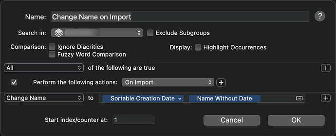

It took A LOT of digging to finally figure it out. The answer was simpler than I realized.
I have a more extensive set of file naming rules; also tag assignment
My solution is an Applescript, triggered by the import smart rule

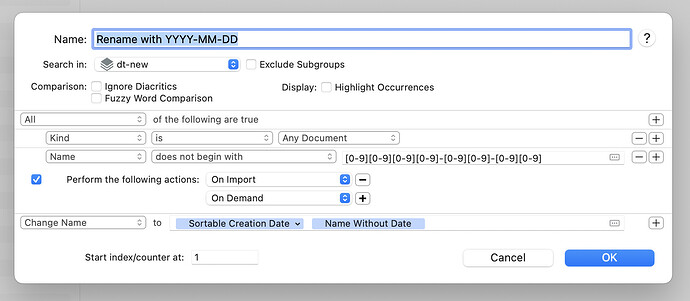

You should not have criteria-less smart rules. At a minimum, Kind is Any Document is advisable. You should strive to be as specific as possible with automations.
Basically, if a filename starts with the date pattern “YYYY-MM-DD FILENAME”, I want to import it with the name intact.
This doesn’t need to be considered as the only function of the rule is to change the name when it doesn’t match. File with names beginning with four numbers-two number-two numbers will not be matched and import as-is.
If the filename does not start with the date pattern “YYYY-MM-DD” I want to rename the file to using the creation date to place the date at the front of the filename. “YYYY-MM-DD FILENAME”.

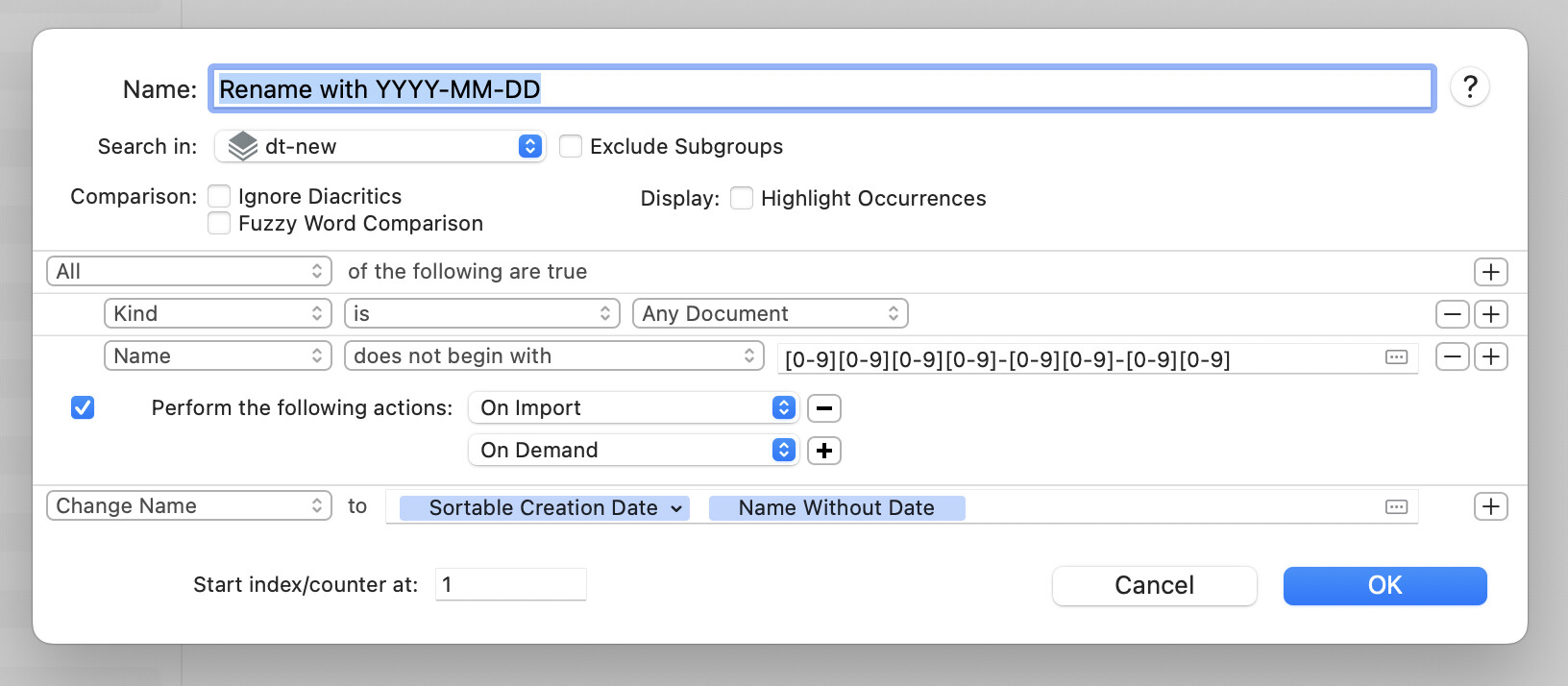

FYI. If I run it on demand, it changes an existing filename that already has a YYYY-MM-DD set. The match is not working?
It did what you told it to do… on demand.
But if the rule states not to process a file if it starts with a sortable date, why do all my files with sortable dates show up when the rule is highlighted? It doesn’t make sense. Shouldn’t it only select file names that don’t start with a sortable date? What am I missing here? I was a DBA and I’m confused. LOL
I’m not looking at your computer so I can’t see what you’re talking about.
Screen captures or a screencast would be helpful. If you don’t want to share it publicly, open a support ticket and attach them.
Done. Thank you, Jim.
Problem solved. Needed to negate the pattern with a “!” in front.
e.g. name matches ![0-9][0-9][0-9][0-9]-[0-9][0-9]-[0-9][0-9]
Indeed and it’s a matches not a begins with that supports wildcards and operators, e.g., [0-9]. That was my incorrect reply earlier.
