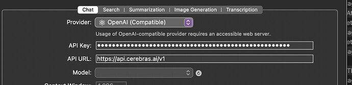

I am attempting to configure an OpenAI compatible endpoint but I am unable to enter the model name manually.
I understand from a prior post that DT4 needs to retreive the model list in order to determine model capability and that you look at a /v1/models endpoint.
In the case of cerebras.ai there is indeed a /v1/models endpoint but it requires authentication via the API key:
https://api.cerebras.ai/v1/models
Alternatively there is a public models endpoint that requires no authentication:
https://api.cerebras.ai/public/v1/models
Is it possible to support one of these /models endpoints? Or alternatively let the user configure the tools and other metadata at his own risk?

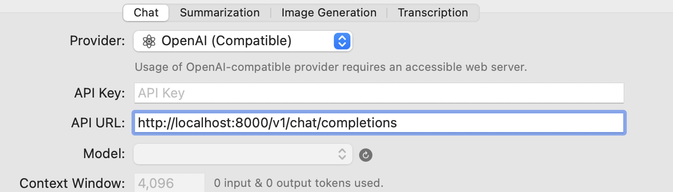

As mentioned many times, we can’t add support for every AI provider and aggregator that pops up online. People need to investigate if there’s an OpenAI compatible endpoint and what the correct URL is. You should be looking for chat completion endpoints. In this case, the actual endpoint appears to be https://api.cerebras.ai/public/v1/chat/completions but we logically can’t say what kind of access that really allows.
Hi @BLUEFROG
The endpoint In the image is indeed the working endpoint - I have it working in another app:
The issue as I understand it from the prior forum post is that DT4 looks for a “V1/models” endpoint to get metadata about the model. For Cerebras that endpoint is instead “/public/V1/models”
I totally understand you cannot support every model; that is why I suggested you could simply leave it to the user to configure the tools and other metadata if DT4 does not find the models endpoint.

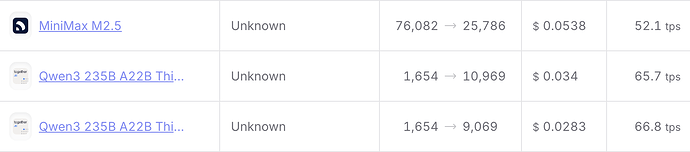

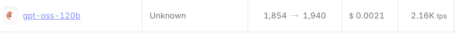

Typical performance I get in Devonthink on OpenRouter for most models is at best 50-60 tokens per second:

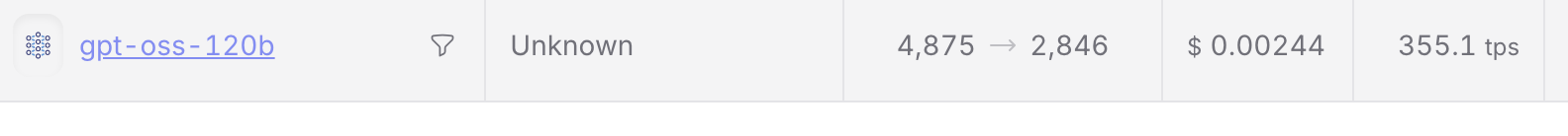

Typical performance I get in Devonthink on OpenRouter for gpt-oss-120b when OpenRouter is configured for best throughput is 300 tokens per second:
Now that alone is frankly stunning - and it is really impressive when using Chat in Devonthink. This is an inexpensive model which yields a response about 5-6 times faster than typical models. Impressive.
But Devonthink does not let you specify a particular Openrouter provider other than generically “best throughput”. When I use my own app and either specify the Openrouter provider or directly access the Cerebrex API this is what I get:
So that is an increase from 60 tokens per second for typical Devonthink models to over 2100 tokens per second. 35 times faster - real world. Cost $0.35/M input, $0.75/M output. They advertise a theoretical 3000 tokens/second maximum - I am getting 2100 tokens per second real-world. In my custom app I am conversing with a 1,000 page PDF Chatbox and getting back sophisticated answers faster than I can read them.

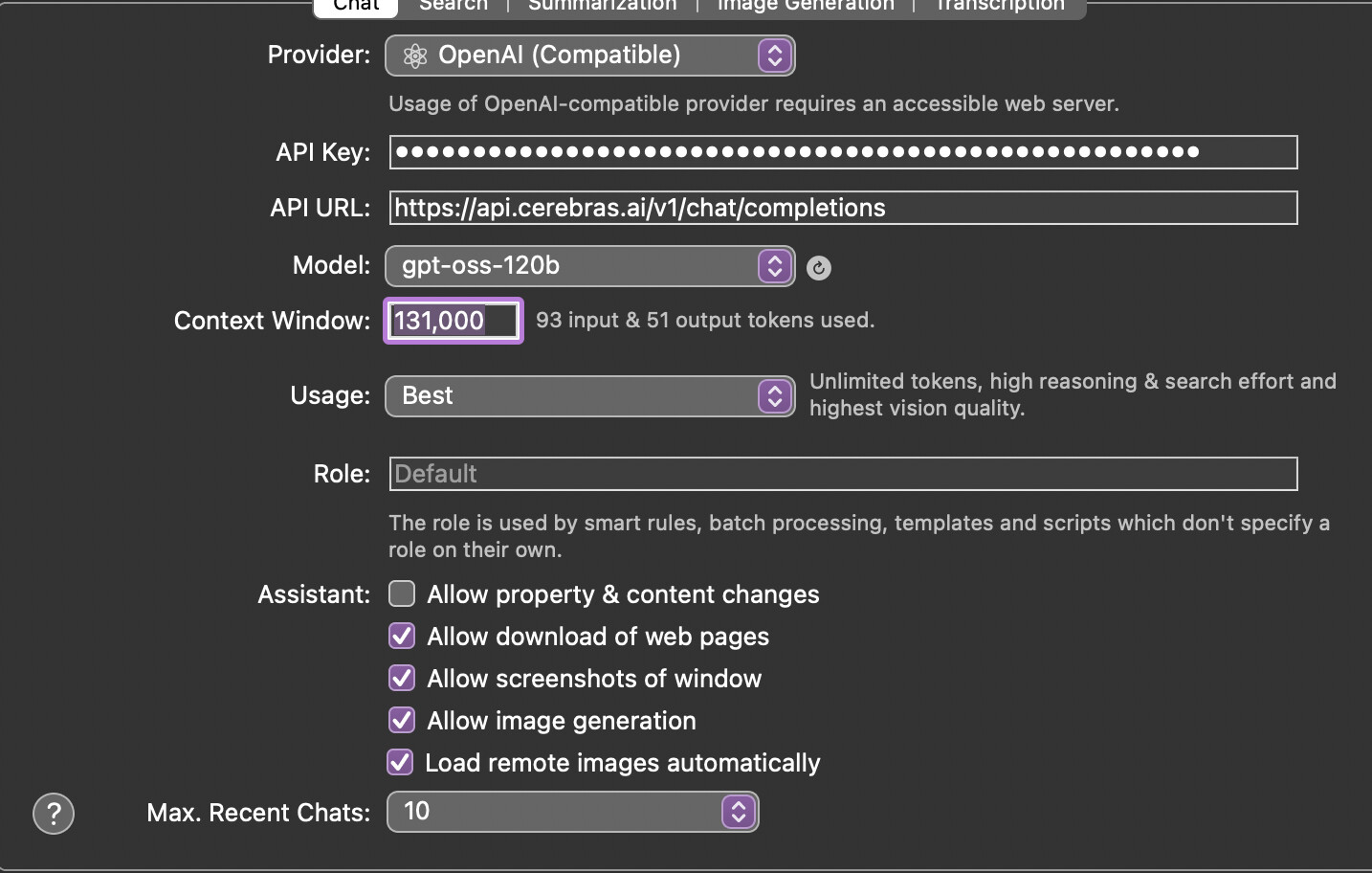

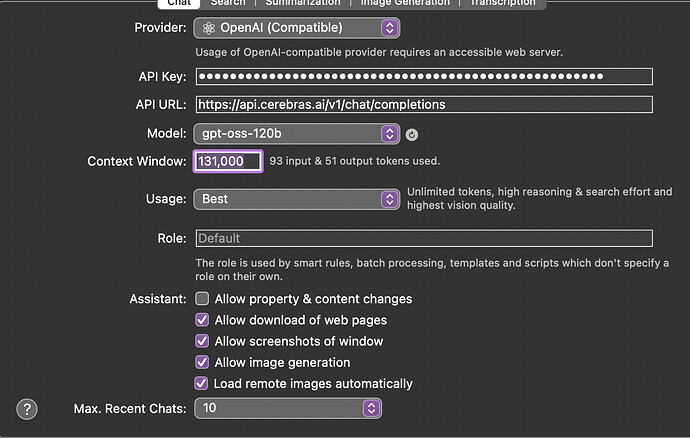

DEVONthink expects the completions endpoint, not the APIs base URL.
OK - simple solution :slight_smile:. [@BLUEFROG was initially correct - I should have tried that earlier. Thank you both.]
Performance is beyond stunning - at minimal cost. Definitely something I would recommend other users try.
For documents within the 131K context window response is instant using DT4.
