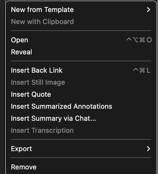

One thing I missed (for years!) about Annotation files is how to really use them as documents. That little window in the Annotations tab in the Inspector’s “i” panel is not much real estate to edit in.
The Annotations drop-down menu, the same one that lets you add a new Annotation file, has an “open” command.

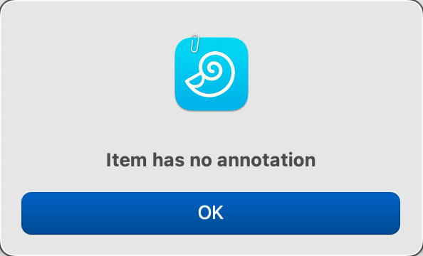

Exactly. And to make it even faster, you can use this script that someone kindly posted here. I don’t remember who it was, but thank you again to that person :slightly_smiling_face:
-- Open annotation file of selected item
--- without having to open the Annotations & Reminders inspector
	set theRecord to (selected record 1)
	try
		set theAnnotation to annotation of theRecord
		open tab for record theAnnotation
		if the error_number is -2753 then
			display alert "Item has no annotation"
		else if the error_number is not -128 then
			display alert "DEVONthink" message error_message as warning
	end try

I’m pretty sure I wrote that, glad it’s useful :slight_smile:
(But it was some time ago… I’m not sure about that error handling, doesn’t feel like the most elegant way to go about it.)
Ah, so that’s your script. :+1:
Elegant or not, it works perfectly and even provides a hint if a file has no annotation. What more could you want?

Somewhat related question that I cannot find in the Help.
How do I use the “Insert Still Image” feature? Why is it grayed out?
This requires a video, other document types aren’t supported.
