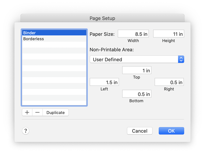

DEVONthink doesn’t control the margins. This is controlled by the settings in File > Page Setup.
You can define your own custom page sizes with their own margins. For example…

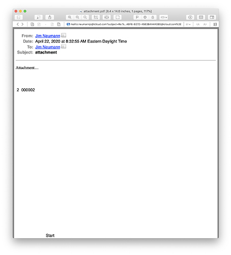

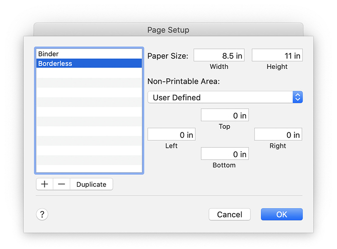

And a PDF with the Borderless setting…

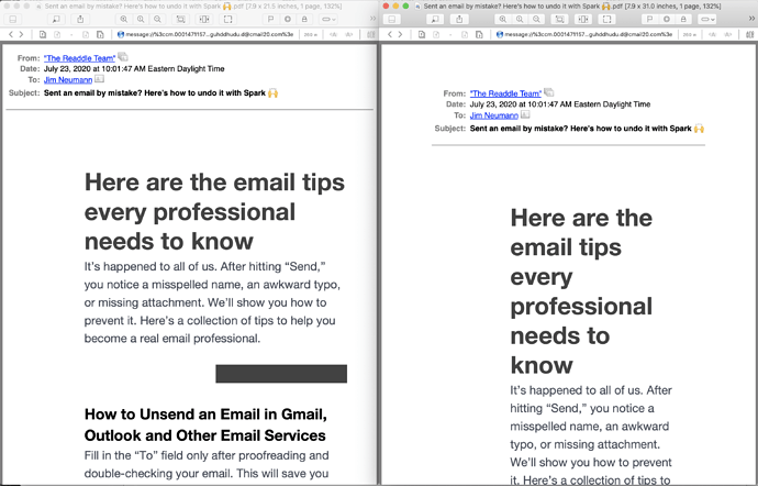

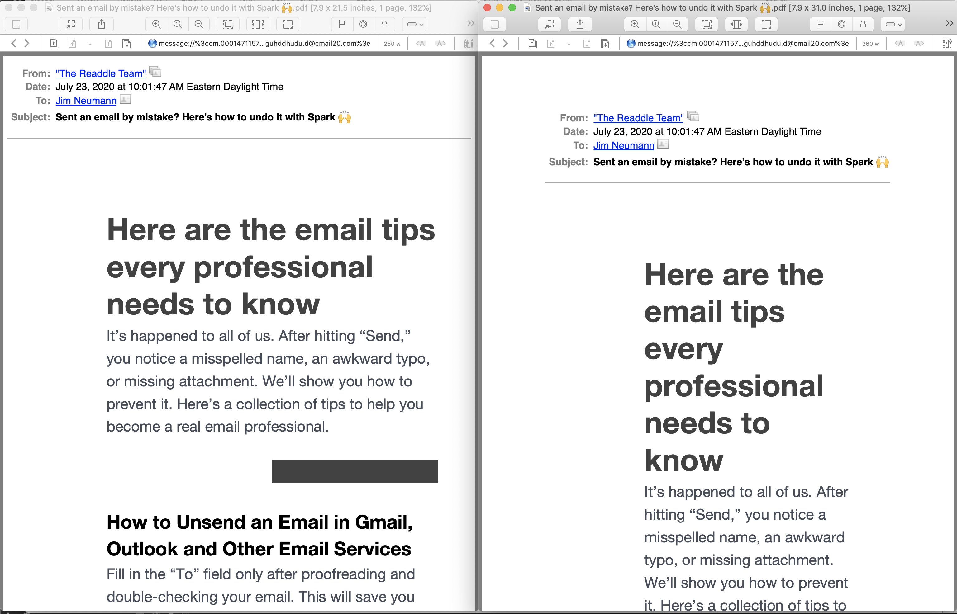

These PDFs were made with two different Page Setups…
Perhaps I am not explaining myself properly.
If I convert an email to PDF using Data/Convert/to PDF (or as I usually do, right click to bring up the pop up), regardless of the settings in Page Set up, always end up with a PDF which fills the page, except for what I presume are the default margins.
If I print to PDF using the DT print and page set up to User Defined, then I get a PDF as I want it. However, I am unable to batch process several emails (as far as I can tell) to print to PDF in the reduced page layout.
Examples of your email replay attached by way of example.[DEVONtechnologies Community] [DEVONthink] Convert email to PDF - page margins.pdf (70.9 KB) [DEVONtechnologies Community] [DEVONthink] Convert email to PDF - page margins.pdf (73.9 KB)
