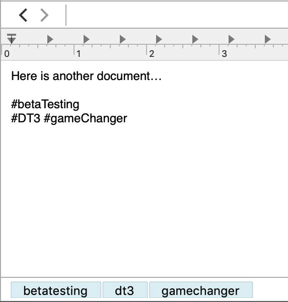

This is a plain text file I created in TextEdit and saved into DEVONthink 3…
And an RTF…
In fact, the only oddity I see here is the case wasn’t preserved.

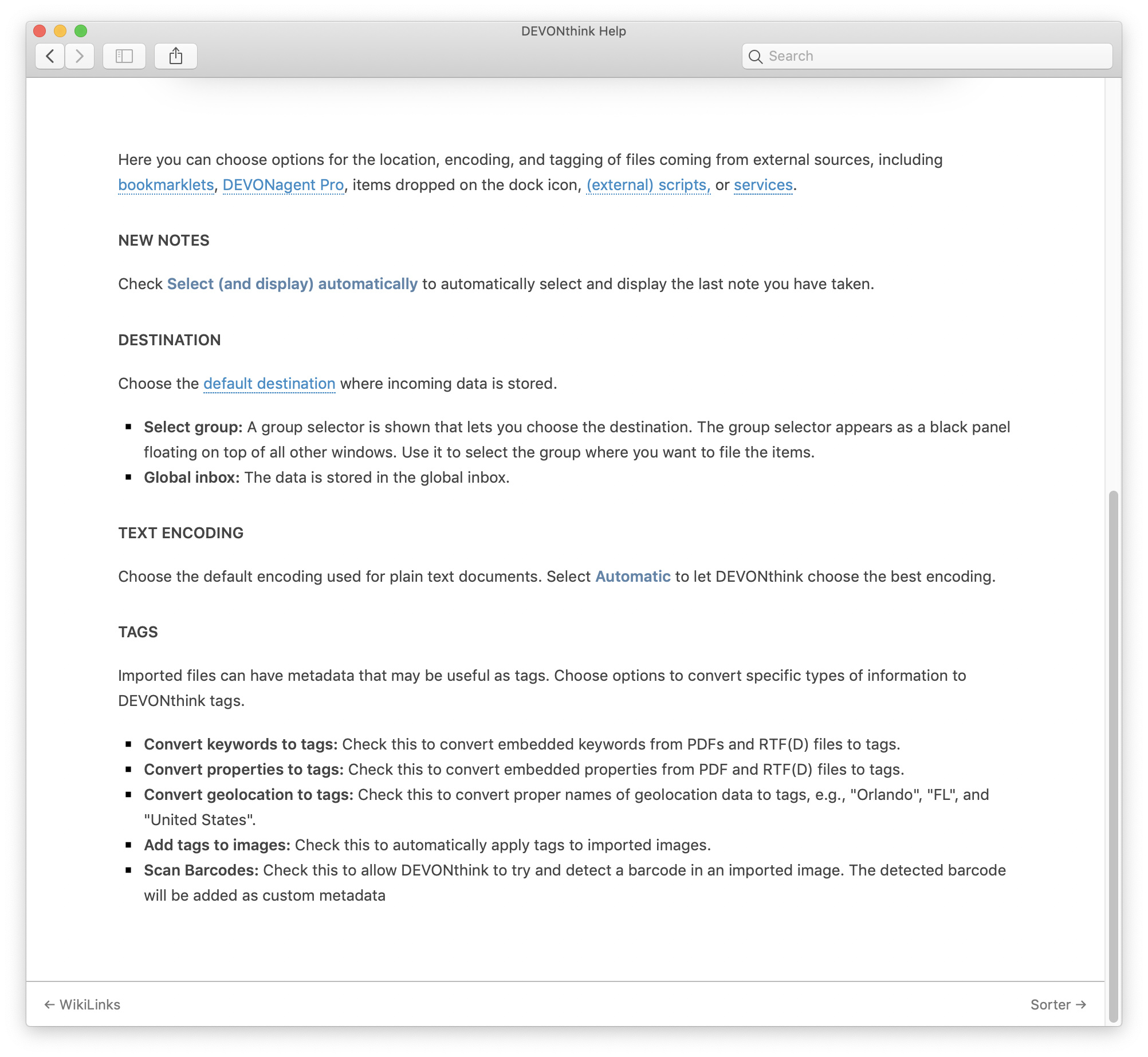

But thanks for the screencap! The import option needs to be added to the documentation.
